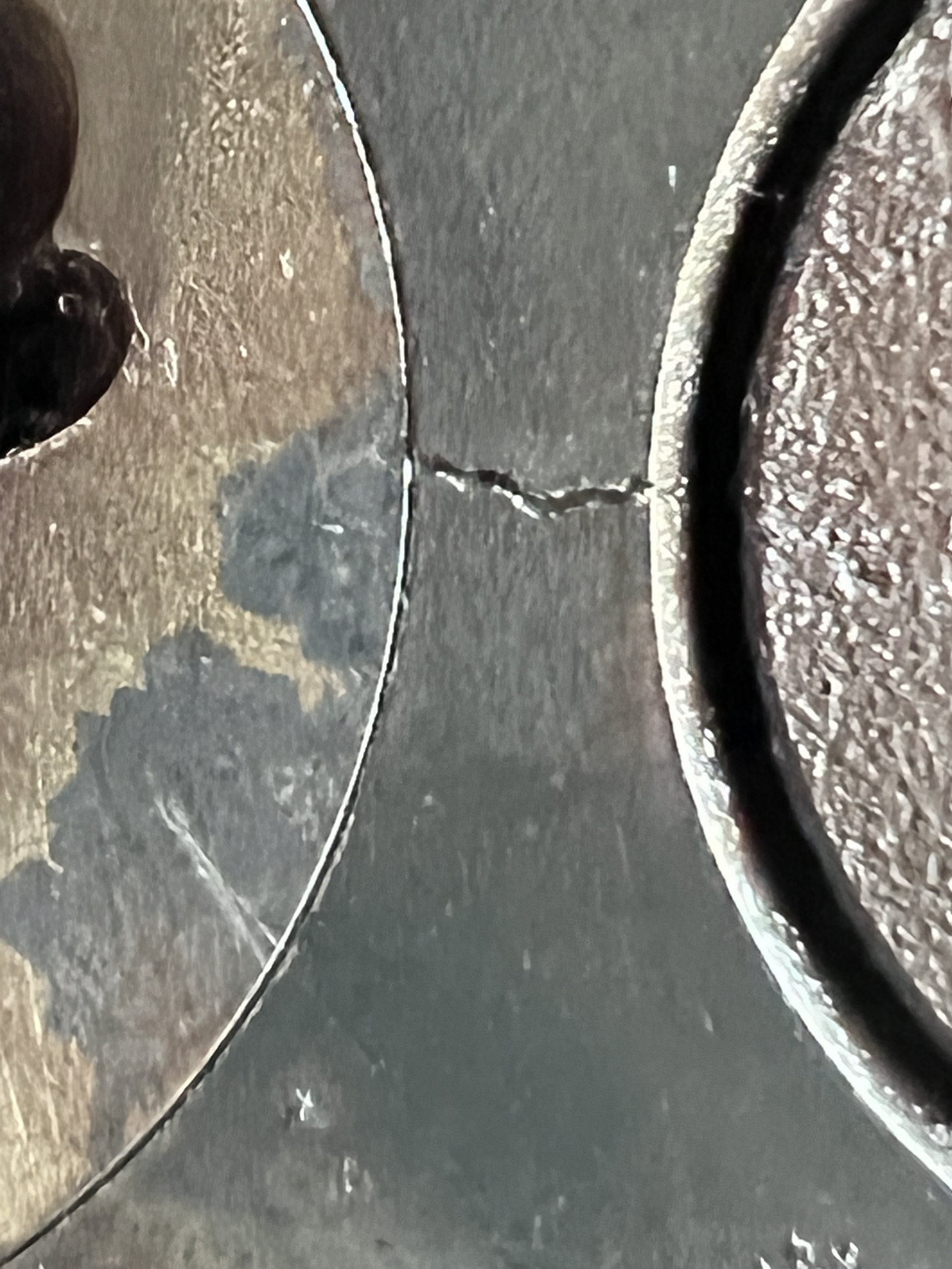

Update: found two cracks in the cylinder head when I started cleaning it.

Lets get back to mechanicals. I was disappointed to hear about the cracks. Was hoping that a leaky head would just be the typical flame ring erosion that could be removed by surfacing
It used to be that some cracks could be fixed....sometimes. The worst crack to fix - and one of the most common in gas engines - was a crack from the spark plug hole to the exhaust valve seat area.
In a diesel I guess that would be from the injector hole to the exhaust valve area.
So where did it crack? What's the verdict there? & the cause?

Two of the three have tiny cracks in the exact same spot.
No idea of the cause. I had been having overheating problems in the summer which kept getting worse. Tried everything that was suggested by my Kubota dealer - cleaning radiator fins, changing to synthetic oils, removing thermostat. Each would improve it temporarily but not solve anything.
Eventually found some symptoms that suggested head gasket - oily film in the coolant, and some bubbles visible when running with the radiator cap off.
I think there is something else wrong too, when I tried to put into the garage at the beginning of winter all the coolant drained into the oil pan in a few minutes.
I’m not sure what to do now - if I should replace the head, or try to find a complete used engine, or some other option.
