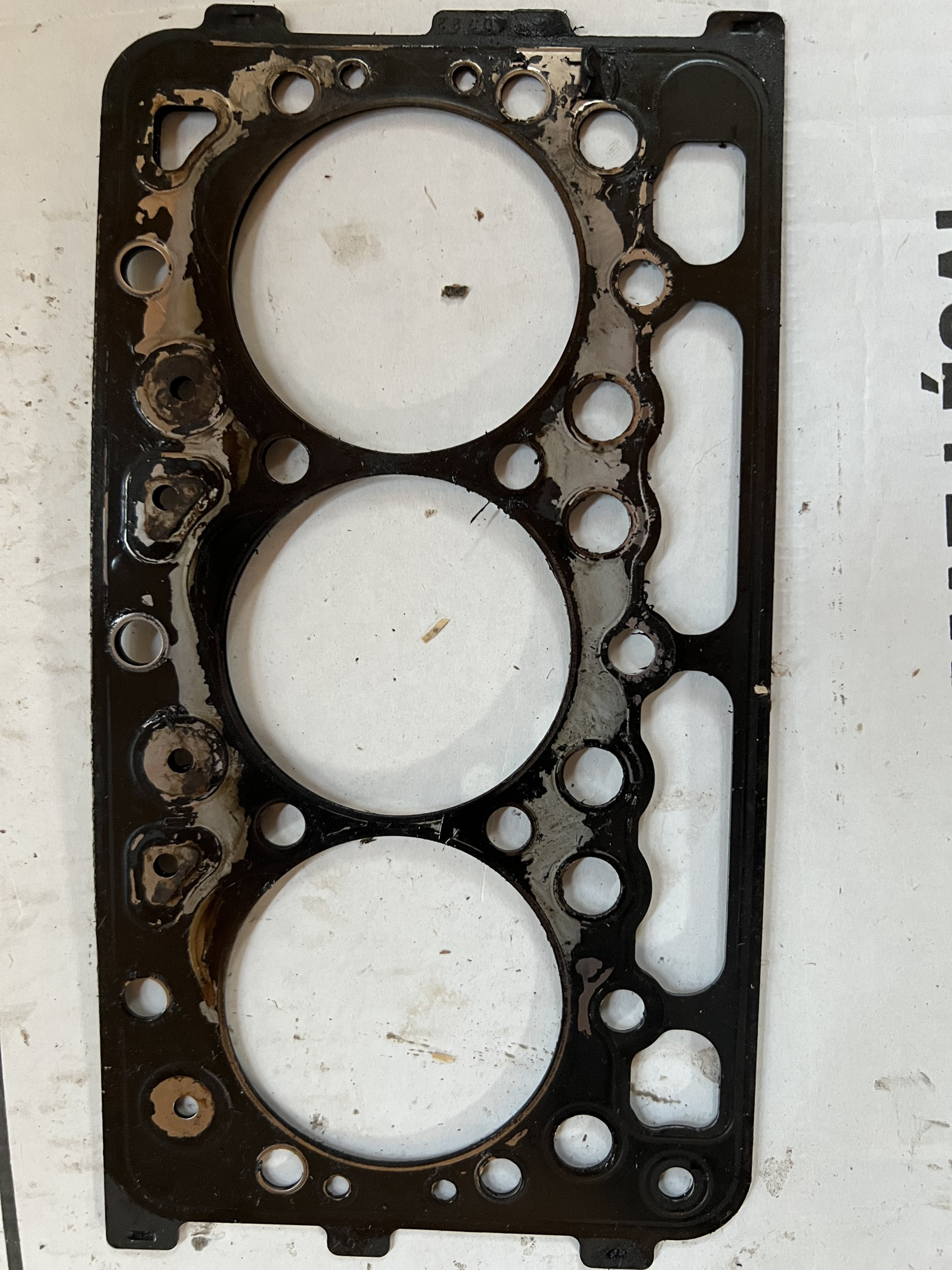

Hi,
I have a large coolant leak in my BX1860 - in just a few minutes of running, all the coolant went into the crankcase. It didn't really mix with oil, the oil was floating on top. So when I drained the crankcase, first the coolant came out and then the oil.
I took of the valve cover and both of the freeze plugs in there look ok. Before doing anything else I want to pressurize the water system to see if there is anything obviously leaking. Does anyone know how to do this?

HF sells a good one to pressure test the cooling system pretty cheap. Sounds to me like a failed head gasket actually. The freeze plugs are on the side of the block, not under the valve cover. Sure you know what you are talking about?

Hey ORD, 5030 is right. I'd say it is essentially certain you have a blown head gasket. I think you will have to resolve the blown head gasket as higher priority and the water in the oil will get cleared as a side issue.

I have removed the head gasket, I’ll get a replacement and see if that solves everything. Thanks for your help.

You need to check the head for flatness with a metal straight edge and feeler gages as well as the deck of the block. If either is warped beyond the limit listed in the WSM, they need to be machined. If you don't the new gasket will fail.
/ BX1860 pressure test coolant #9
Did the engine produce white smoke/steam while running? If not I'd be concerned that it is something else besides the head gasket. If the water pump is mounted on the front of the engine it may be the source of your water intrusion.

Update: found two cracks in the cylinder head when I started cleaning it.

Lets get back to mechanicals. I was disappointed to hear about the cracks. Was hoping that a leaky head would just be the typical flame ring erosion that could be removed by surfacing
It used to be that some cracks could be fixed....sometimes. The worst crack to fix - and one of the most common in gas engines - was a crack from the spark plug hole to the exhaust valve seat area.
In a diesel I guess that would be from the injector hole to the exhaust valve area.
So where did it crack? What's the verdict there? & the cause?

Two of the three have tiny cracks in the exact same spot.
No idea of the cause. I had been having overheating problems in the summer which kept getting worse. Tried everything that was suggested by my Kubota dealer - cleaning radiator fins, changing to synthetic oils, removing thermostat. Each would improve it temporarily but not solve anything.
Eventually found some symptoms that suggested head gasket - oily film in the coolant, and some bubbles visible when running with the radiator cap off.
I think there is something else wrong too, when I tried to put into the garage at the beginning of winter all the coolant drained into the oil pan in a few minutes.
I’m not sure what to do now - if I should replace the head, or try to find a complete used engine, or some other option.
