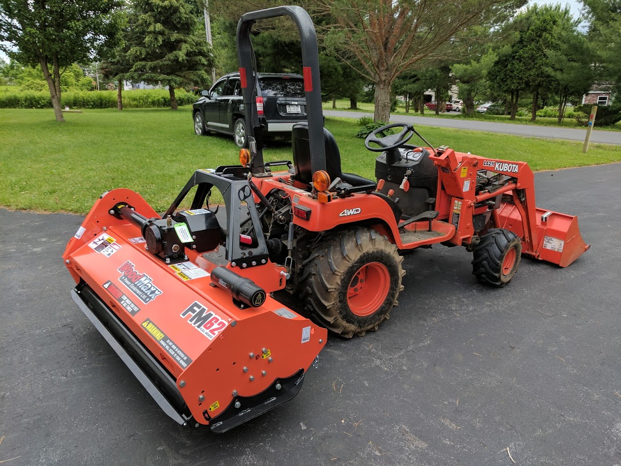

   / BX weight lifting test #20
Just in case anyone is wondering... yes a BX will lift a 62" flail mower and it works it just fine. Weighs about 700#.
I use it for mowing my lawn when I feel like switching it up from a rotary.
