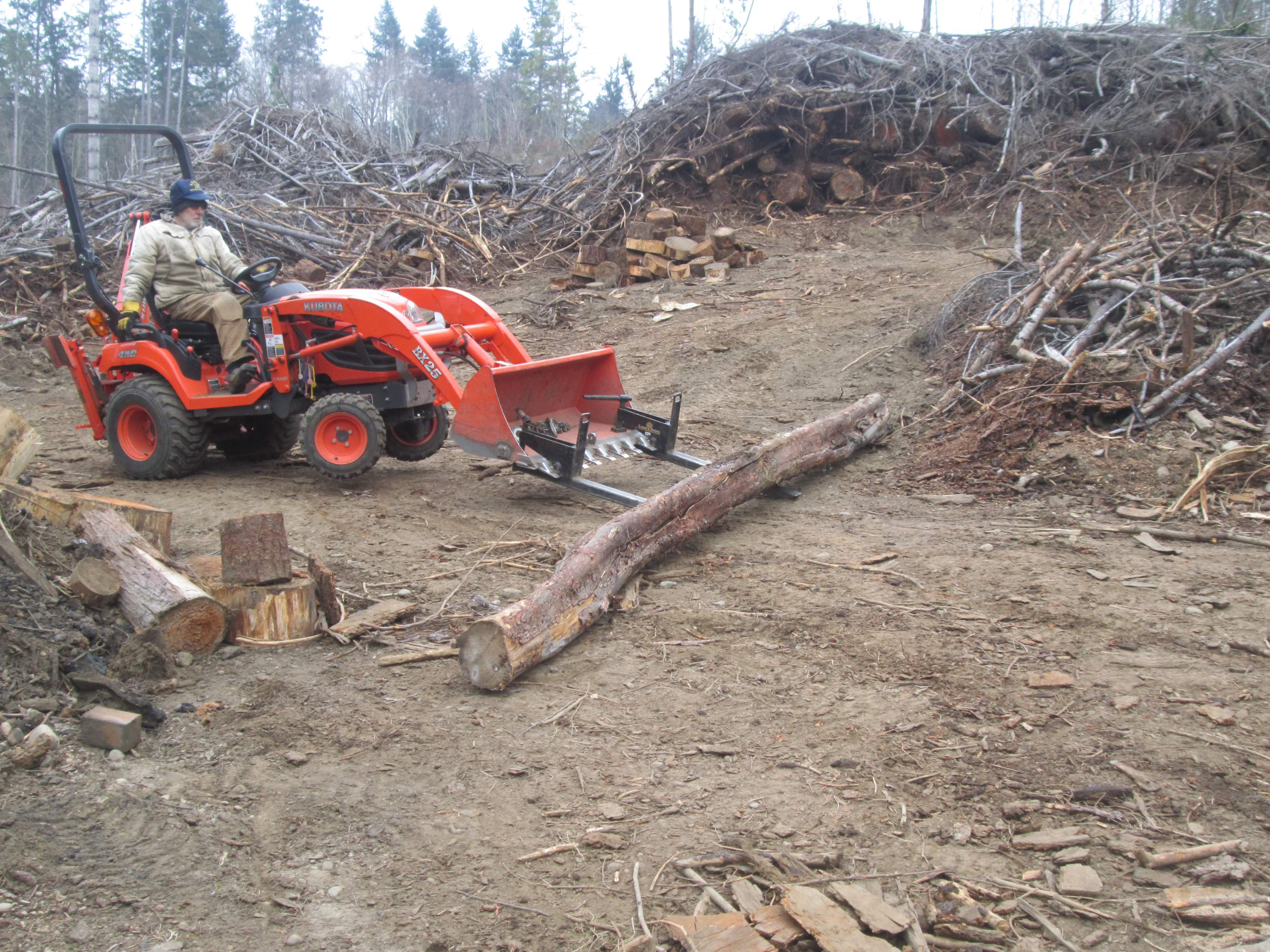

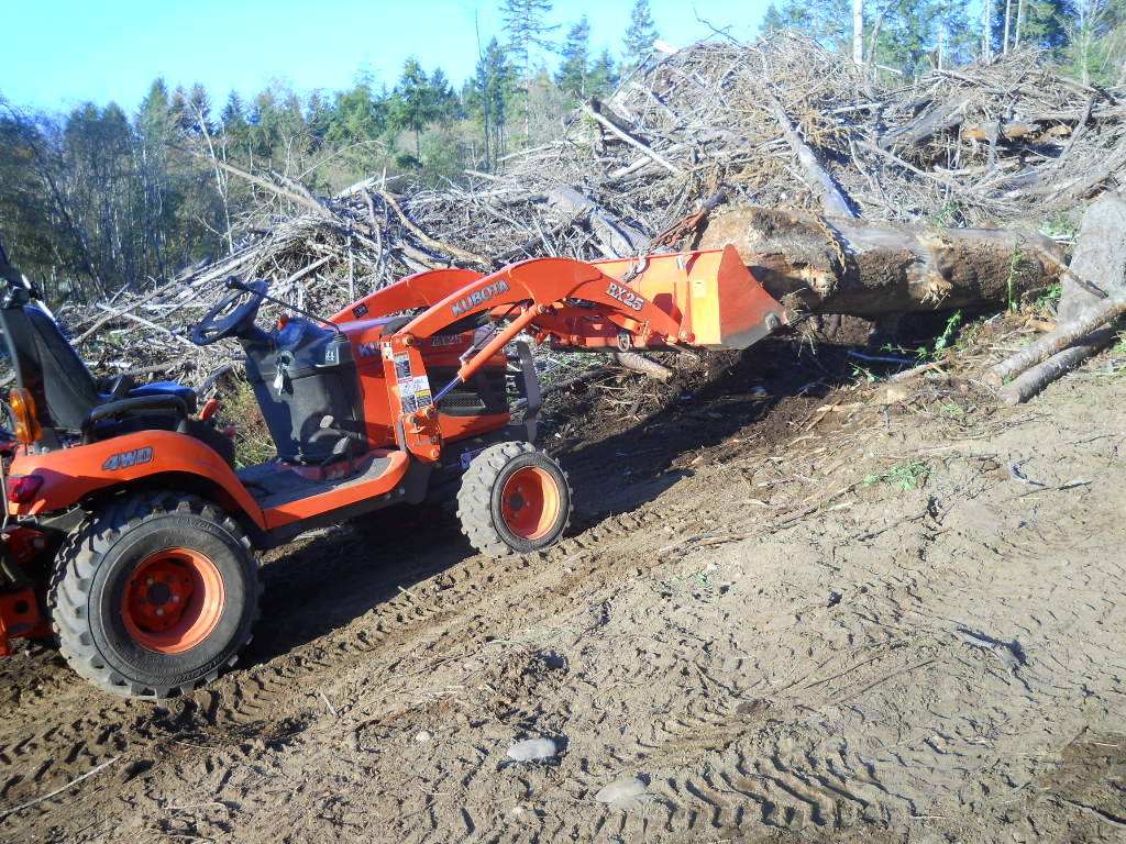

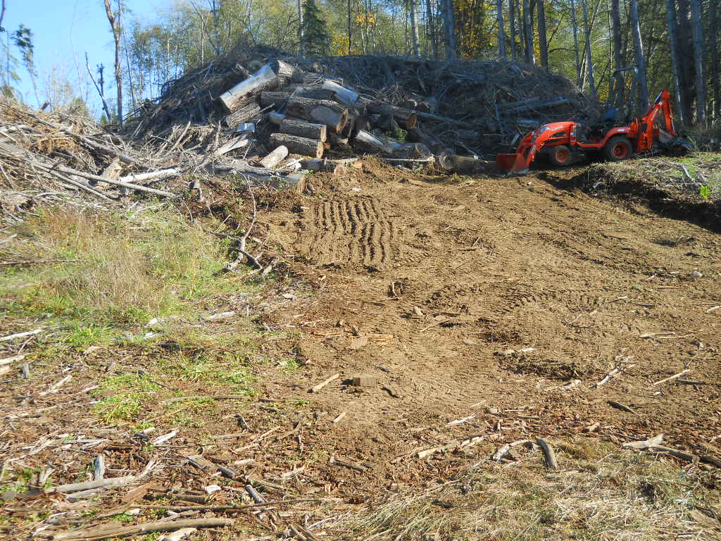

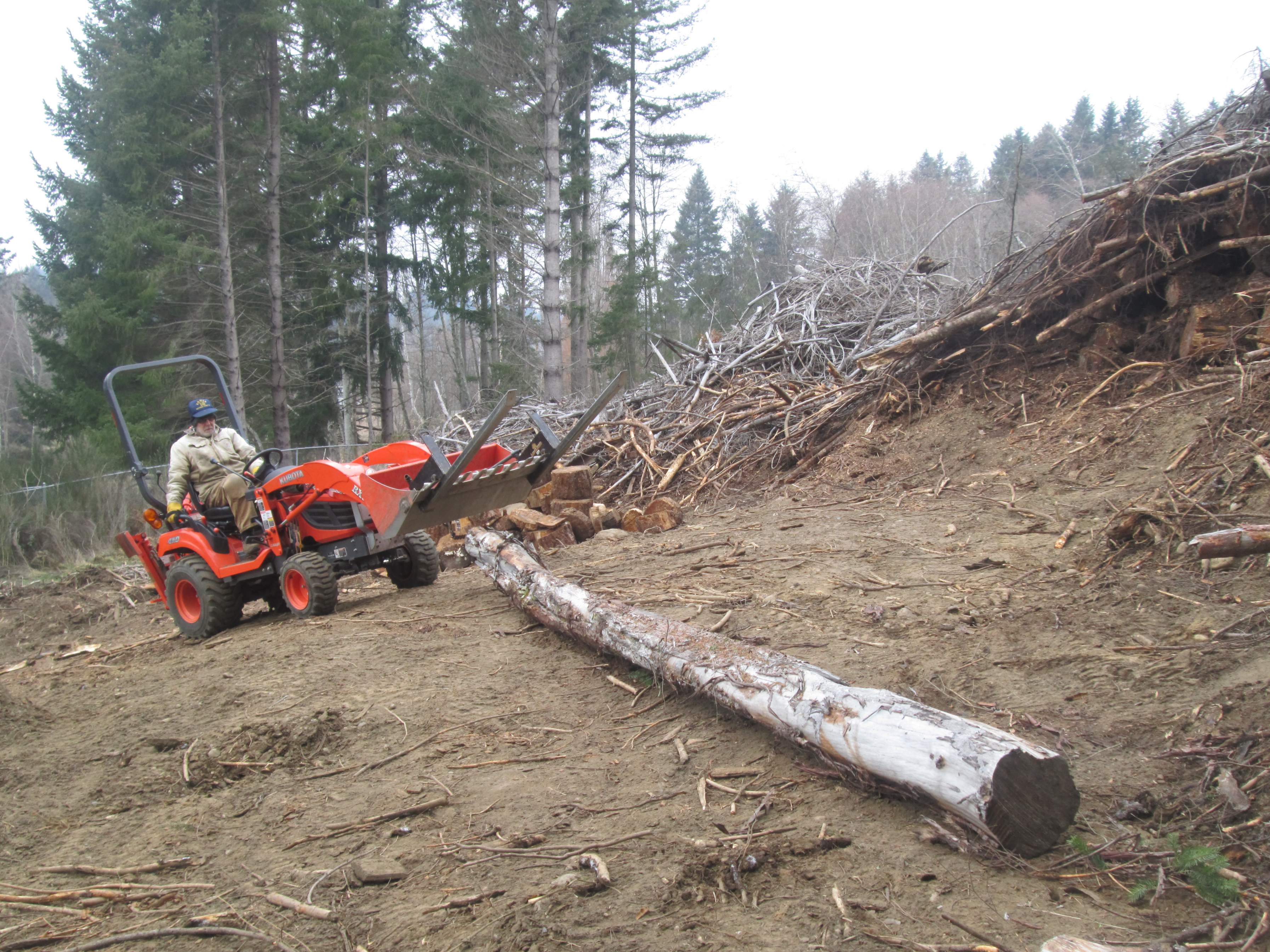

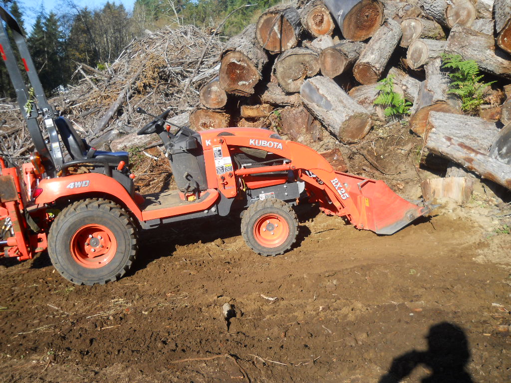

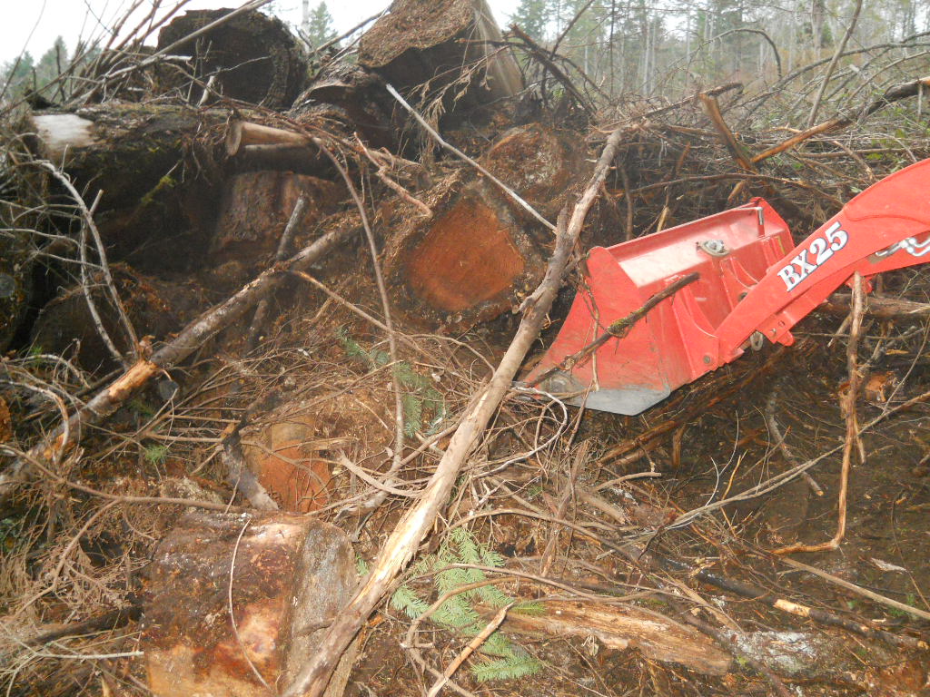

I am working the slash piles left from logging 15 Ac of timber to make firewood to sell. 20 cord to date and that much or more to go. They left two large piles where they set up the processor on either side of the creek; 59 truckloads and many of them over 100K weight. I am putting my BX 25 to the test sorting the largest pile which is on a slope, so had to excavate a level area next to the pile to work from. Quickly learned to move very slowly on the slopes. I use the BH as moving ballast on the up slope side. That means moving it a lot. Some pieces I carry down whole to the wood lot and others just roll to the bottom and then pick up.
See the attached pictures:

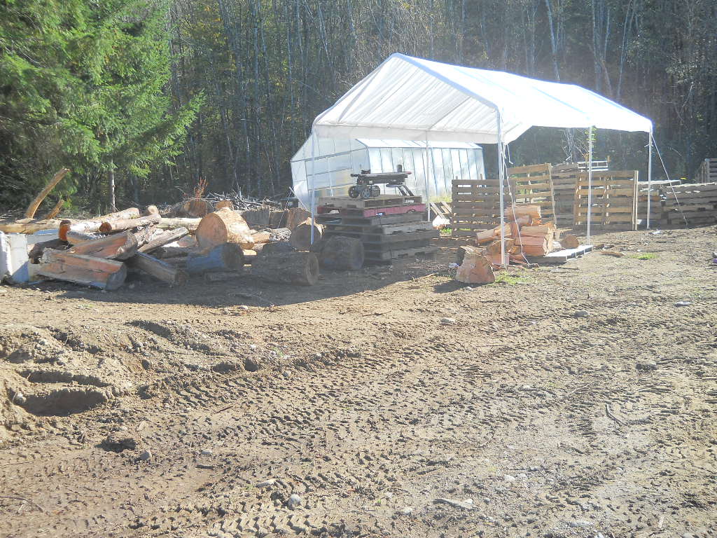

Those long logs are Madrona 10 dia and 15 long. They weigh around 400-500 # each. I have picked up a lot of stuff in the 500 range with the FEL. Sure glad I raised the hyd pressure to 2000K a while back. The rest is fir, alder, and maple. Some are over 36 dia. We split most with a 5 ton electric splitter after splitting the large rounds to fit the splitter bed. Small stuff is faster to split with a splitting mall.

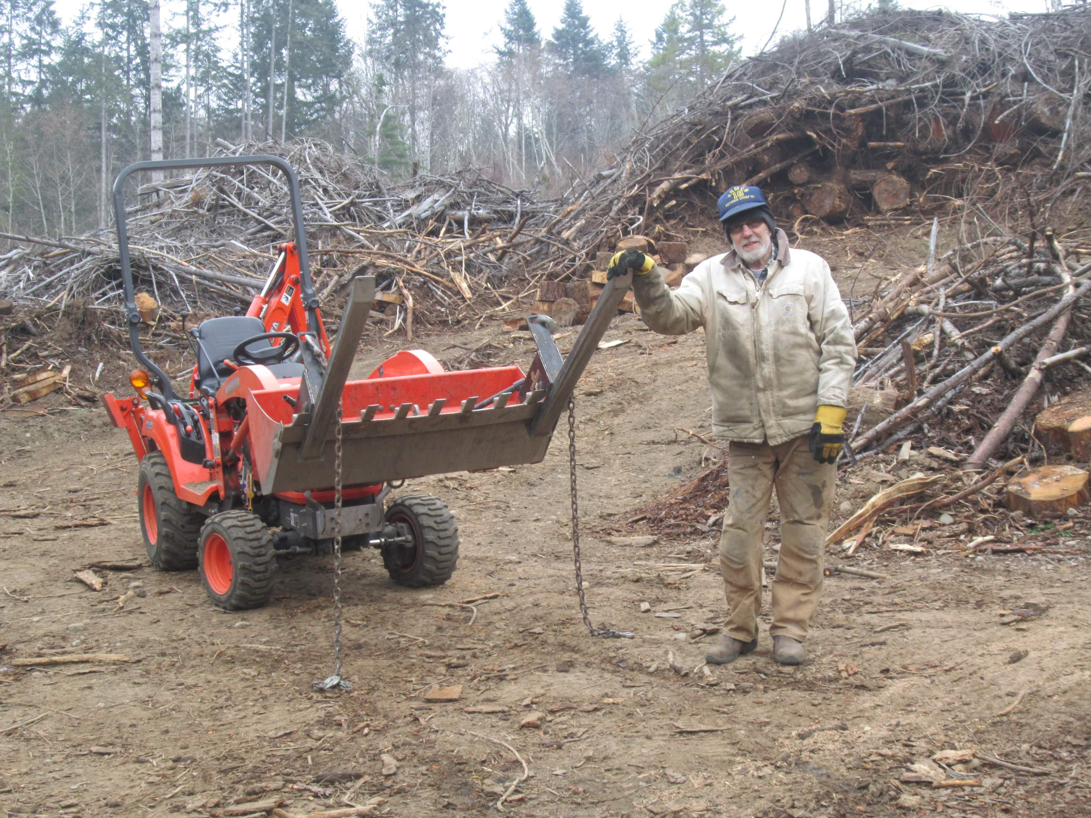

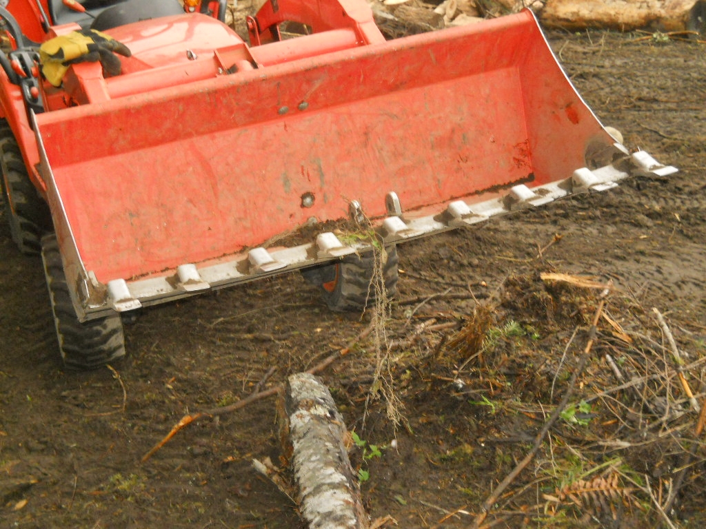

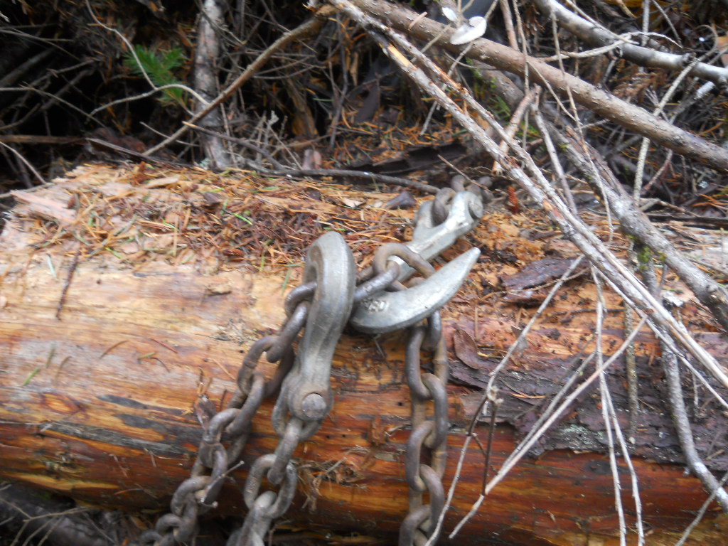

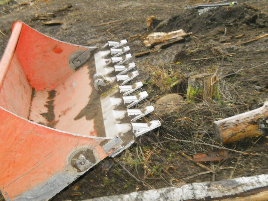

I pull stuff out of the pile with a short piece of chain (I have two) and attached to the D ring on the back of the FEL. Note it is in the bucket center. Note my homemade tooth bar. W/O that I could never have excavated the level area and made the trail I am working around the top of the pile. The tooth bar is also necessary to get stuff up into or on the bucket. All the easy stuff is now pulled so yesterday I ordered a set of log tongs from Amazon. Next is to get a grapple hook to throw to the top and pull down the branches and pieces up there so I do not get them on my head.

The later ones showing the Madrona it was frozen. Earlier not. Here we are on a glacial till, sand, gravel, rock, it packs well and drains fast. My BX never fails to amaze me. I am now working around the pile to the right to get at a new mother lode and it has a lot of organics on top so it gets slippery in the rain, that's why I am at the computer, plus I need to fill my 50 GL diesel tank. That big dirt pile you see in the background on some pictures is actually decomposing sawdust and bark from the logging that is mixed in the pile. The processor strips the limbs and some bark and does the cute to length over the pile of debris. It is my new compost pile I will spread it on the Christmas tree plot I am soon starting. Looking into a manure spreader for that.

Here are some more pictures of the continuation of dismembering that pile of firewood. It continues to be a challenge working on the slope and keeping the pathway graded out. Most grading is back-blading with the FEL mostly down hill. I can now turn around at the upper end to avoid backing all the way up. Half way leveling out areas to work from is also a challenge w/o ability to adjust laterally. Hard to explain, you just have to experiment. Note my homemade tooth bar and the D rings on the bucket. I centered the D rings to avoid uneven loading of the bucket when lifting or pulling out long pieces as you will see. Note the chain hookups. I only use chain with an open hook on one end. This would be impossible to do w/o the tooth bar, it really grabs those pieces and helps in getting up in/on the FEL. Today we consolidated the scattered pieces you see in the overview picture into one concentrated area to reduce firewood time production. Worked further toward the top today hoping to soon work from the top down. Keeps me hopping to supply my crew of 2-3 part-time cutter/splitters.

I set the teeth so the clamp on forks will set on them so I do not have to remove the bar to use the forks. Those tabs in the middle are to anchor a trailer hitch for the same reason.
