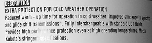

I don't see a problem with using Super UDT for summer. I assume it is a multigrade oil and UDT is single grade. The label states "provides high performance protection even at high operating temperatures"
