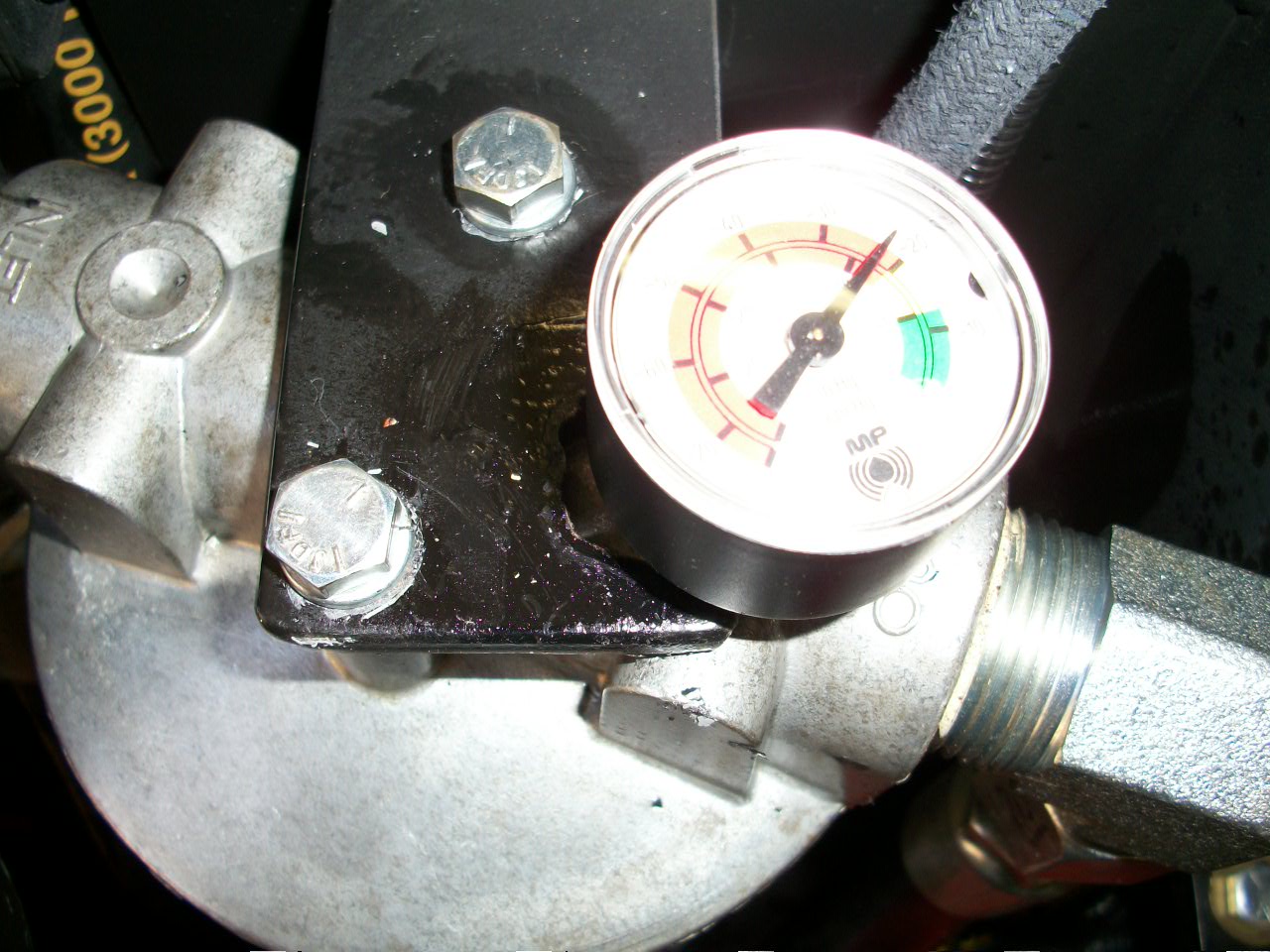

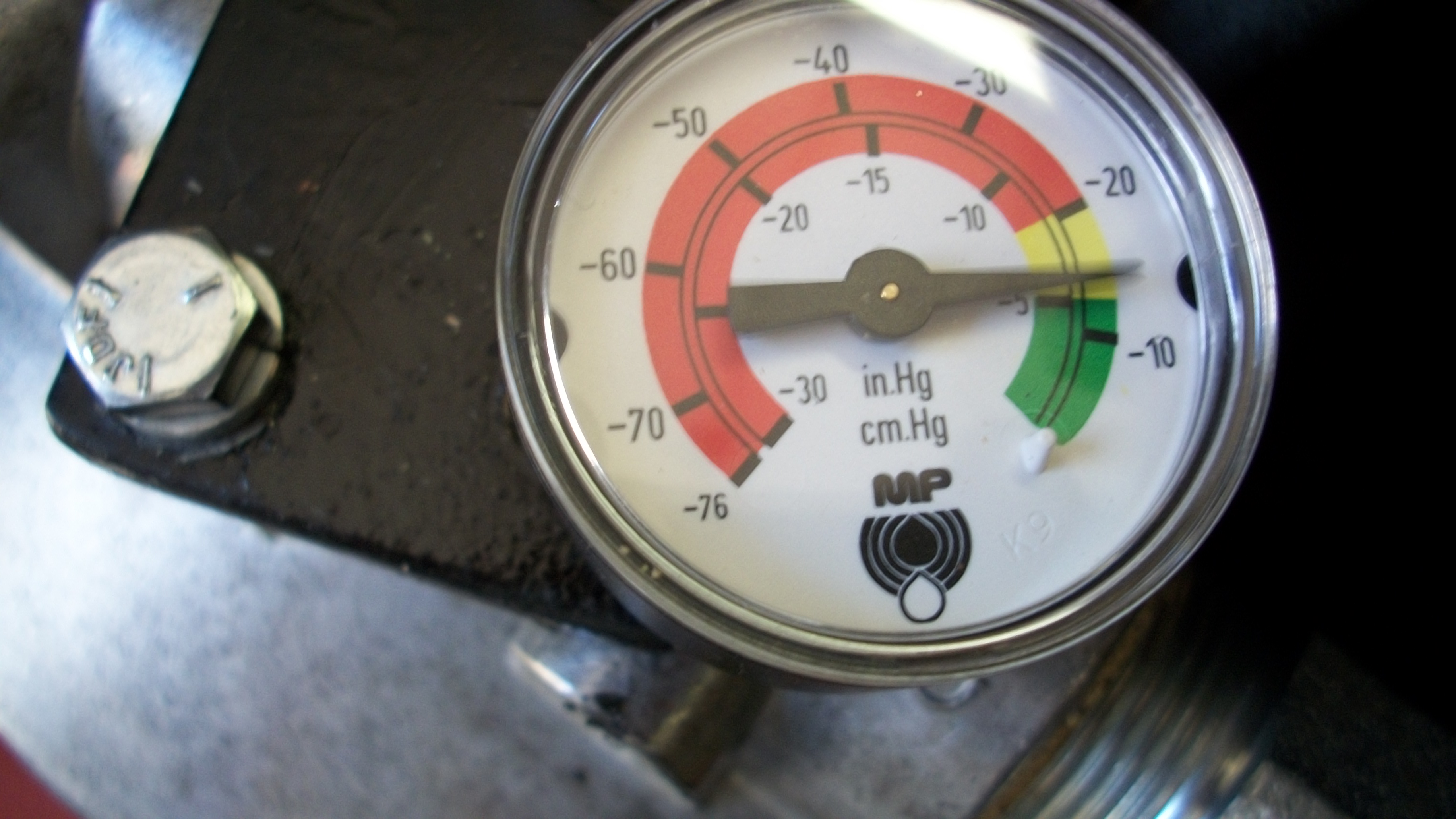

Did my first 50 hr hydraulic filter change and while I had it off, I drilled and tapped the suction side of the filter housing for a restriction indicator. Kind of a disappointment because it is just about out of the green (acceptable) area with the brand new filter, 70 deg oil and engine at idle. It goes up to half scale (red=restricted) when you raise the engine RPMs up to a above normal (for me) speed.
I bought the gauge from a filter manufacturer which was supposed to be for the suction side of a hyd system.
So if anyone thinks it is worth doing this you may want a higher scale gauge and also liquid filled (because it flutters at times).
The reason to have a indicator is once you build a history of how it acts, you can tell when to change your filter, or if something is going wrong in the hyd system and inducing contaminants which plugs your filter early.
the pic with the lowest reading is at idle, oil temp 70 deg.
the pic with a higher reading is a low working speed, temp 70 deg
The other pic shows the general area.

On Power trac the hyd filter is on the suction side. The filter is in series in the line that goes from the bottom of the hyd reservoir to the inlet of the pump. It is always a vacuum. If you look close on the filter housing, there are 2 divots, one toward each opening (inlet/outlet). You can see one divot in my last two pictures. The divots are the position the engineers of the filter housing want to be used as mounting points for indicators/gauges. If I were to use the other divot (inlet side), it would only measure the vacuum necessary to draw the hyd oil up to the inlet of the filter housing. It would only change due to temp and oil viscosity, and the condition of the filter would have no bearing on the reading. I used the outlet divot and therefore it registers the "vacuum necessary to draw the hyd oil up to the inlet of the filter housing" plus the vacuum necessary to draw it through the filter housing and media. As the media gets contaminated the amount of vacuum will rise. Trucks with diesel engines typically have a similar device on the air filter housing. On those it locks in place to register the highest reading (because you can't be there to see it when driving as it will get the highest reading when the engine is at peak HP/torque). Hope this helps. A QUICK NOTE, IF YOU TRY THIS KEEP EVERYTHING SUPER CLEAN, TAKE THE HOUSING OFF AND WASH IT AFTER DRILLING AND TAPPING.

I've argued before the viscosity of the motor oil selected by Power Trac is too high. For example, if you have a Sauer Danfoss Series 40 pump, the recommended continuous inlet pressure is no less than 6.3 inches HG vacuum. Max cold start is 9.2 inches Hg vacuum. Looks like you right on the limit, which is also what your gauge is showing.
That said, 70 degrees isn't very warm for hydraulic systems (even though this is a multi-viscosity oil). It would be interesting to see your reading at cold start and at say 170-180 degrees on the oil. Those are the more interesting readings.
Kubota, for example, requires a 15+ minute warm up if it's freezing or below. They want the oil warm before the tractor is used to avoid cavitation issues.

That morning I ran the machine for a hour to warm up the oil with the thought it would be easier to bleed. It would have been a quick change, but after I drilled and tapped the housing I couldn't clean the chips out satisfactorily, so I took the housing off to wash it out. By the time I finished it all up, the oil dropped to the 70 deg figure and I included it to give a better idea of what was going on. A liquid filled gauge is really needed, if my gauge survives, I will update with figures at high temps.
