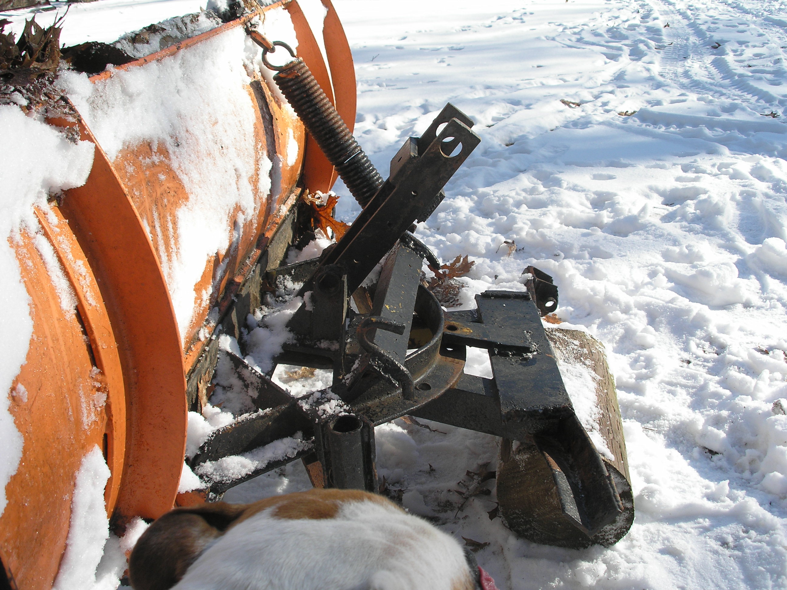

Radioman,
I went and dug out the truck plow from under the snow figured it might give you some ideas. There is a mount that broke off and the angle iron twisted, hence why Im looking for other options due to the weight of this plow.
Here is some pictures of the plow and mount, this pins on to the FEL arms and the center cylinder is unhooked and moved to that upper mount.
