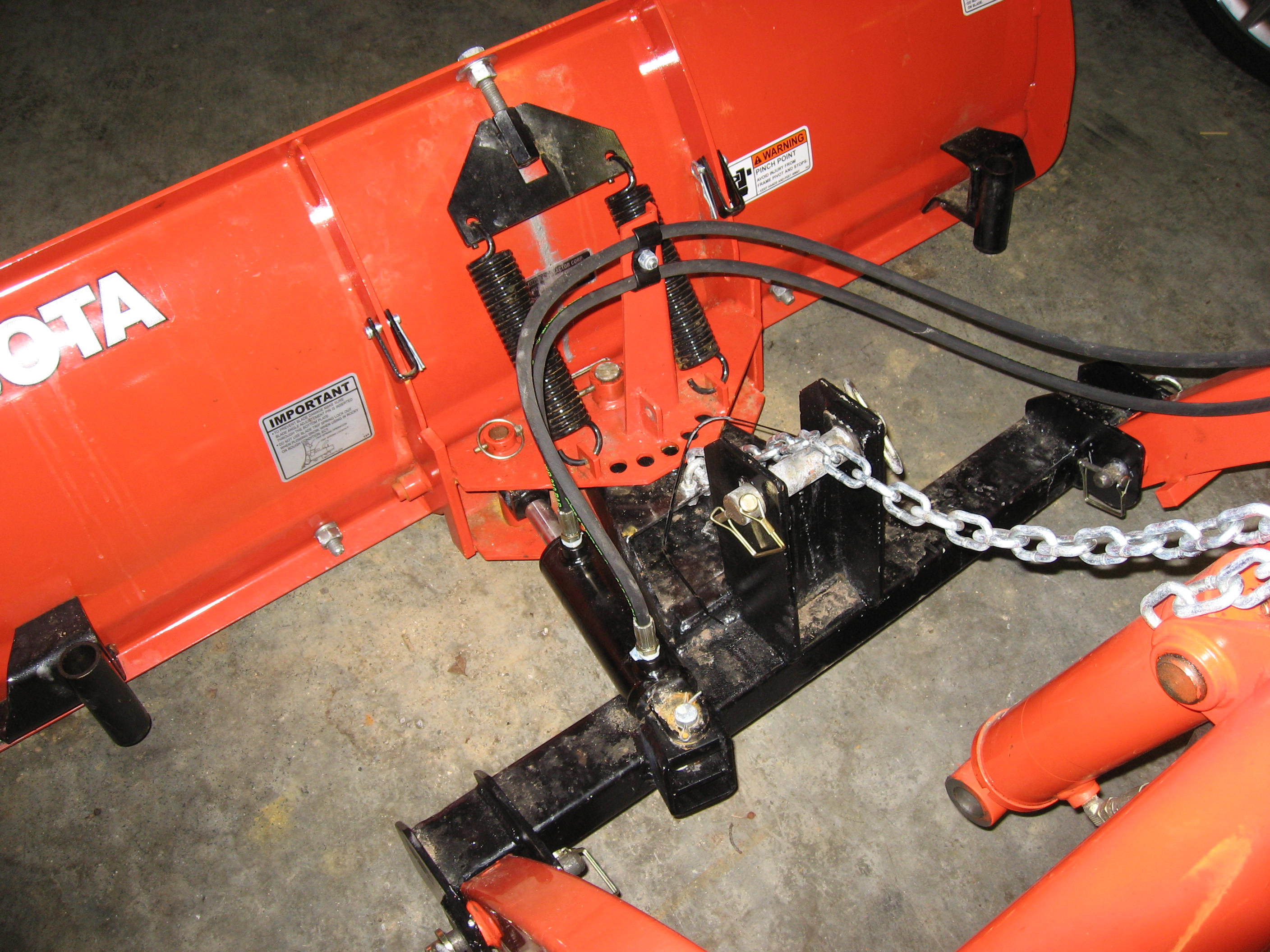

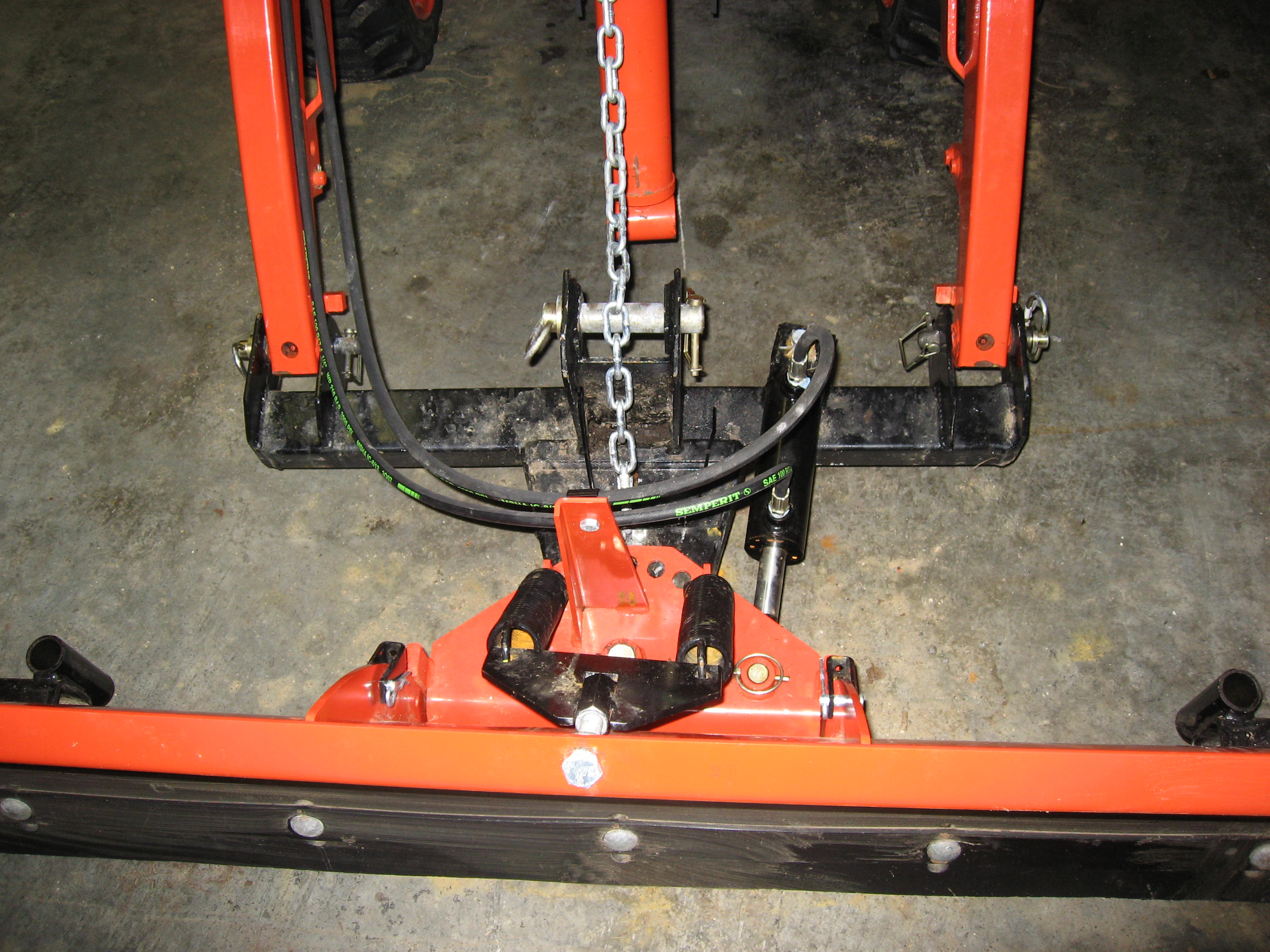

2*This is almost as much as I paid for the 60'' front blade for my BX1500 which I can also use on the BX23.
1*I looked into the JB plow for my CC GT 2554 but since it cost about as much as the Kubota 60 inch blade ran me I just bought the Kubota blade with a BX1500 on it and left the FEL on the BX23 for loader work.
The Kubota blade is much wider than the JB blade.
The Kubota blade is Hydraulic lift and angle.
The JB is electric lift and angle.

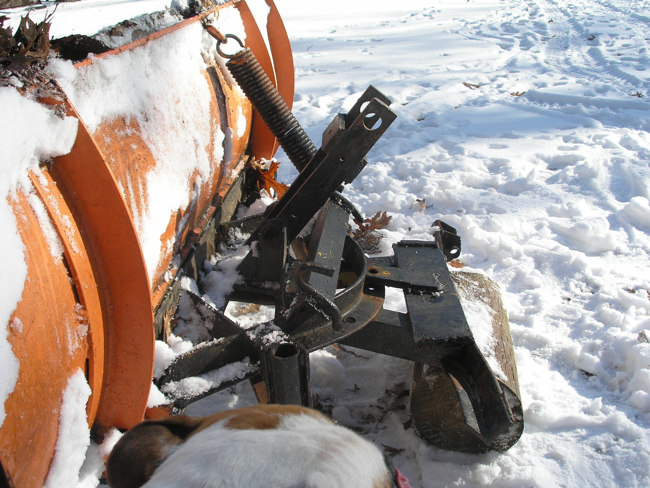

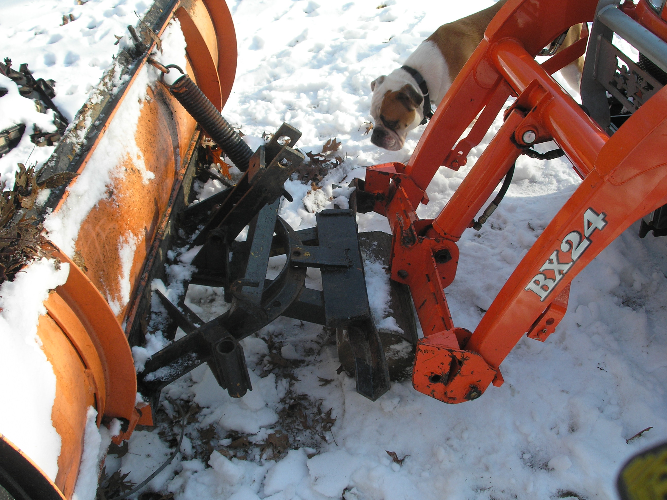

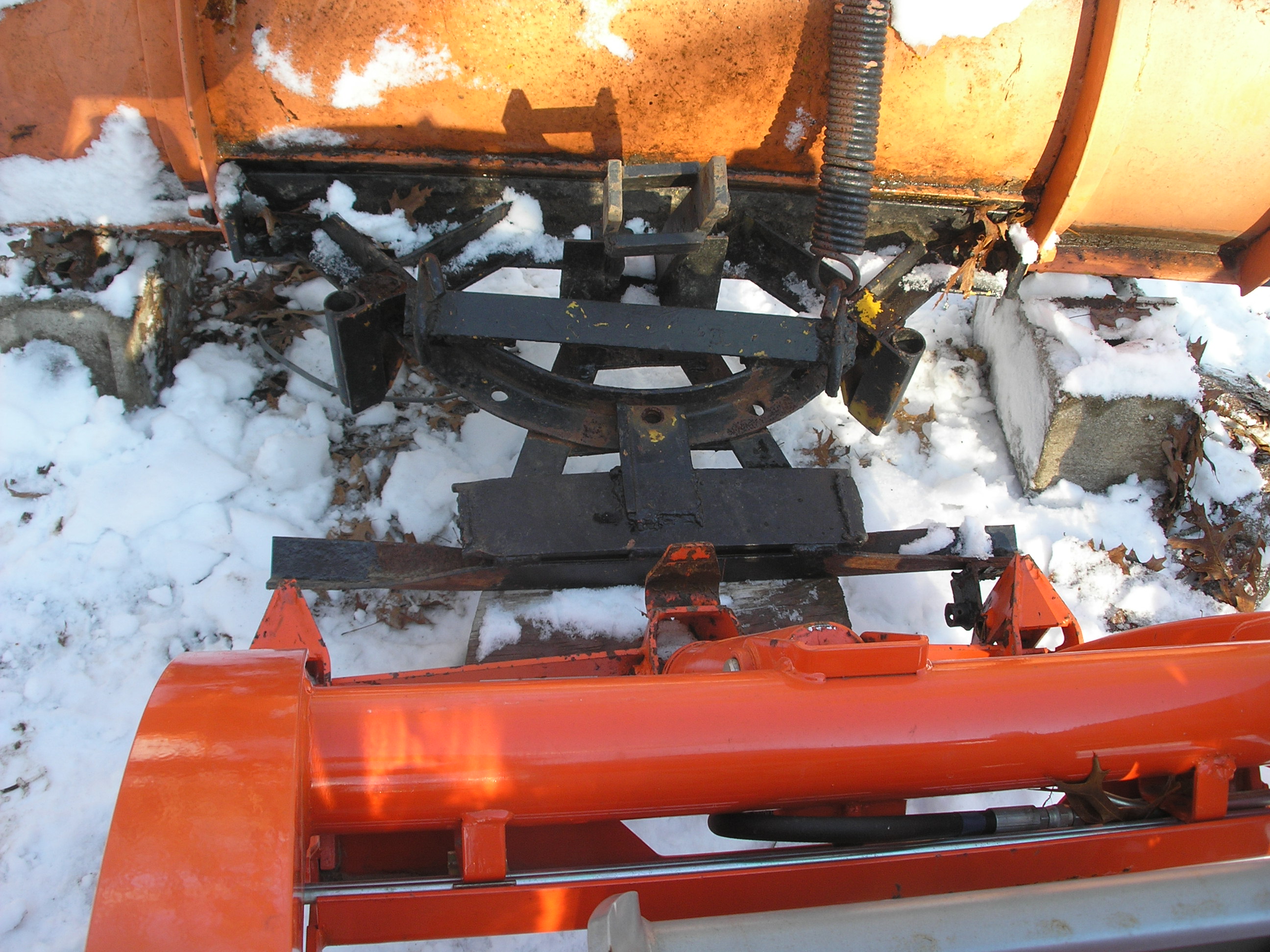

I am too, wondering on how yours is setup. I have a old truck plow i pciked up for free and i want to adapt it to the fel arms as well. the plow is not too heavy- i beleive its nearly the same wieght as the bucket. I saw someone else make a post recently on how he adapted it to his fel arms but it wasnt a BX. I am still pondering my options.
Radioman,
I went and dug out the truck plow from under the snow figured it might give you some ideas. There is a mount that broke off and the angle iron twisted, hence why Im looking for other options due to the weight of this plow.
Here is some pictures of the plow and mount, this pins on to the FEL arms and the center cylinder is unhooked and moved to that upper mount.
