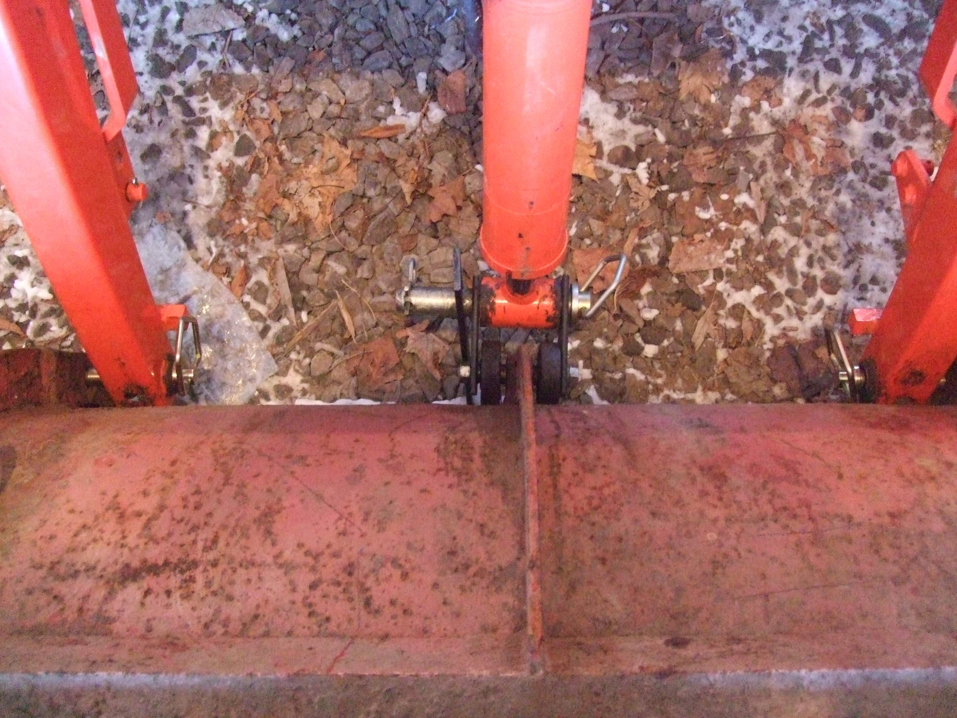

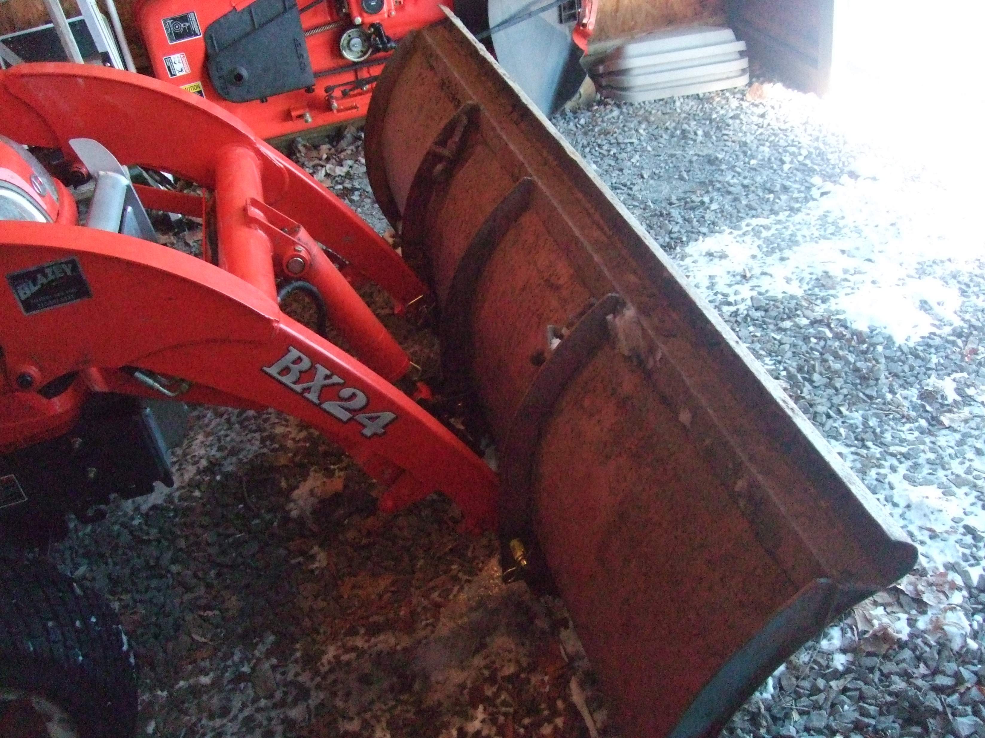

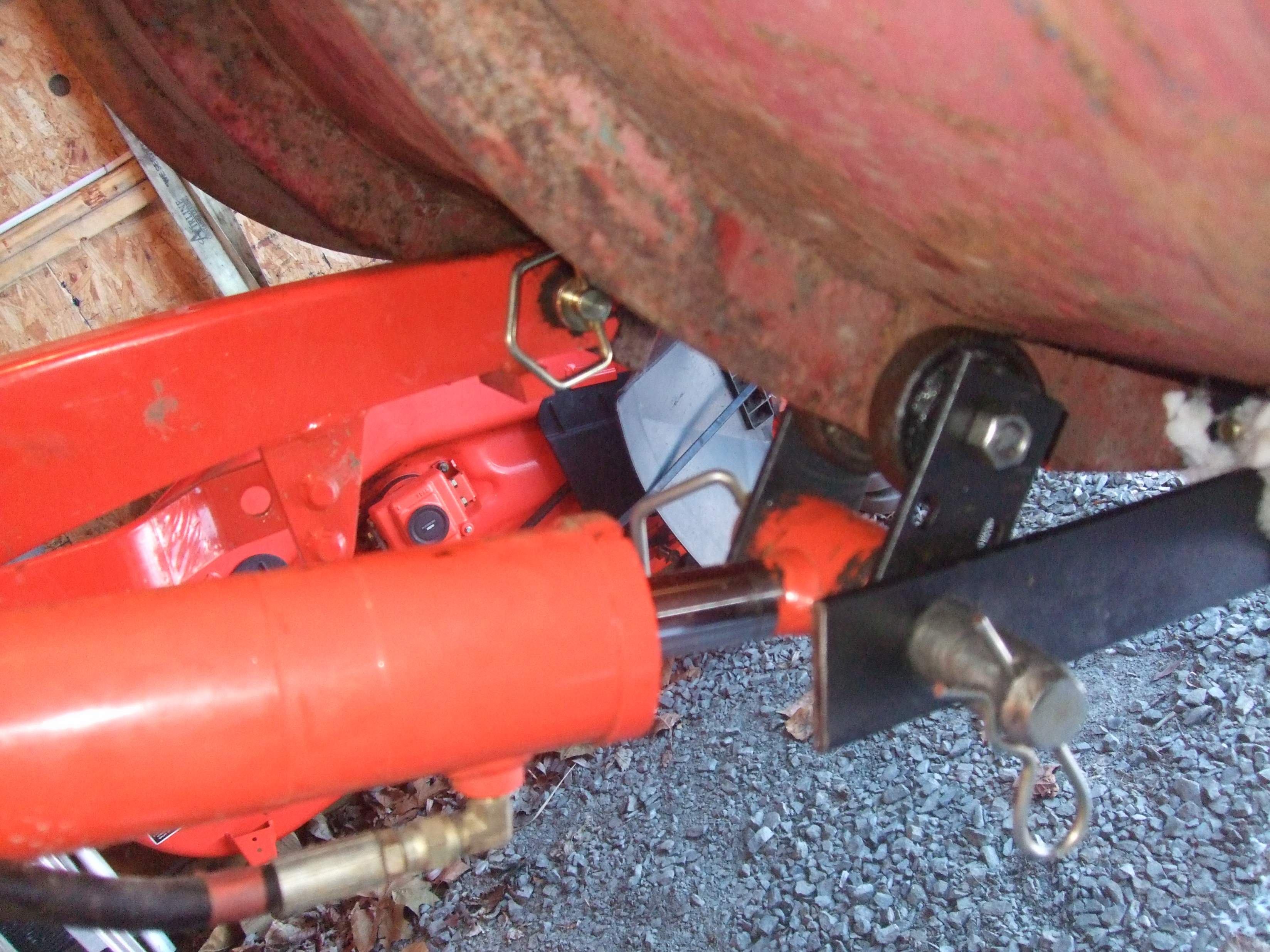

I finally got around to hooking up a old meyers plow (i think its meyers, could be western). I tried to think of a way to use the a frame as is so i can angle it but no dice. I would have to do some fabbing to make it work . For now i took the a frame off and hooked the fel arms directly to the plow. It works pretty good, but the float position is at the wrong height. I have to "read" the ground while i am plowing- just to be careful not to scalp the lawn. the plow is pretty light, i would say its a tad lighter then the bucket. the majority of the wieght comes form the A frame of the plow and that has been removed. This summer, I hope to find the time to fab up the a frame to adapt to the fel arms so i can be angled. I'm including the pics here to show how it was hooked up. :)

With no trip springs I wouldn't want to use that plow. You have it set up more like a dozer blade
   / BX FEL snow plow #37

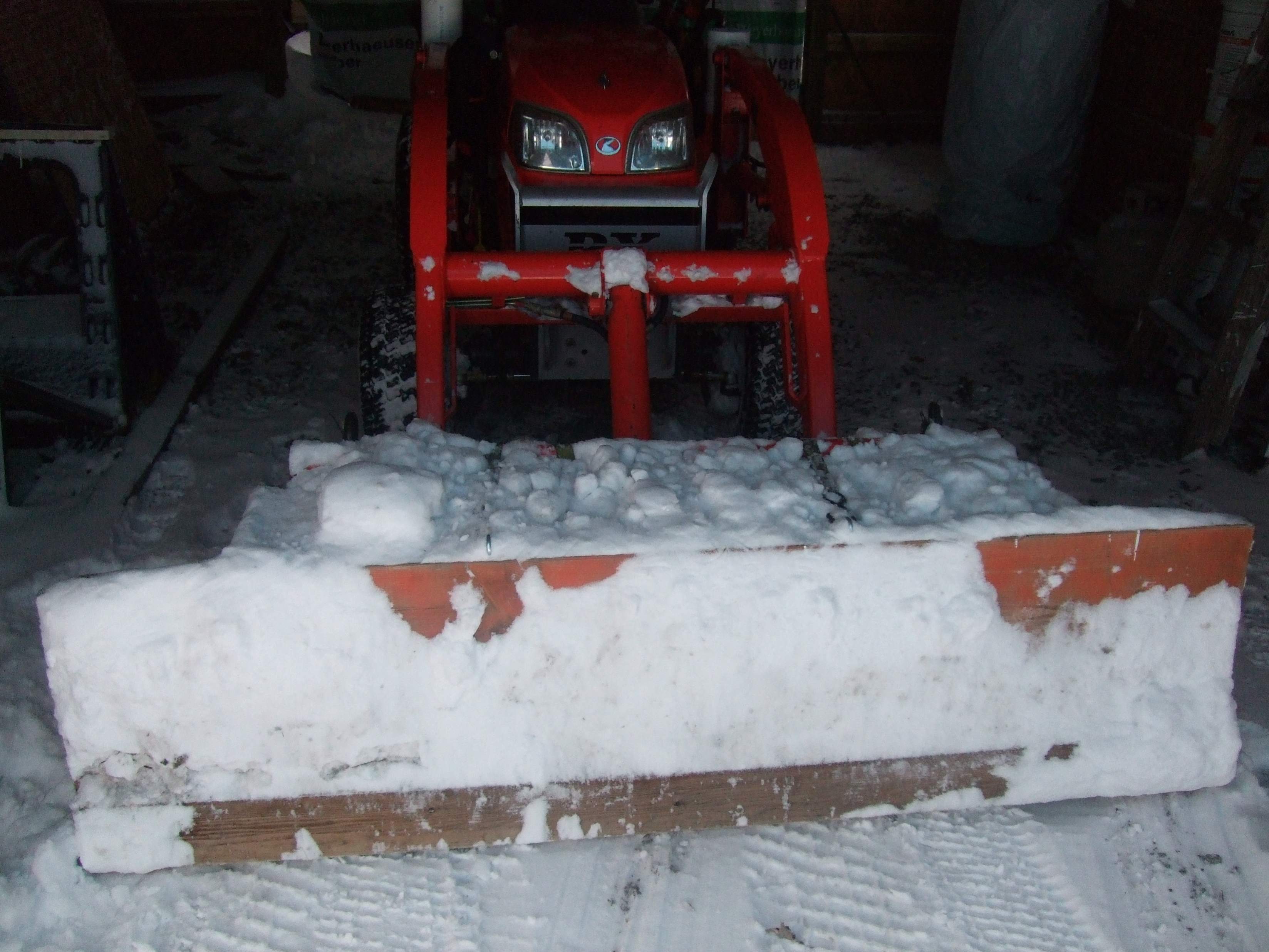

yeah - that's the reason why it will be my new summer project this summer to put a frame back with trip springs. IF you saw the condition it was when i first got it , you would agree that it would be the quickest way. previously i had a poor mans wooden snow pusher built and it was showing the wear very quickly on the bottom. here the pics of what i wass using before and what i got now was a huge improvement for snow clearing. I rather patch a couple spots this spring in the lawn then to keep using the wooden snow pusher. sorry about all the snow in pics.
