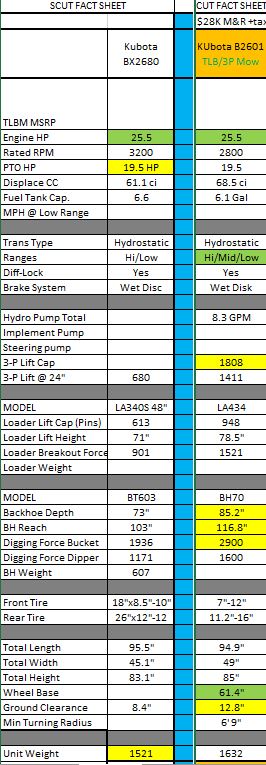

Your trading in a B2601 because it is to large? In what way?
Let me place the numbers side by side for you.....
Your BX is a half inch longer.
BX is 3.9" narrower.
BX is 1.9" lower at the ROPS.
BX has 4.4" less clearance under the front axle.
BX is 111 lbs lighter (bare tractor weights)
BX loader is 330 lbs less loader lift.
BX lifts 7.5" less height.
BX bucket break-out force is 620 lbs less.
Going to the BX is not saving you much at all in size, but it sure costs you a lot in performance! And when you trade that thing in, your going to want to bring a tub of Vaseline with you. You'll know what to do with that as the deal forms.

Your trading in a B2601 because it is too large?
Excellent advice. Keep the B2601.
