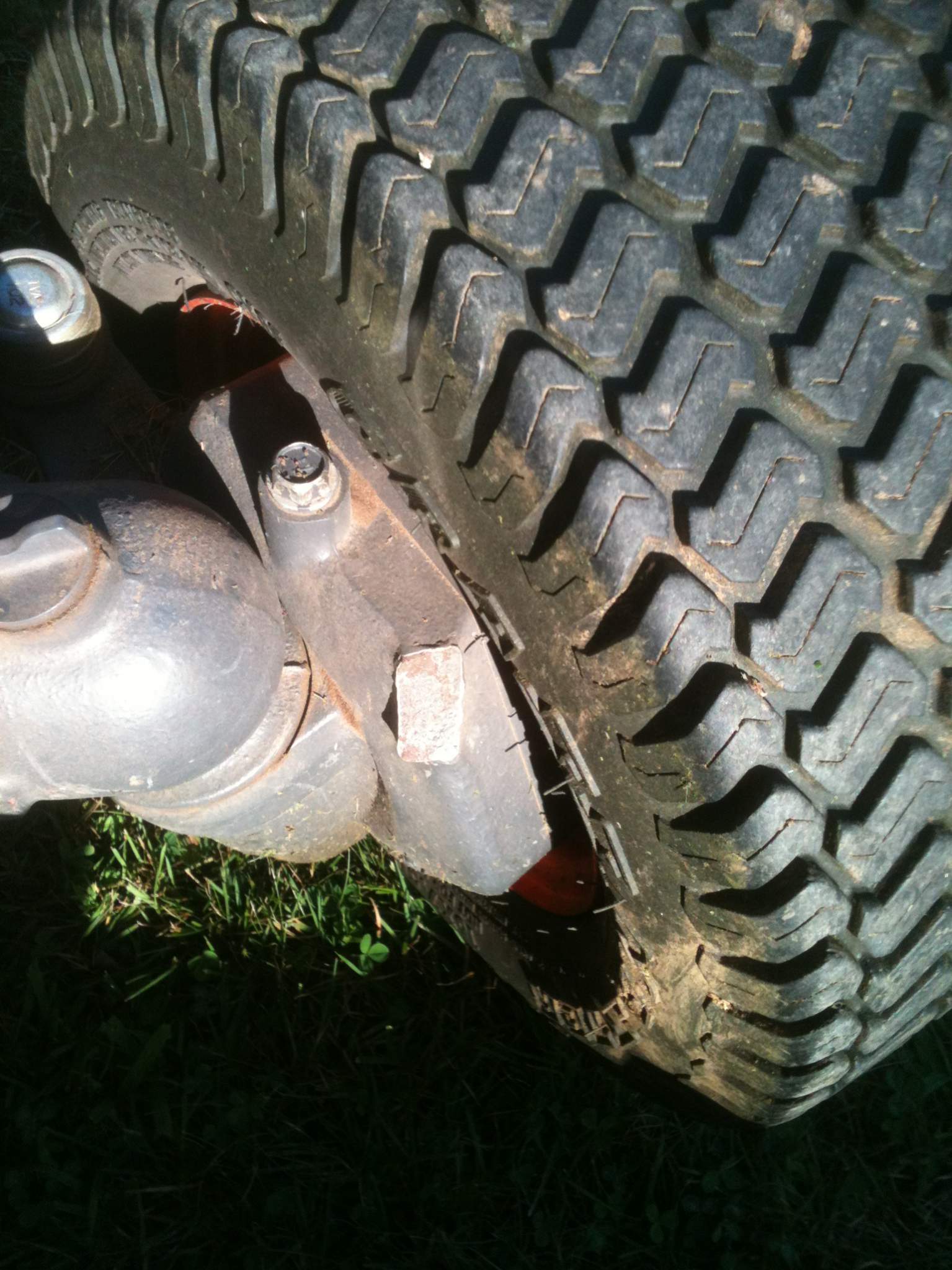

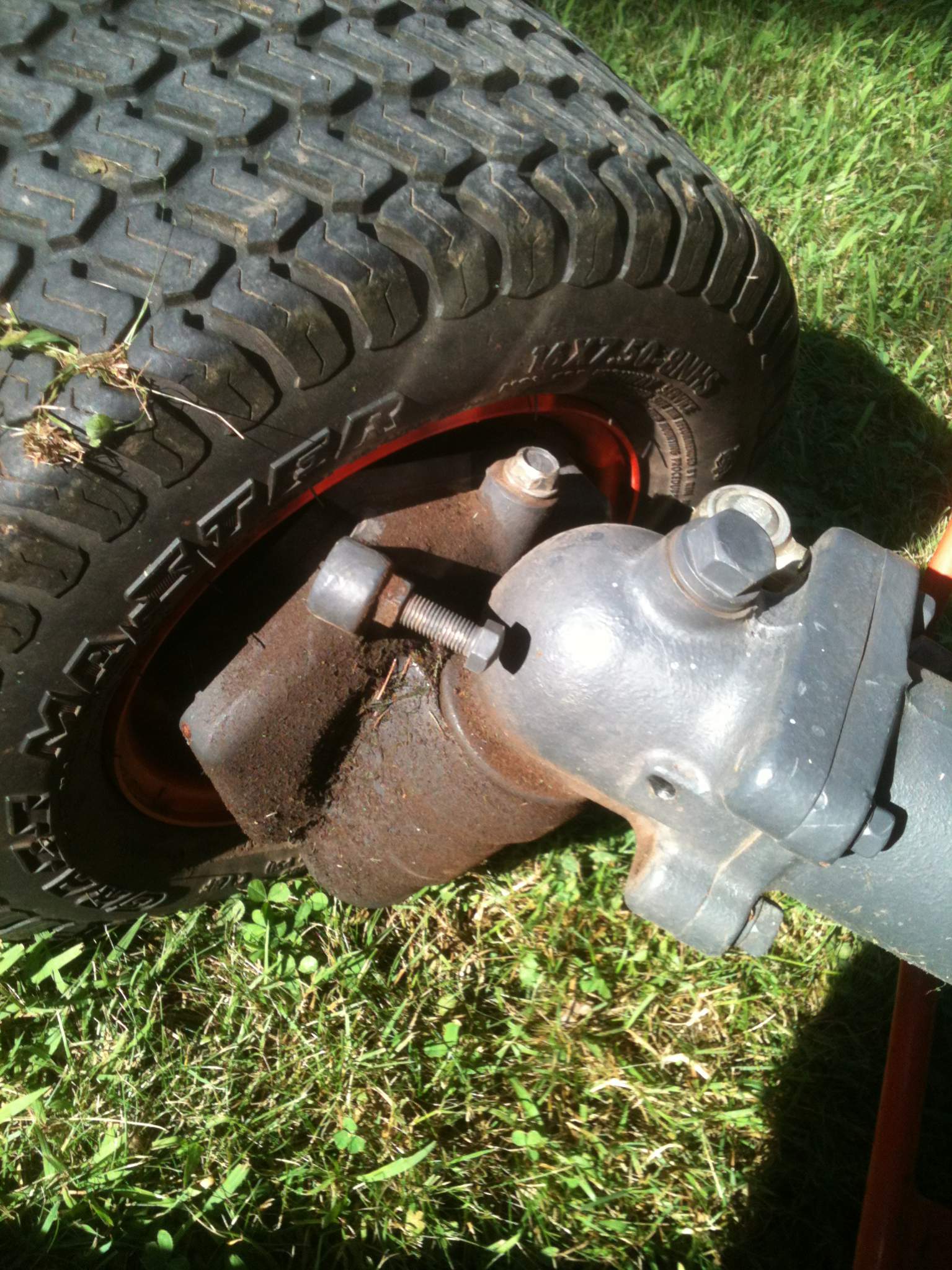

I noticed that the steering stop bolt is broken off for the right front wheel, it looks like the casting snapped off from the steering knuckle. Has anyone ever seen this before? If I can find the missing part that broke off can it be welded back on?
The tractor is a BX 1500 with only about 300 hours on it. I included a picture of the right side which is broken and a picture of the left side for comparison.(You'll see that the left side is leaking, any ideas about that?) Front  axle 1.jpgFront axle 2.jpg

I've seen something like that on a L3650. Usually caused by stress like turning the wheel when it is locked in place by a rock, dirt, stump, or the like.
The best solution is to replace the broken part. Welding on cast is iffy at best.
It will need a new seal so that can be taken care of at the same time. The leak was not related to the break.

Hard to say if it could be welded for sure without testing it but I would guess that it could be welded by a competent welder.The part should come off to fix it properly .If the casting is cracked,I probably would buy a new part but if it is just reattaching the block,it should be alright to weld it.Having the piece would be best but the part could be made out of steel and welded to the casting.There are various welding processes that would work but I would TIG weld it with a Certanium 423T rod.You would have to judge the cost of repairing verses replacing.Just my opinion but I have been in the welding repair business for quite a few years.

I am still looking for the part that broke off, it's out on the lawn somewhere. The only welder I have is an AC stick welder, so if I understand, I probably shouldn't try to weld it, just replace it?

I would say you are correct.If it were my tractor I would try welding it as I would be out nothing but my time.It will take a fairly experienced welder to do a proper repair on this.If that is not you then it would be best to get a new part or get a price on repairing from a welding shop.

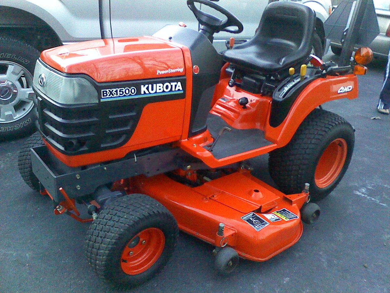

Can you post pics of the entire tractor?
Is it the same as a BX25?
What is this tractor used for?
Who drives it?
It is a business yes?
Do you have weights in the front plus a FEL?
Was it abused?

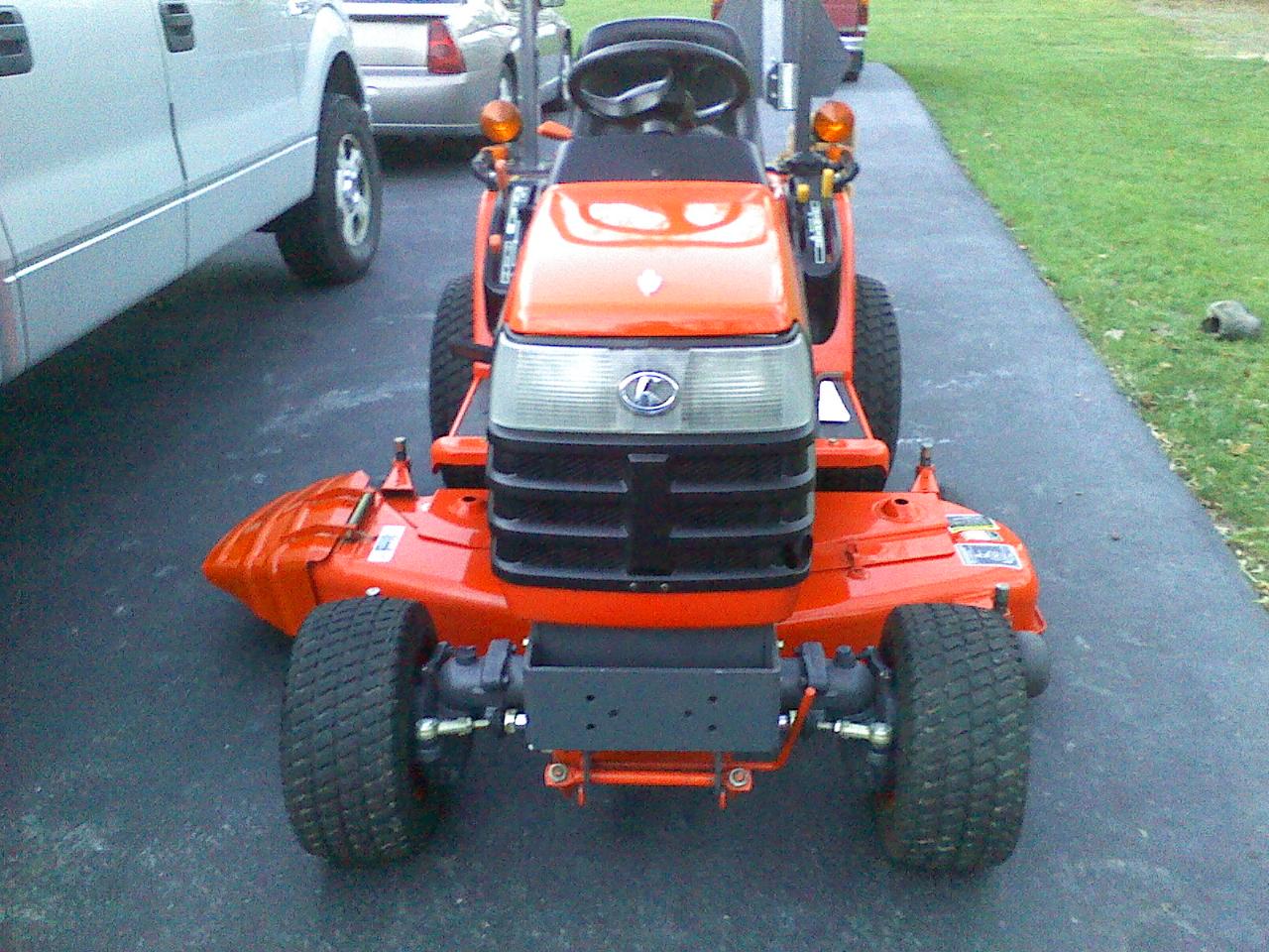

The tractor is a BX1500D, I am not sure if the front axle is the same as the BX25
The tractor is used mainly for grass mowing around my yard, no commercial use.
No FEL, no weights
I bought the tractor used last fall and it appeared to be in great shape it only has about 300 hours and I drive carefully, no abuse.

Tractor looks to be in excellent condition :thumbsup:

It could have just been defective from the factory. My BX23 had a crack in the front axle - not sure what the part is called - but it's the end of the axle that the wheel attaches to. It cracked and was leaking hydraulic fluid (axle is filled with hydraulic fluid).
I took it to the dealer when the tractor was still under warranty and they replaced it. When I asked the service manager whether the crack could have been caused by abuse, his comment was: " unless you're driving it off the top of 2 story buildings - no, something like that was not caused by abuse. It was likely just a defective casting".

My neighbor has the exact same tractor with BOTH stops broke off, one on each wheel. He has had them replaced and broke them off again. His unit is about the same shape as yours and he has just been driving around for 3 yrs without a problem. So, it is up to you if you think you need them. He hasn't thought of changing them again because of the high cost just for the part.

I would be cautious, concerned about running without steering stops incorrect adjsuted stops. The stop and the tie rod need to work together if in a tigt turn and a front tire falls in a rut, hits a rock, or that landscape timber you're trying to avoid. Without a stop or one set too short all the impact pressure is applied to the tie rod which can bend the rod or possibly a failure like gwdixon posted here. Not saying that's what happened to his but is a possibilty. having a stop set too long would cause all the impact energy to be applied to the stop bolt because the tie rod still have available travel, and a failure like the OP posted could happen. Again not saying this is what happened but se sure to set those stops correctly.
Do not know how Kubota says to adjust theirs, in my service manual on the Bbocat says first make sure tires are same size and equal air pressure then turn stop bolt in, turn wheel fully to end of tie rod movement, turn the stop bolt out until it touches the axle then add about 1/4 turn and lock jam nut. Repeat for other side.

After consulting with the guys over on the TBN Welding Forum there may be a chance that the part can be welded back on.
First, the missing piece needs to be found.
Since it is only a stop, instead of a crucial part like a tie rod mount subject to a variety of forces, a weld can be made to just hold it in place.
Grind a 45 degree angle on the broken piece on the wheel side of the break. Have it penetrate a half inch to 3/4 inch. This will give you a "V" trough in which to deposit the weld. (Grinding the "V" on the other side, the frame side, would make for a stronger fix but would be harder to access to weld. It would require more welding skills. Modify the instructions below if that is the choice.)
Get some 3/32" 7018AC rod for the AC welder - make sure it states AC on the box.
Preheat the welded area, both sides, with a propane torch - not blazing hot but plenty warm. Run a stringer in the bottom of the "V" to attach the pieces. Clean the slag and run another straight stringer that ties into the first stringer. Then another on the broken-off piece. Continue running straight stringers until the "V" is filled. Do a bottom stringer and then build on that for each layer - let gravity be your friend. The last set of welds may take four or five stingers. Be sure to clean the slag each pass.
Grind a small "V" and fill with a single stringer on other side to prevent the main welds from shrinking and pulling the other side of the broken piece slightly away. Weld the small stinger after the first stringer on the main "V". (If you initally ground the large "V" on the frame side then do the smaller "V" on the tire side, of course.)
The tire will have to be removed to give better access. Using the bucket to lift and a jack stand should be enough.
BTW, if the sparks from grinding are orange then the piece is cast steel and the above method should work. If the sparks are cherry red then it is cast iron and a whole different set of procedures should be used.
This is not the best fix but will do for the particular use and the materials/tools that you have available. Sometimes a "farmer fix" will last quite a while.
