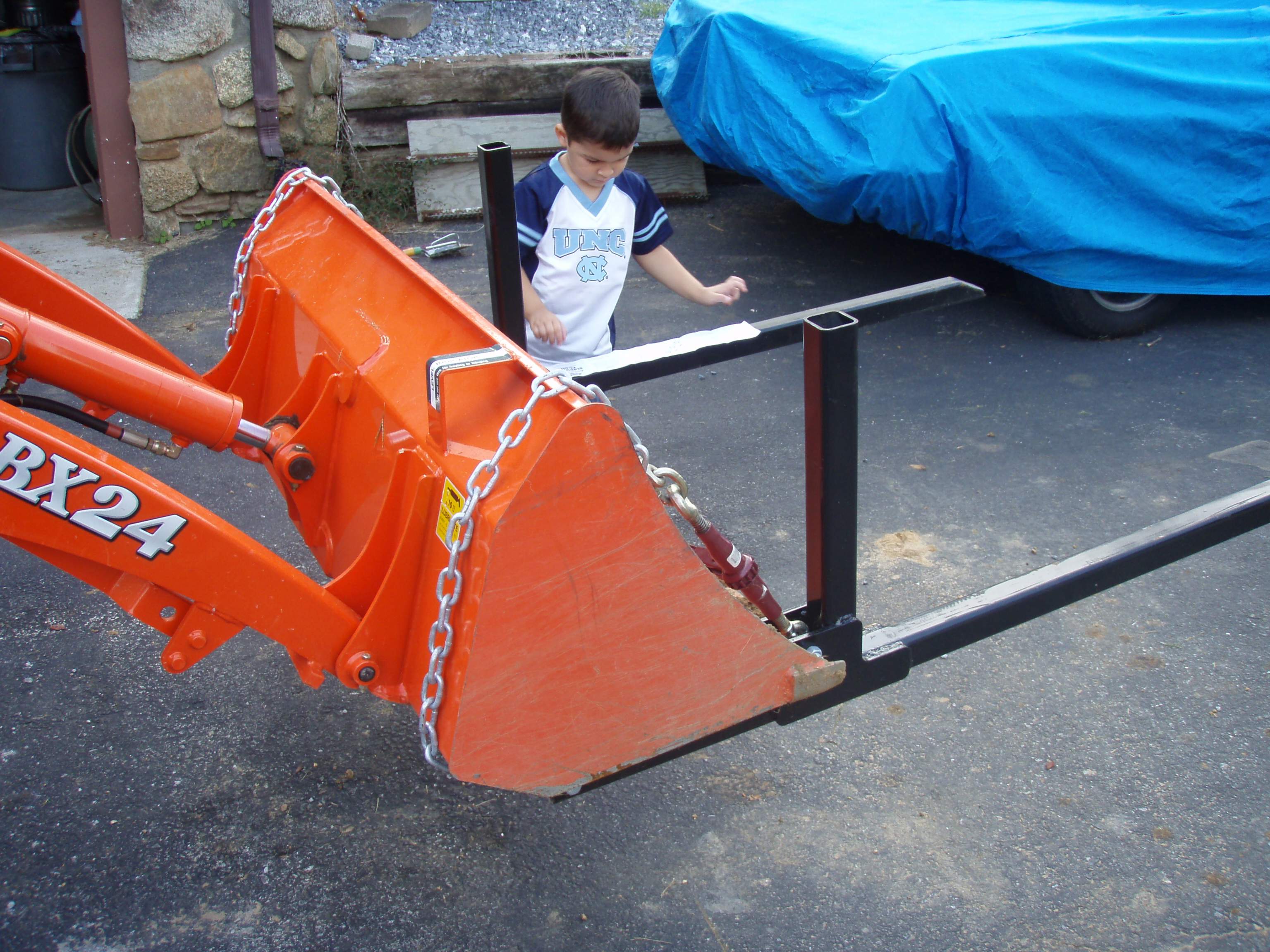

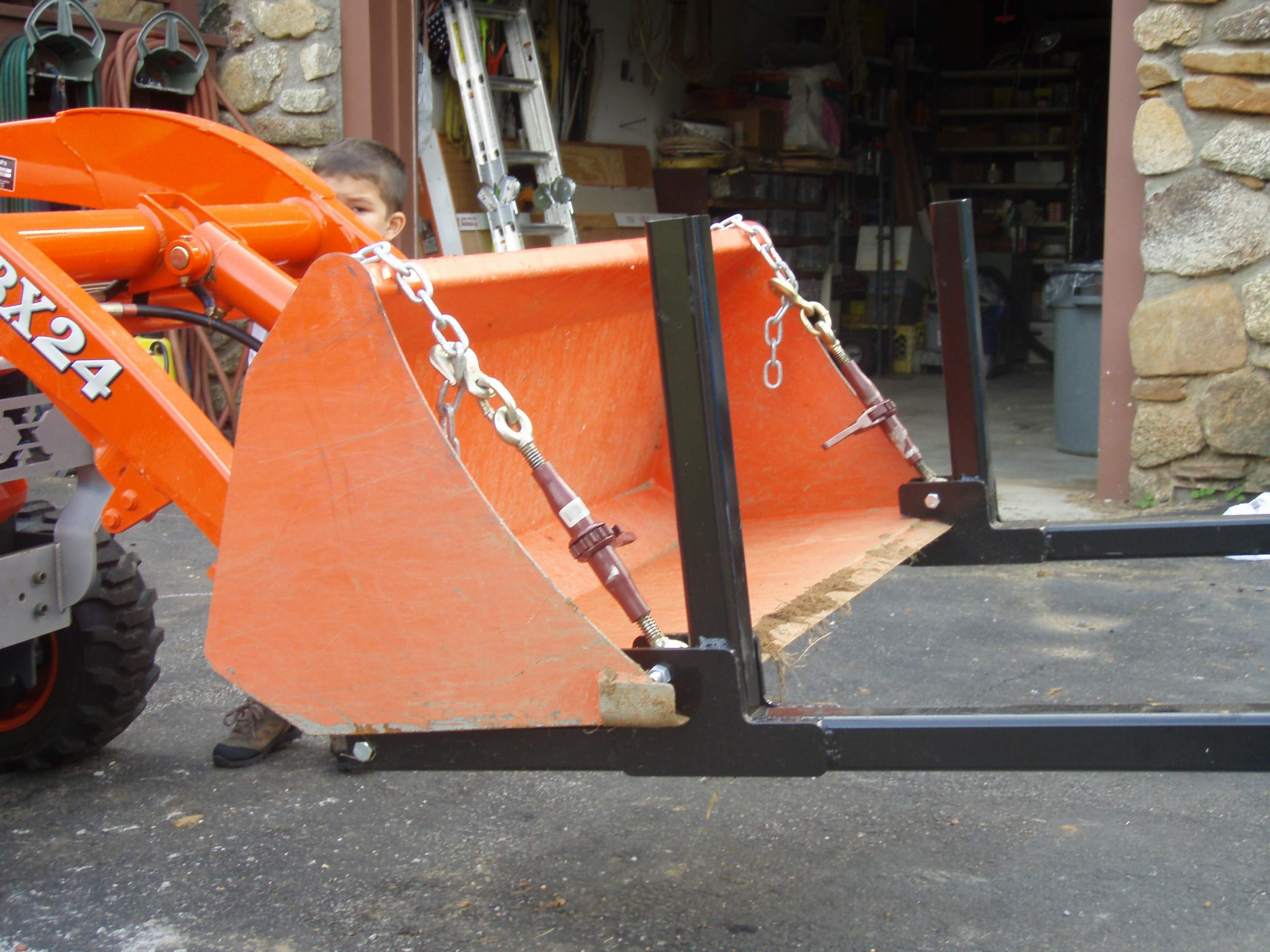

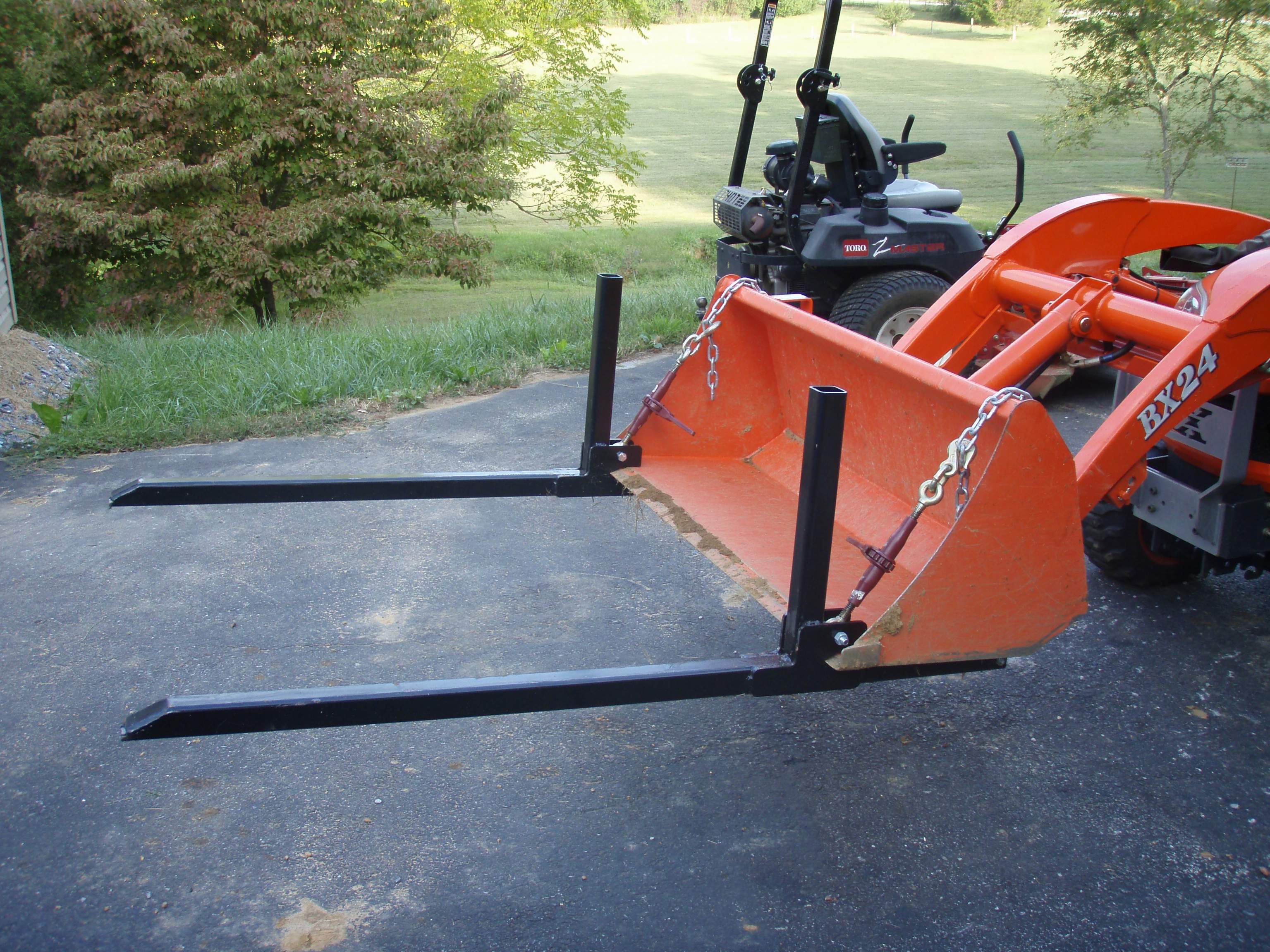

I made a set of forks for my BX24 from .25 x 2" square tubing. The welded area has .25 plate on each side to serve as a doubler and form the pocket for the bucket blade. I use binders to hold the forks onto the bucket and distribute part of the load with the top of the bucket.
I have moved a pallet with 720 lbs of cement with this rig. However, the weight distribution was very marginal.
The upright members make the unit excellent for use as a sawhorse in cutting firewood. I could not do without these jewels.

Nice looking.....How long are the forks?

Nice job kdm0811 :cool: I like 'em ... may just have to build me a set along the same line ;)

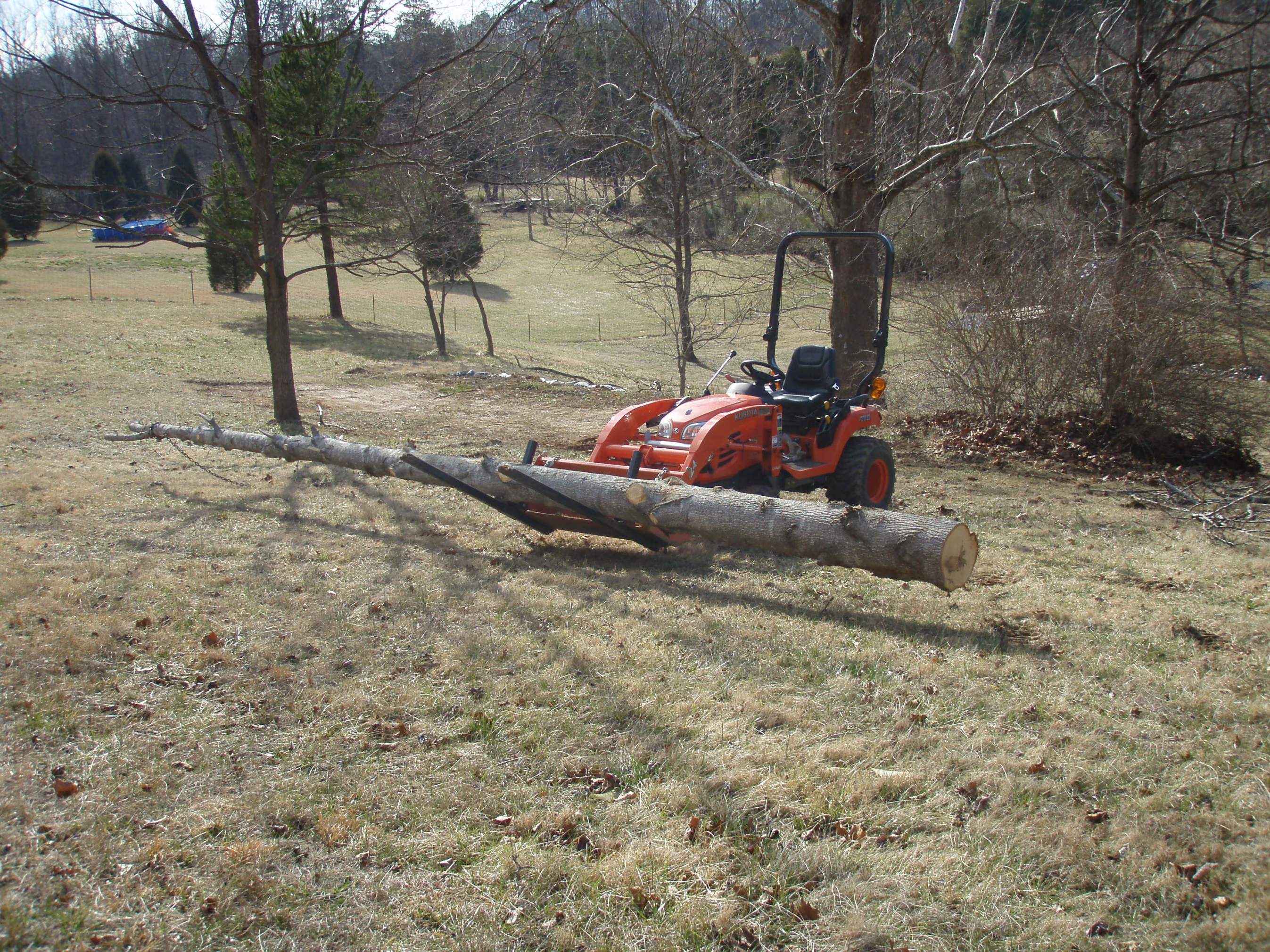

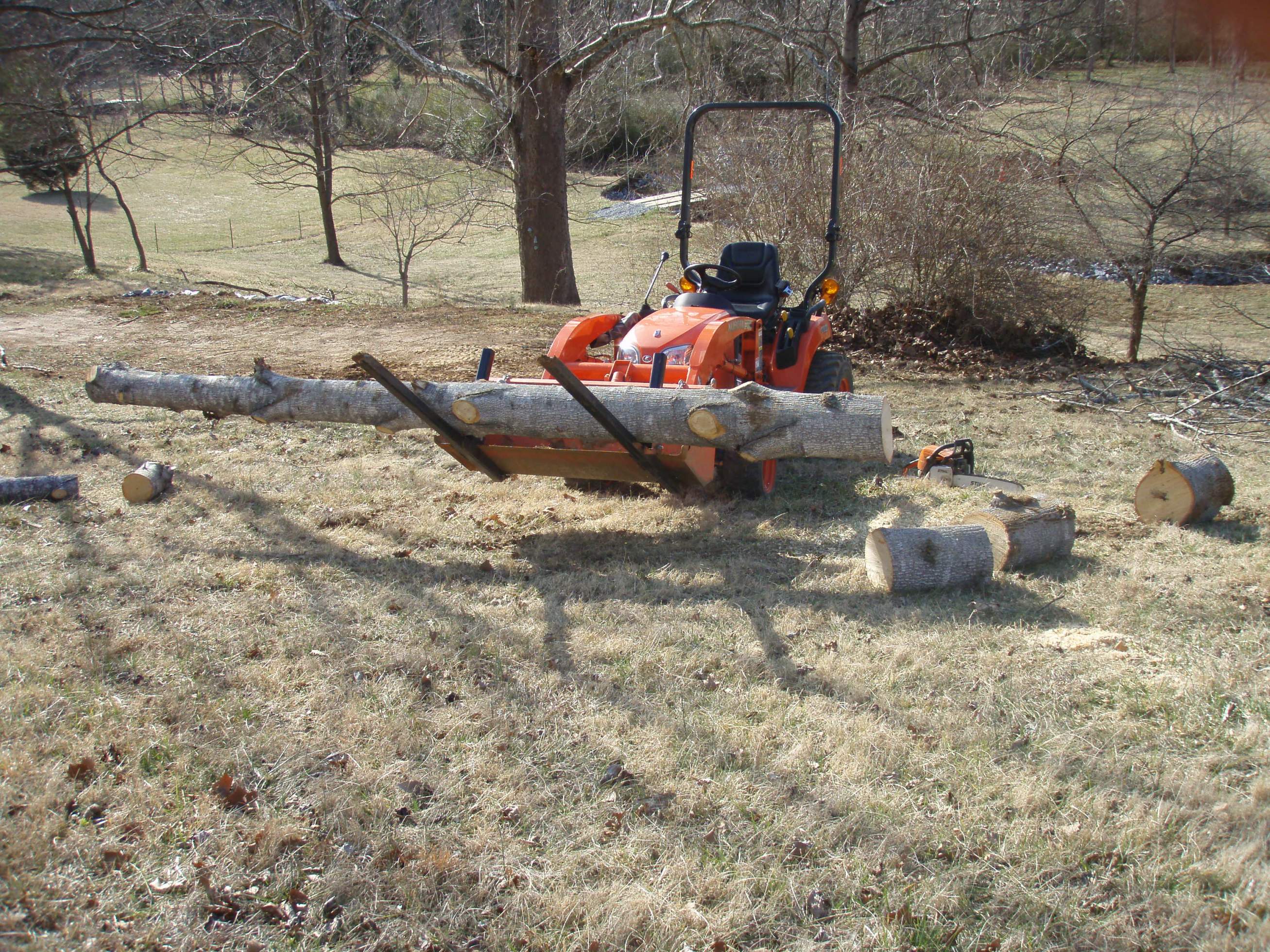

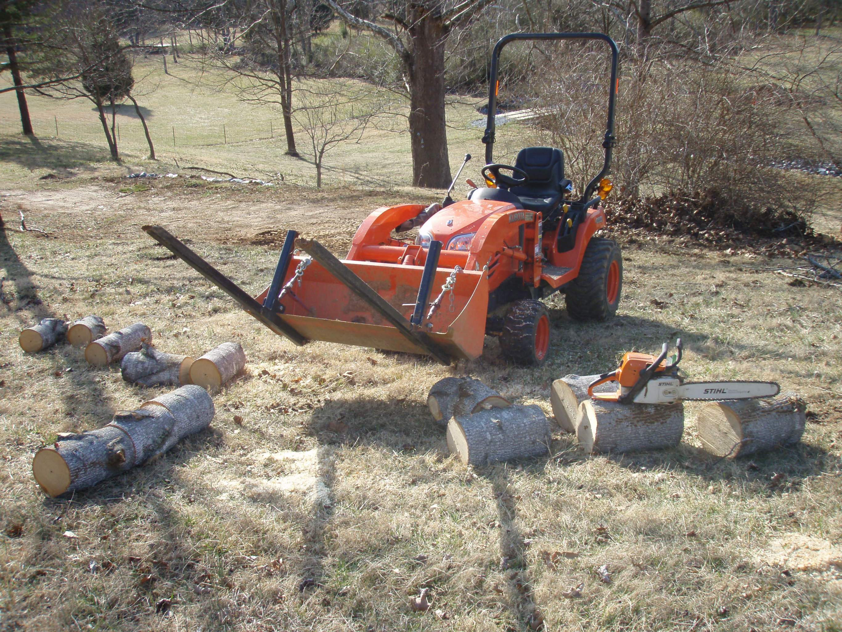

Ruining chain saw chains in the dirt is history with a set of bucket forks.n
