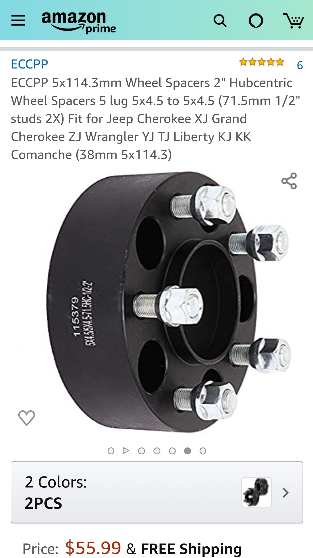

I also put 2 in brotek spacers on my 2008 bx2660, no problems, but one factor someight be missing will be the quality of the studs provided with the " cheaper priced " spacers. And that won't be noticed until a few years later and many wheel removals later .

Given that the weight of a Jeep Cherokee is about double that of a BX, I think they would hold.
Doug in SW IA
/ BX 23s Amazon Wheel spacers #47
Doug in SW IA
Also, the impact suffered by the wheel traveling at high speed on the Jeep is orders of magnitude greater than what the BX wheel will experience...
/ BX 23s Amazon Wheel spacers #48
I see dealers installing spacers on new tractors (even seen it in a Messicks video on a BX with 2" spacers). I don't think they would do it and publish in a video if it was thought to cause issues.
