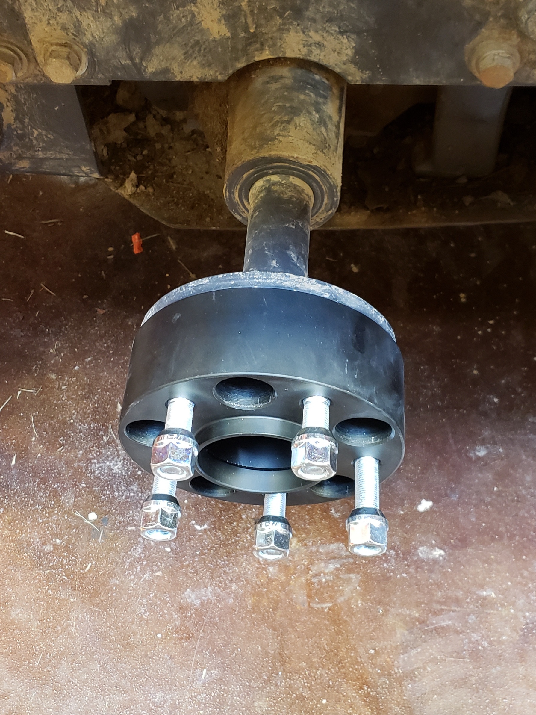

I put the 1.25 inch spacers on my 2004 BX2200 this afternoon. They fit perfectly. Used blue Loctite on the bolts holding the spacers to the hub. In the case of the BX2200 there are five bolts and no studs.
I suspect that since these spacers work on my older tractor, as well as on the BX23s, they probably would work on any BX. But I do not know for certain.

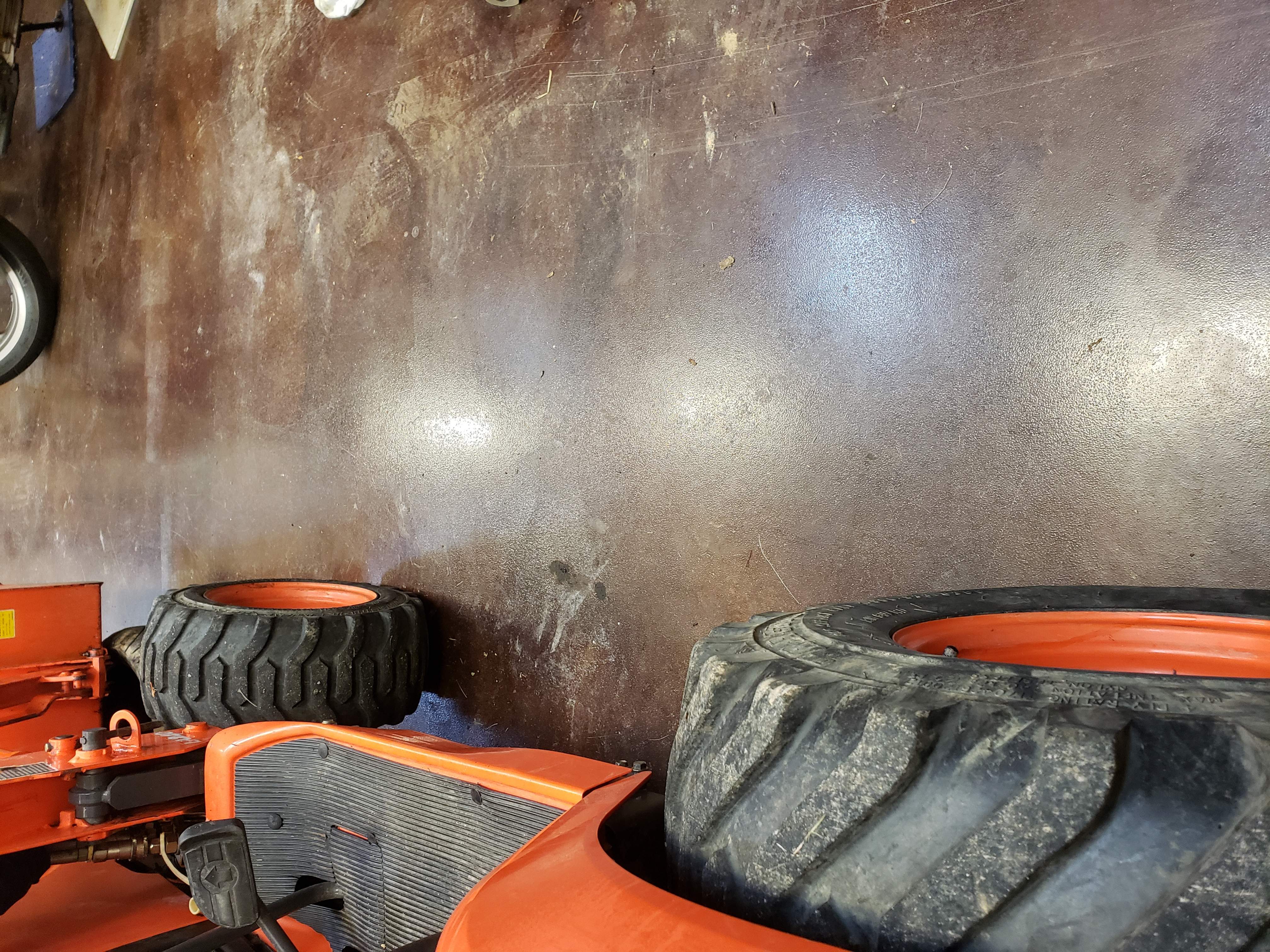

With the 1.25 you end up with the tire about 1/2" from the mower, I wouldn't go any larger to allow for tire deformation on bumpy surfaces.

Bought my new BX 23s last month, it came with the 54" Mid mount mower. I have a long swail on one side of my lawn that has a bit of a pitch and wanted to get some wheel spacers for the back wheels for a bit more stability. I saw all the online higher end wheel spacers, but also read about getting jeep wheel spacers off of amazon. After some research I found that with the 54" mower you are limited to 1.25" spacers (you can see in pics why). So for 1.25" I didn't feel like spending $200+ when amazon was selling wheel spacers for a road going vehicle that is much heavier than my little BX23s. So I searched amazon, found the right sized spacer for the BX and plunked down $39.95 (free shipping w/ Prime). Well, they fit fine and so far so good. I will say one thing, the rear tires filled with whatever liquid they use weigh a deceiving amount! I am a capable guy, but I just barely got those things off the ground to maneuver them- the outriggers on the BH were a huge help to get the tractor at the perfect height to reinstall the tires. Easy install, you will need thin walled sockets - total time less than half an hour.

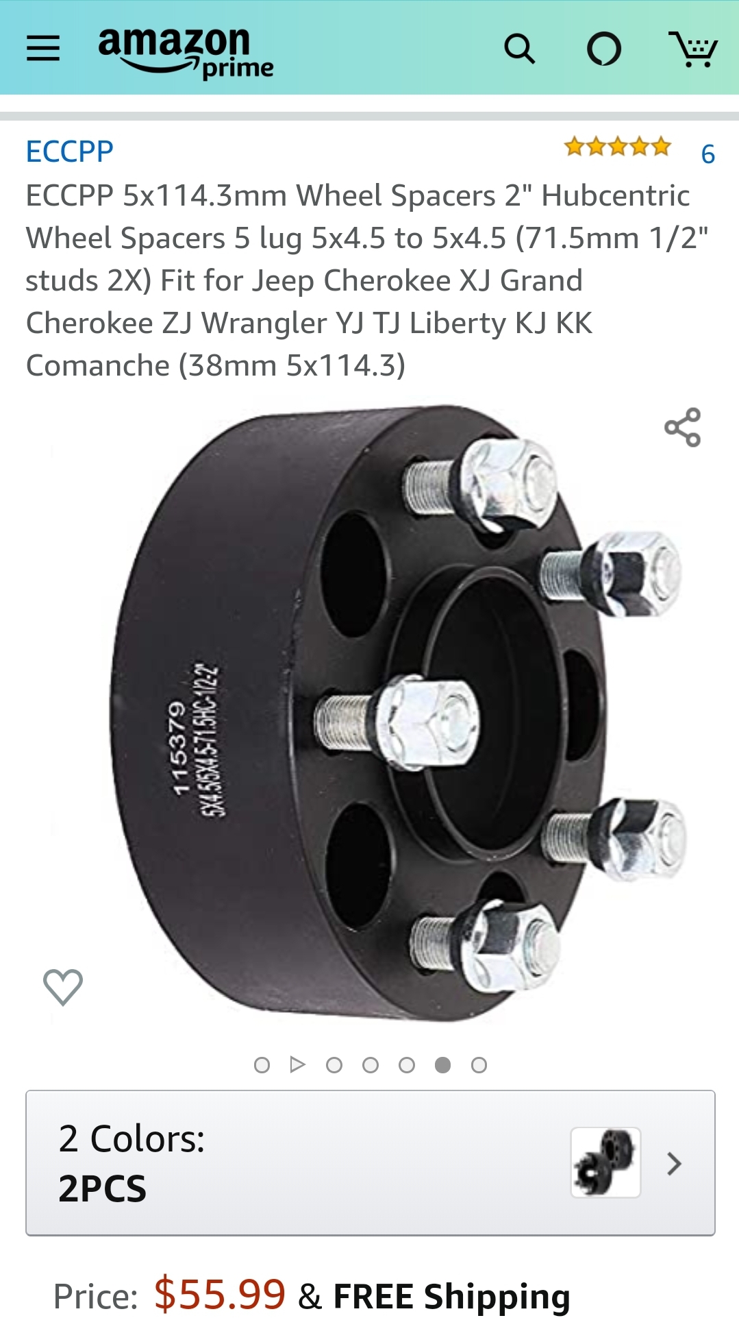

It seems like 1.25 inch spacers are hard to find at least in the quantity of two.

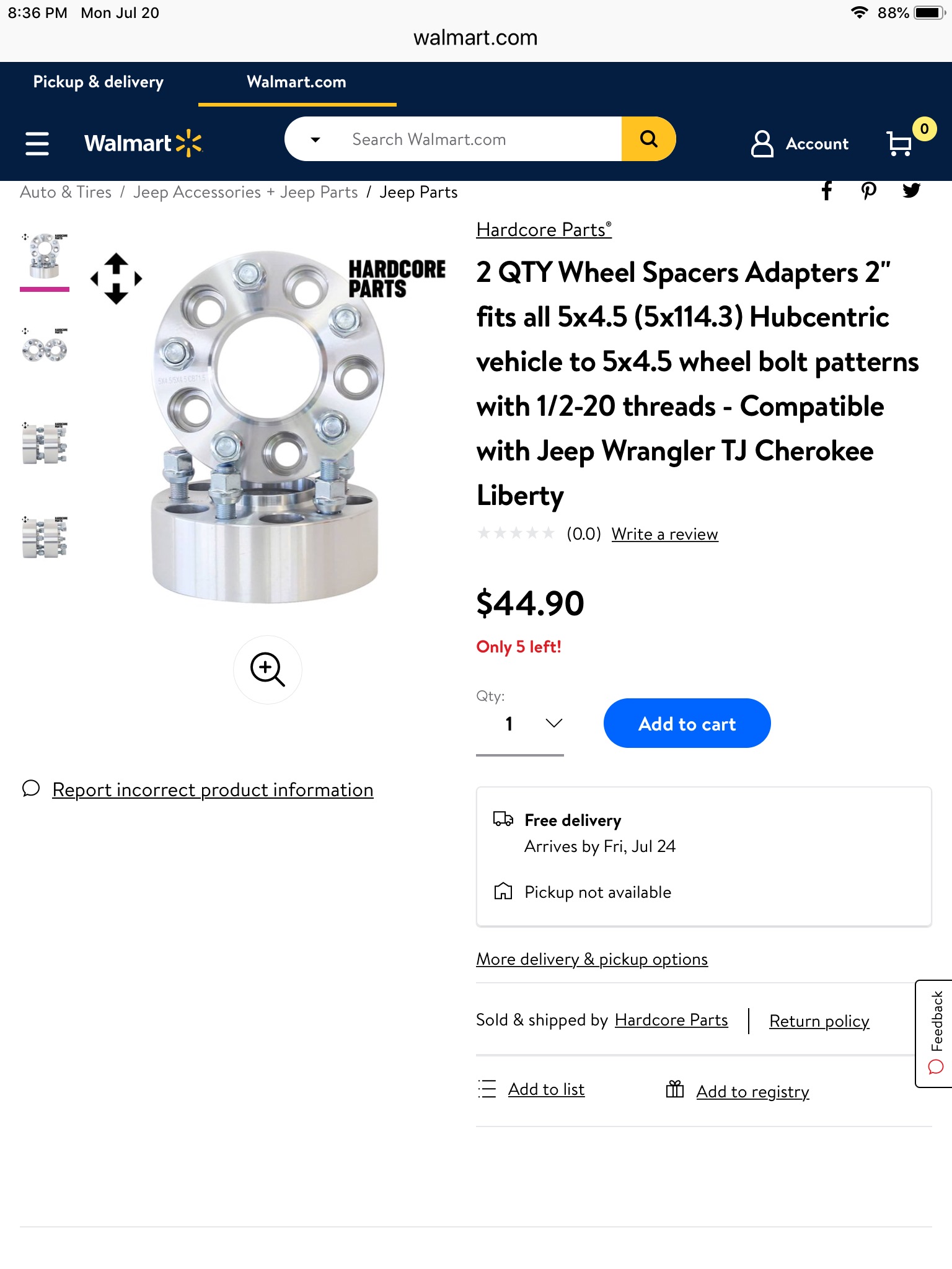

What size are you looking for? I bought the following 2” ones for my son-in-law‘s BX 23S last July and they look to still be available for around $45 plus sales tax delivered free.
2 QTY Wheel Spacers Adapters 2" fits all 5x4.5 (5x114.3) Hubcentric vehicle to 5x4.5 wheel bolt patterns with 1/2-20 threads - Compatible with Jeep Wrangler TJ Cherokee Liberty
2 QTY Wheel Spacers Adapters 2" fits all 5x4.5 (5x114.3) Hubcentric vehicle to 5x4.5 wheel bolt patterns with 1/2-20 threads - Compatible with Jeep Wrangler TJ Cherokee Liberty - Walmart.com
