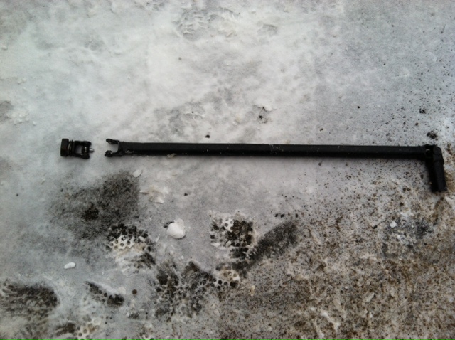

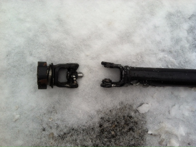

Well, I've busted plenty of shear pins on my gravel road but never a drive shaft. As you can see by the photos, it busted at the joint and because it's a welded piece it won't be easy to repair.
I have the 2410 scut with the 2360 blower. I may try calling the Kubota dealer because my dealer has closed and it's said that they share the same blower with MF.
Any thoughts?

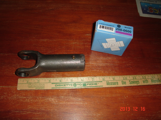

Bill, I just read your post. Ouch! I answered your PM, but I guess the part I have is not what broke on yours. I'd go with the driveline repair shop- I had to have one made up years ago for my '72 Blazer after it was stolen right off the truck in a parking garage in Burlington VT the day before hunting season opened (^%$%^$!!:mad::mad:). Those shops really know what they're doing.
Fun living on a dirt road, huh? After the first major snow & subsequent plowing (yesterday), all those rocks that used to be n the middle of the road are all right next to my driveway & mailbox. Went through two shear pins yesterday, one auger and one fan. Ugh.
Walt
Here's some pics of my driveshaft yoke:

From looking at your posted photographs it looks like the U-Joint gave up. Replacing a U-Joint is not that hard. A drive shaft repair facility can have you up and running again in a few minutes.

Make sure ou didn't mix up the shear pins for the auger and impeller. Auger is grade 5 impeller is grade 8. That can cause an issue. The shaft assembly isn't terrible. $220 or so I think. You should be able to fix yours easy enough. The yoke looks spread but an decent driveshaft place should be able to put matching yokes together and get it useable.

Well, just measured that shaft and where Walt's measures 5 1/2", mine only measures 3 1/2. ON THE TRACTOR GUYS :D
So, I will have to look at adjusting that set screw and shaft or look at that longer yoke.
So Walt, will I need that longer yoke if I extend that shaft out 2 more inches? and will there enough left in the QH side to be safe?
/ Busted Snow Blower Driveshaft #19
Wow, only 3-1/2". That's defInitely the problem. As I mentioned before, I still have the original slip-yoke on mine, and it still works fine.
If you remove the quick-hitch assembly, you can lay it down on its side and see those four set screws. If they're still there, I bet they're loose. You ought to be able to back the screws out a bit --if necessary-- and slide the short driveshaft toward the rear until you have the 5.5" plus sticking out. Then re-tighten the set screws. Note where thread lock is recommended in the service manual.
Hope that takes care of it! Walt

I pulled the blower off last night and low and behold, two of the four set screws were missing and one was loose. Looks like I will have to repair both drive lines now and replace those screws. Not enough hours in the day. lol
