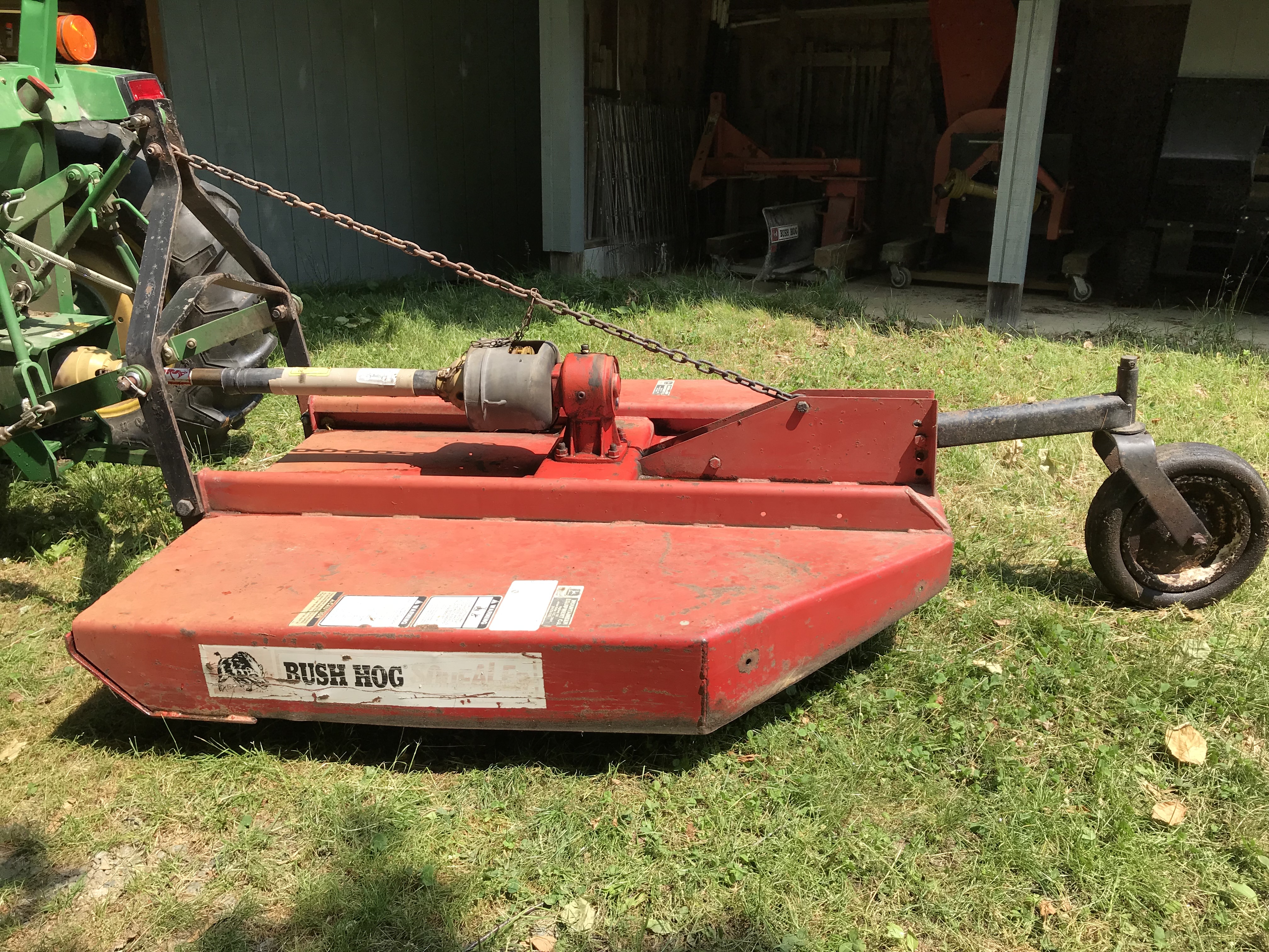

Bolt some guide wheels on it
/ Bush hog #34
Those are guide wheels off a New Holland bale pick up. The black mounting bracket is angle iron. The yellow is the adjustable mounting bar from the baler .
I now have a bigger tractor and a 5' rough cut mower. I use it on trails and rough ground. I bolt a 6" fixed castor wheel from Harbor Freight (plus a spacer board) on the underside of the deck (front corners) to keep the skids from gouging. They last about 5 years.

I’m pretty sure that the body that you see now was all made by previous owner and it appears he included skids on n the front to just be dragged along.
You're talking about the cutter pictured in your first post in this thread? It's a standard Bush Hog SQ from late 1990's. Here's a photo of the one I sold a few years back:
The skids are for when it mistakenly hits the ground, to keep it from digging in too deeply. It's not designed to run on them.
In response to your earlier question, you can see how the chain is supposed to be attached at the top of the 3-point yoke. The top link in this photo is set too short, making the chain tighter than it should be in normal usage. This is a photo I took when I put it up for sale and I had it tight so I could raise it up to take a photo of the under side.

His 3pt leaks down, so wheels would help keep the skids from gouging.
/ Bush hog #37
I've seen suggestions for adding chains to maintain a given height of the 3-point lower arms. Could that be an alternative solution?
Thanks for that, great idea
That is about the only option when running a bush hog with a H. Ferguson 20 or 30. The chains work great, once you figure out what the length must be.
