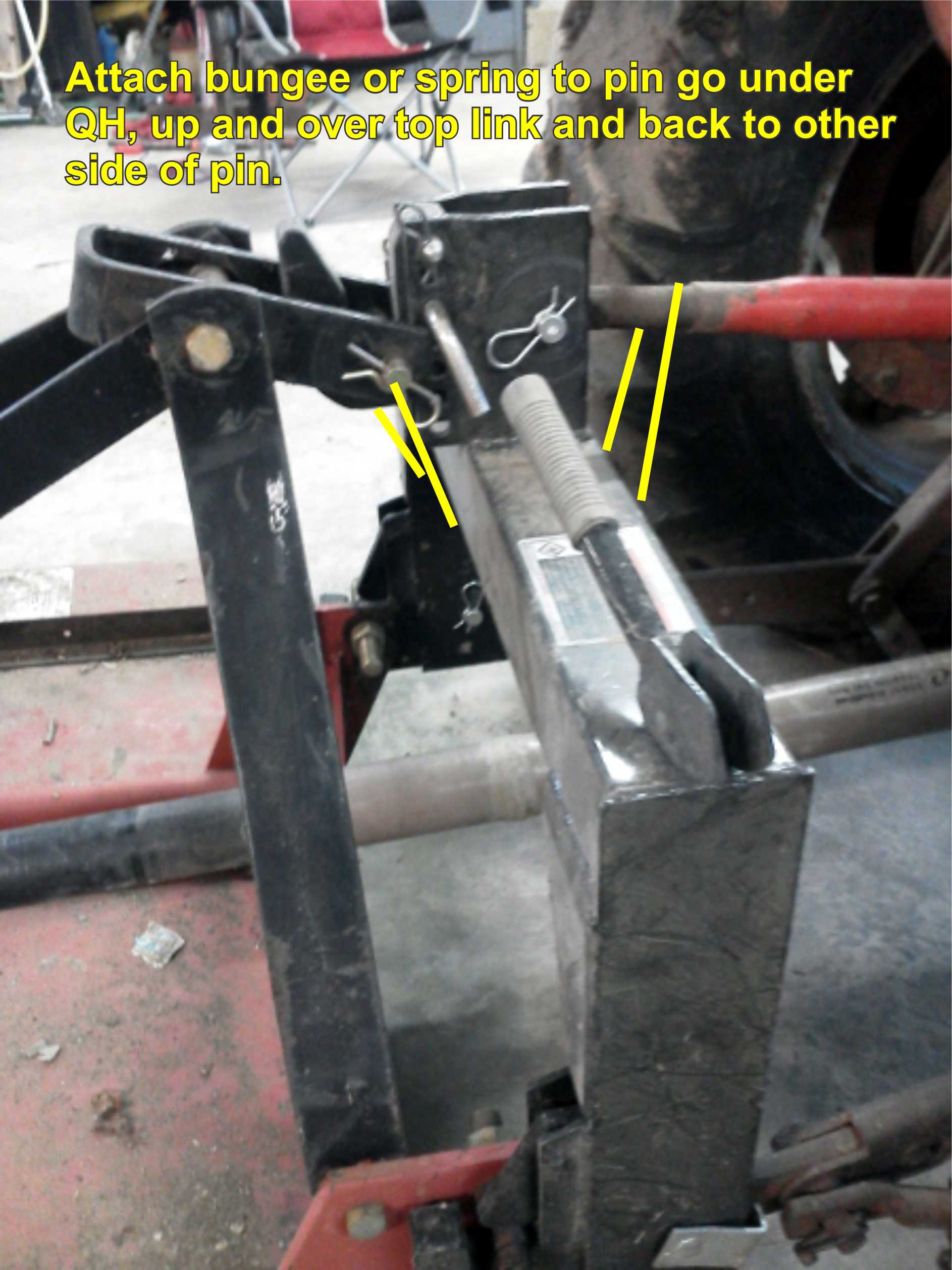

I have an idea,,, How would it work if you attached a spring or bungee cord to keep it from bouncing out. I can see it would be easy to attach to the pin but not for sure where to attach the other end. I'm gonna go look at my mower for ideas
/ Bush Hog top link & quick hitch #15
I have a top link pin that has a ring on the end of it and a linch pin on the other You could hook the end of the bungee on the ends of it and around as indicated and it should keep it from bouncing out. Just an idea...

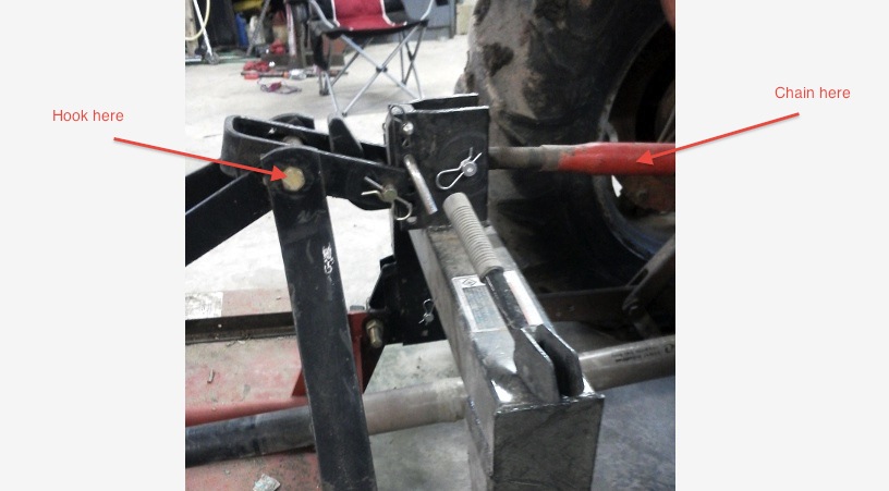

Get rid of the flex link. Hook into the top pin with the QH hook and replace the bars that go from the top pin to the rear of the mower with chain. Do you have a rear remote with a float position? It would be an expensive but handy solution to get a hydraulic top link that you could put in the float position when traversing uneven terrain. Another option would be to get rid of the top pin A-frame all together and run a chain from the back of the mower to a pin in an unused hole in your QH top hook adjustment. How often do you need to pick the mower up? Could you run it only using the bottom pins and not worry about the top? That is how I use my old john deere #5 sickle mower, bottom pins only.
2012-08-09_17-25-50_557 by nickb304, on Flickr
2012-08-09_17-26-45_887 by nickb304, on Flickr
