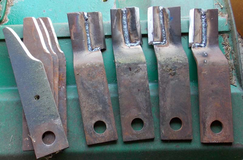

I go through blade faster than I can afford; so last time I just welded new edges on, cut from old used blades.
