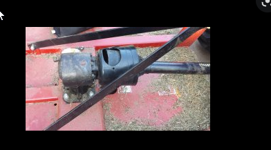

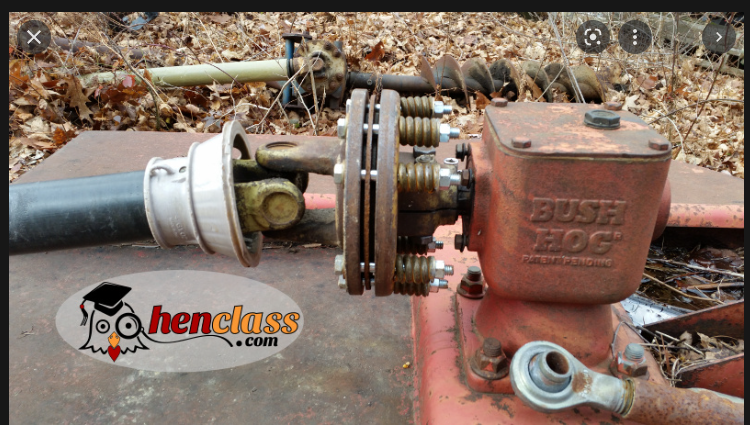

I don't know much about these slip clutch but in my opinion you can't go wrong with a shear pin if it breaks you simply change it its supper easy to change ... with a slip clutch there is adjustment required at some point and If the the clutch gets worn out you have to find parts order it and change it .... but nether should be a deal breaker ... the price sound fair
Slip Clutch
Shear pin ... The shear pin is inside these rubber cone which it simply a bolt.

1.-3. Both slip clutches and shear pins protect the driveline of the mower. Both will do the job. Which one you choose is a personal preference, neither is a deal breaker. Slip clutches have the advantage of being resettable after they slip by simply lifting the mower off of the obstruction, whereas you will have to remove and replace the shear bolt if it shears. A slip clutch that slips heats up and thus won't hold as well compared to before it slipped until it cools down, while a new shear bolt works perfectly. A shear bolt also requires no maintenance, a slip clutch must be kept within adjustment and also slipped every so often to keep it from seizing.
4. A slip clutch will look like the top picture in Rockbadchild's post, although if it is a Walterscheid type it will just have the two discs and no external bolts and springs. A shear bolt will simply be a bolt that goes through the implement side of the PTO shaft and the gearbox input shaft- the telltale sign for a shear bolt is there will be no fat slip clutch anywhere in the driveline.
