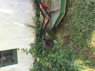

Ain't too crazy or may it's too crazy. Anyway it won't pivot...it gets sideways and trys to be a plow. Dang thing will pivot easily by hand when not on the ground.
Does the angle look to steep? I'm beginning to think it has the wrong wheel on it. I bought it used.
Don't know why the site turns the pic sideways.

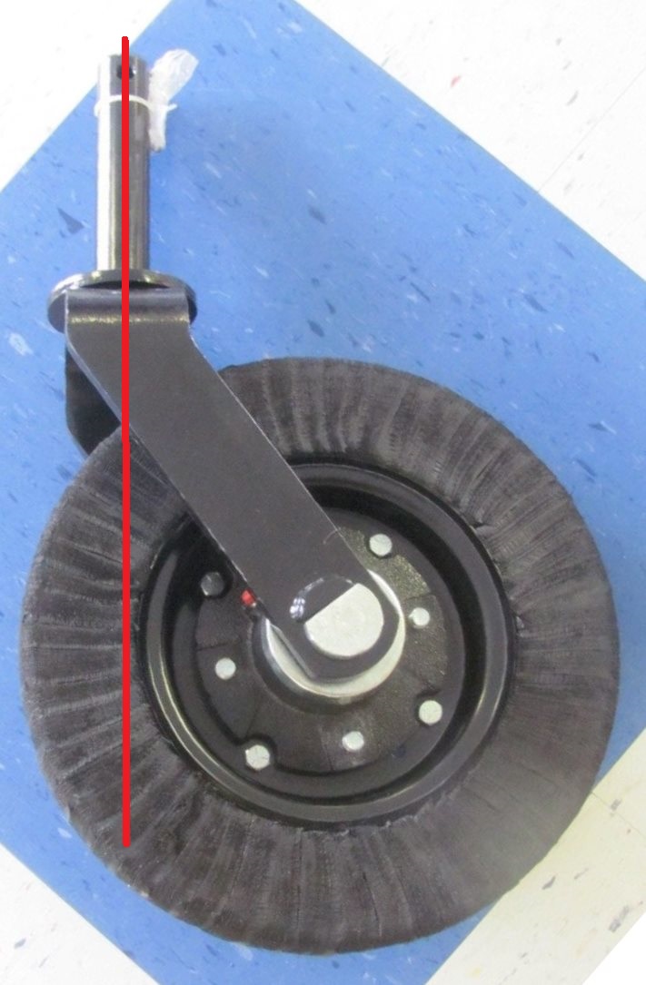

It should be offset so that the centerline of the wheel is behind the centerline of the pivot "axle" (like a swivel caster wheel).

The only thing I can say is that the pivot has too much castor angle. I think you're right that someone has used a universal replacement, as it looks to me that if you reversed the wheel would contact the mower body.
/ Bush hog crazy wheel.... #5
Aczlan is correct. Does not appear to have any caster angle. The pivot point should be vertical and the axle should be behind the pivot. That fork is wrong for that cutter & the pivot is bent.
/ Bush hog crazy wheel.... #6
Yep.. The fork angle is all wrong.. Should be more raked back with the wheel axle behind the pivot.

Here is a picture of one with the correct angle (the pivot for the wheel swivel is marked with a red line in both pictures):
Note that the line is off center on the wheel. That way it will swing around to follow the tractor's direction of travel.
Here is the line drawn through the same place on your mower.
Note that the line goes through the center of the wheel. That makes it so that it does not naturally pivot to follow the direction of the tractor.

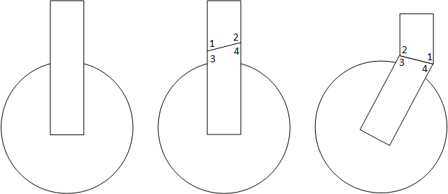

I would attempt a repair by cutting the vertical straps off of the stirrup and then cut a 45 degree chunk out of each vertical piece, then weld the vertical pieces back to the remainder of the stirrup. This should give it some rake angle. No real cost involved, just some time and one welding rod.

I would probably make one cut at a less extreme angle (20 degrees?), then flip the cut pieces around front for back (so it goes back together at an angle rather than straight) and weld that together.
Only one cut/weld vs two that way.

I've even got a diagram :D:
The diagram uses a 15 degree cut for a overall angle of 30 degrees once you flip the cut piece around.
Aaron Z
While I completely agree with the wheel axle point needing to be behind the swivel point, I disagree that the swivel point should be true vertical. Mine, and meny others have a few degrees of tilt, to allow the tail wheel to slightly lift the rear of the mower deck when in reverse, and ride closer to the ground going forward.
