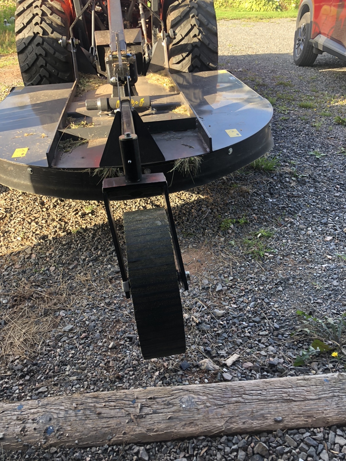

New to bush cutting. Bought a new mk martin bushhog. Works great but as I went forward to reverse I watch the wheel swivel and I thought that the crazy wheel frame is going to bend. I tried picking up the bushhog when changing direction but I forgot sometimes. It bent. I’m pounding it back straight.
Anyway I’m thinking of reinforcing it so it doesn’t bend but I’m thinking I may weld something so the wheel does swilvel 360 degrees. When I’m backing up I’ll just keep the wheel off the ground. Do you think this will work? When you change direction do you let the grass eventually swivel the wheel then drop it to the ground or do you just let the wheel stay on the ground and let the wheel swivel happen at full weight and pressure?

I never lift the BH when backing up. The wheel should swivel as you turn. When backing up, it should flip around 180'. Have you greased the grease fitting to make sure it swivels easily?

Agree. I seldom lift the cutter when I’m reversing and often mow in reverse when necessary in tight spots. As you said, keeping the rear wheel spindle greased is important. Also, not hanging it up on immobile objects such as stumps. (Ask me how I know,) I just had to repair my tail wheel mount and swivel myself when I hung it on a stump and tried to power my way through.

1. Are you greasing the zerk on the spindle every 8 to 10 hours of use?
2. Does the wheel assembly (vertical shaft) rotate easily with a full 360 degrees when the mower is lifted?
3. Looking at the photo specifically at the top of the wheel: it looks like the wheel assembly is bent slightly, so the wheel camber is not vertical top to bottom.
It appears to be a larger gap on the top left side vs. the top right side. It's possible the wheel may not be running 100% straight up and down. Not sure this would contribute to the problem...just flagging a possible contributor...or it may just be the photo angle skewing the view.
4. I'm trying to get my head wrapped around the overall design. It appears that adjusting the angle of the strut holding the wheel assembly is used to set mowing height(?).
Thinking out loud...(which is dangerous)...if the strut was parallel with the ground, the wheel assembly should be able to rotate 360 degrees on it's axis without any significant change in force required.
The more angled the strut is, the more force would be required for the wheel assembly to rotate away from running in the straight forward position. Reverse position would actually require additional force, sufficient to lift the deck higher as the wheel assembly rotated into the full reverse position.
As a test, you might try to simply adjust the strut to be parallel with the ground and the deck. Then drive the tractor forward, try turning and reversing to see if the wheel assembly rotates 360 degrees freely with no issues as you would normally expect.

As long as the wheel can spin and the wheel assembly can rotate 360 I would not worry about, grease it every time you use the cutter and just keep on mowing. Tail wheels are not precision I have seen a lot of cutters with tail wheels that are not perfectly in line with the pivot point. That lightweight tail wheel assembly is just poorly made from weak/thin metal

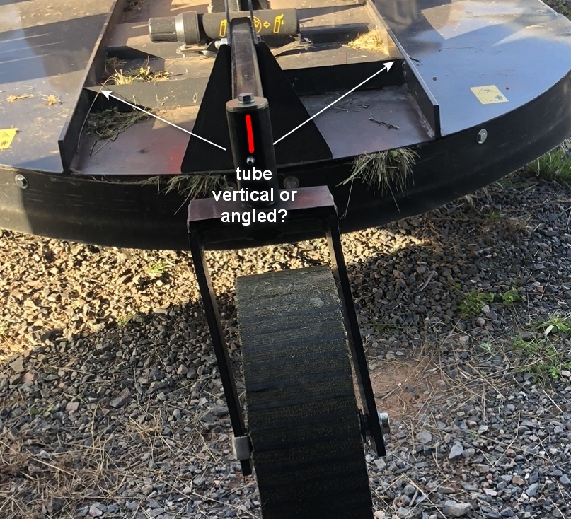

Many of the tailwheel assemblies I've seen are attached by triangulated frames to resist bending (white arrows).
Also, is your pivot tube entirely vertical or is it set an angle?

Do you have a side view photo of the rear wheel assembly? It looks like it does not have any caster built into it.

The tailwheel looks to have a more extreme rake to it than I'm used to seeing.

Lift the cutter with the tractor and check that the wheel can rotate 360 degrees. Usually there's a visible gap on the shaft above the wheel between the tube the shaft rides in and the retainer on the top. From the pic it looks like the retainer on the top is right down on the tube. If that's true it may be why the wheel is not swiveling when you back up.
The bent wheel bracket shouldn't affect that but once you figure out the problem it's probably worth bending it back into shape.

Looks like the yoke is just a narrow flat strap in the picture. Not a very robust piece of that's the case.

I agree, the design looks weak at the top. The legs of the wheel Fram are too long without any support to prevent racking.
I would weld a piece of 1/4" flat steel across the top front of the wheel frame to act as a gusset for both of the vertical wheel mounts.
Make it as wide as you can and still have clearance for the wheel.
It should never bend like that again.
If you want to really overkill it then weld a gusset on both the front and the back of the wheel frame.
