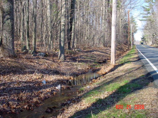

JimR said:
The ditch is only 32" deep. It is a little bit short of the 36" minimum that I need for a 24" pipe. I will have to dig it out a little bit to get at least a 12" cover over the top of the pipe.

Here's the area that I need to put the culvert pipe into. I just measured the height of the road from the bottom of the ditch. The ditch is only 32" deep. It is a little bit short of the 36" minimum that I need for a 24" pipe. I will have to dig it out a little bit to get at least a 12" cover over the top of the pipe. I was hoping that I wouldn't have to dig it out. Oh well, at least I have until next summer to dig it deeper. I cannot mess with this now as the water runs into a drinking water resevoir. I do believe as mentioned by Egon that the secret to success is to campact the soil as much as possible around the pipe to shift the load to the banks instead of the pipe. I won't be using this road for at least a year after it is done. I want it to settle fully before driving over it. I do have the proper permission from the Con Com, DCR and Highway Dept. to install this pipe.
Holy cow! Utility poles close to the roadway between the roadway and ditch! Yikes!
That's how they are done around here and everywhere else in N.E. Over the last 30 years I have pulled at least a dozen vehicles out of this ditch during the wintertime when there is snow on the road. Not one of then has hit a pole yet.

The picture I posted of the ditch is on state property. That road is a state numbered route. The state owns 20' on each side of the road. The town maintains the ditch and road. I had them dig this ditch out years ago. The road was built up with wall stones many years ago. Water would flow under the road and into our front yard during heavy rains.
