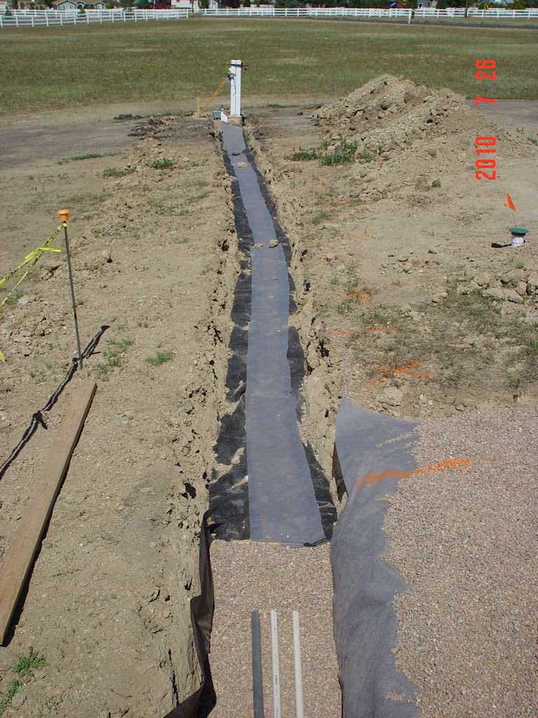

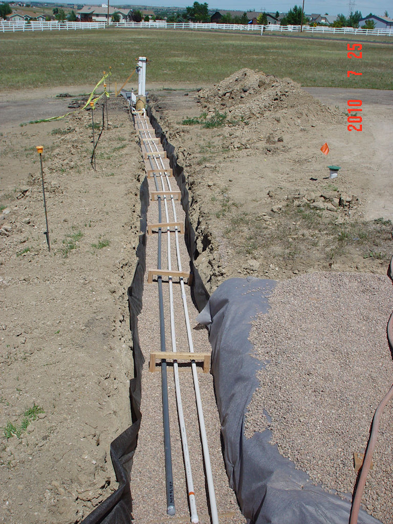

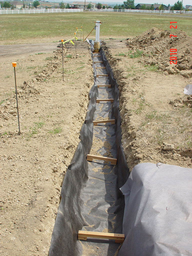

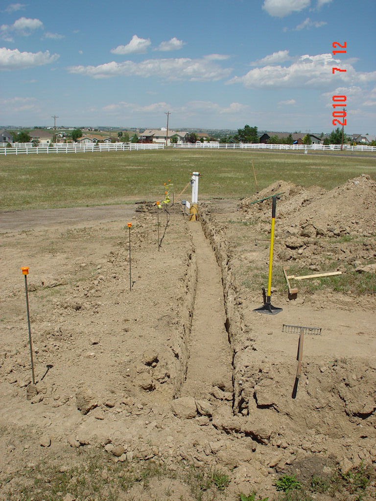

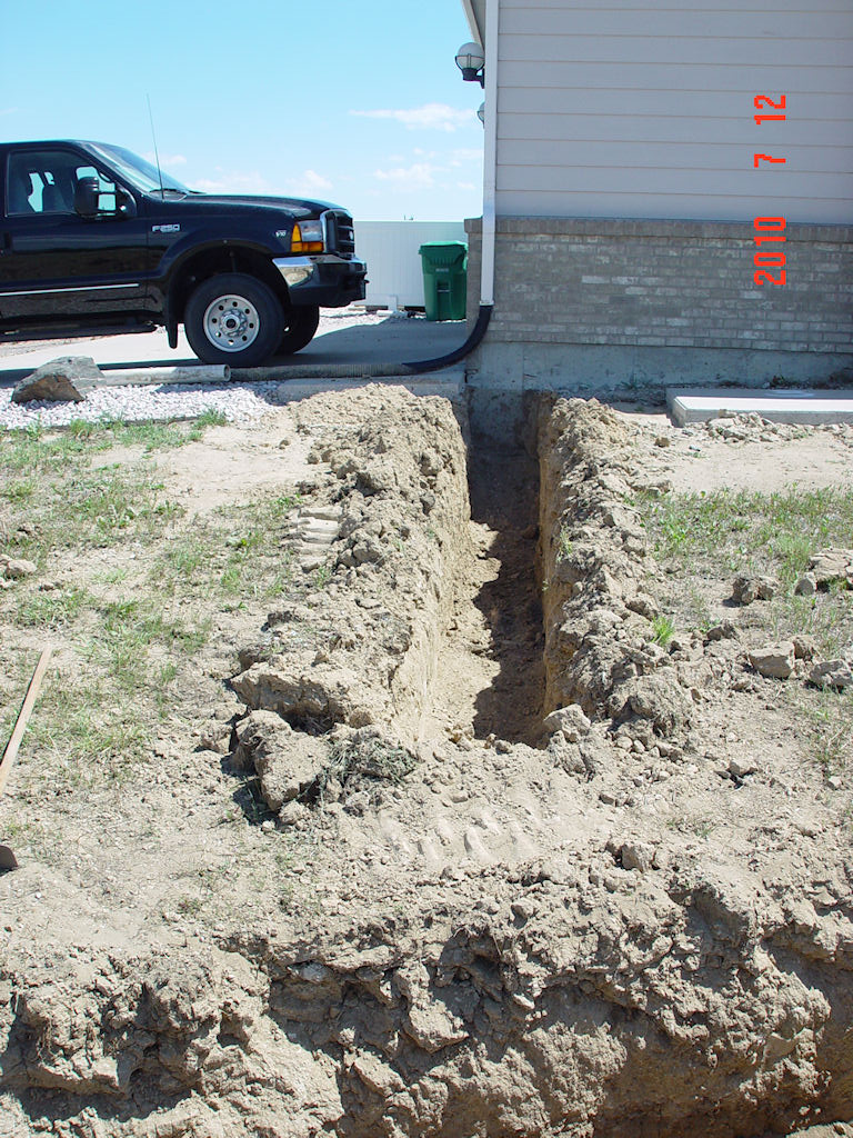

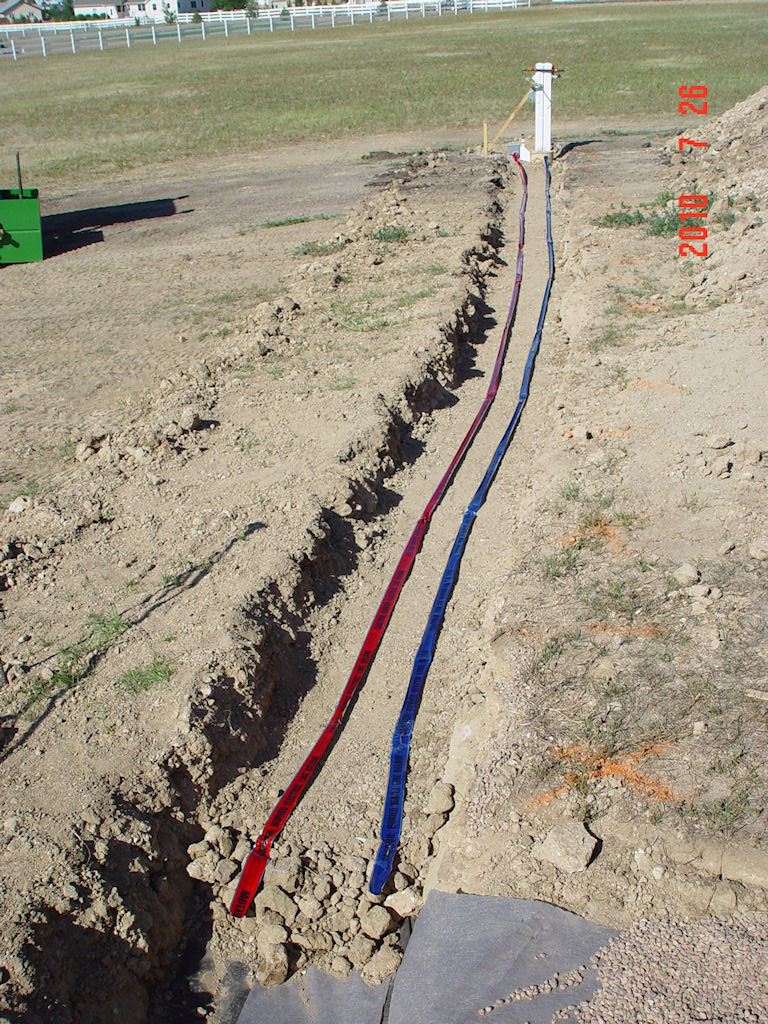

The following are some pictures of my recent trenching and pipe laying efforts.
The first picture shows a freshly dug trench, which I always dig too deep in spite of my best efforts not to. The second photo shows native dirt backfilled into a trench and brought to a consistent 24" depth below grade. The third photo shows a weed fabric (who knows how long it will last) lined trench with 3" high chairs placed every 5' to gauge the pea gravel depth. The fourth photo shows the 3" pea gravel bed, conduit and pipe (Yes, I know I'm bad for co-locating water and electricity in the same ditch; but face it stormwater gets in conduit all the time. Yes, I know SCH80 pipe is called for under drives; but I'm not concerned as this is a residential driveway.) Additional 5" high chairs provide a minimum of 3" of pea gravel cover over the pipes. The fifth photo shows the final layer of pea gravel. The sixth photo shows the fabric covering the pea gravel. The seventh photo shows the first 8" lift of compacted native soil backfill and detectable marker tape. I don't have the photos downloaded from the camera yet; but the trench is backfilled with the final 8" lift and is compacted. There will be 4" of crushed concrete driveway going over the trench too.
