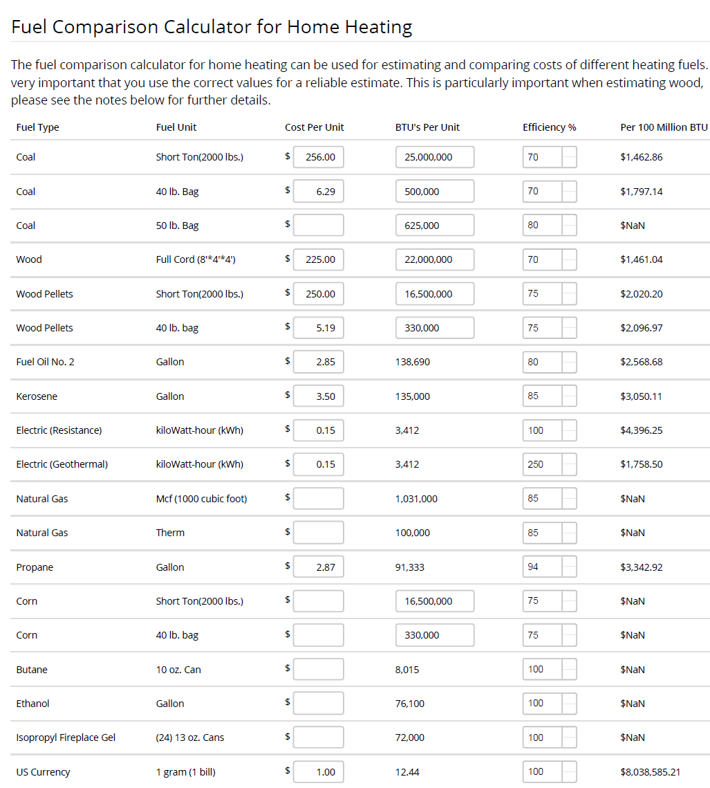

Not a common method of heating here. Just for grins I googled "coal dealers near me" and got 3 hits, 2 of which were 2+ hours away. This compared with 9 for fuel oil, all of which were within 25 mi. or so. Maybe it would be different in/near coal country.
What about cost? Is the price comparable to oil or pellets?
You would be surprised at the number of coal dealers in NH, they can be a bit difficult to locate.
I have attached an energy calculator link, Fuel Comparison Calculator for Home Heating | Coalpail.com
And if this will enlarge to be readable a clip from that calculator, the price is better then pellets and much better then oil.
