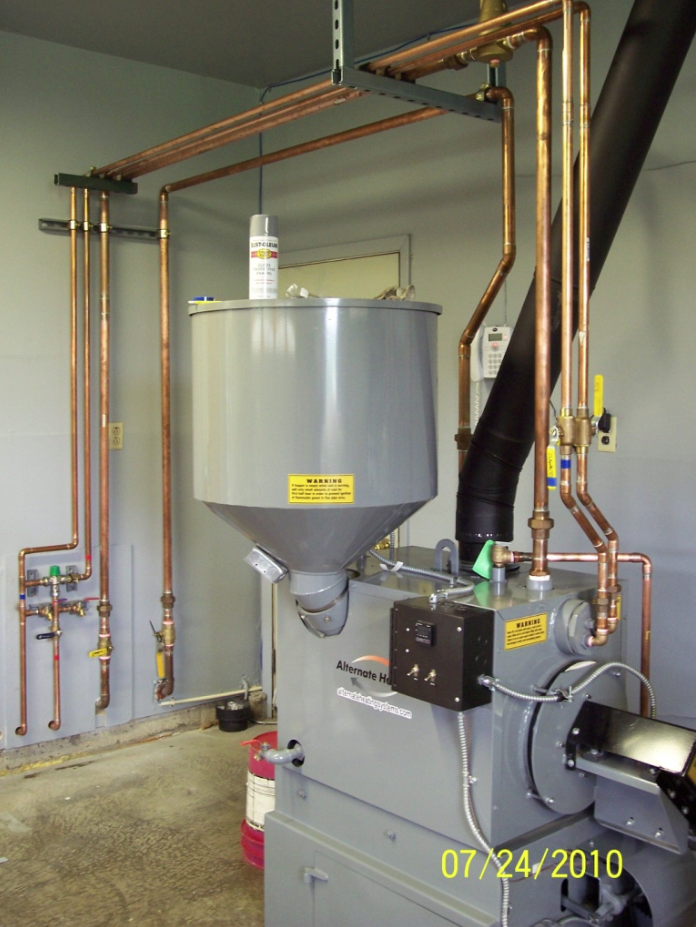

When I broke the news to the first lady that I was installing a coal boiler in the house, the wife said not in MY house, you're NOT. That summer was quite tense while I worked on my pet project and ate cold baloney sandwiches for supper many nights. Screen Shot 2018-11-24 at 10.59.05 PM.png
She quickly changed her attitude after that first winter and now is a bigger advocate of the coal than I am.
That was 8 years ago and my only regret is I didn't do it sooner. I burn an average of 4 tons and my average cost is about $240/T delivered to heat 1800 sq.ft. of living space.
An added benefit from that is I get to use the tractor & FEL to bring coal into the garage and dump into a stock tank (on wheels) once a month.:cool2::tractor:
/ Burning coal #36
When I broke the news to the first lady that I was installing a coal boiler in the house, the wife said not in MY house, you're NOT. That summer was quite tense while I worked on my pet project and ate cold baloney sandwiches for supper many nights.View attachment 580260
Nice looking unit and install,
nice to have a fuel that doesn't care where it's stored,
brush the snow off, let most of the water drain off and ready to go.
I use the 40# bags in my insert, pickup a pallet with the forks,
carry it up to the house stack 20-30 bags away handy, I dump
the bags into 5 gallon plastic buckets and bring in two buckets / bags
at a time, shake the ashes down once a day and refill with a bucket or less / day.
Hard way to get a lot of my heat, no cutting, spitting, stacking, curing :drink:
