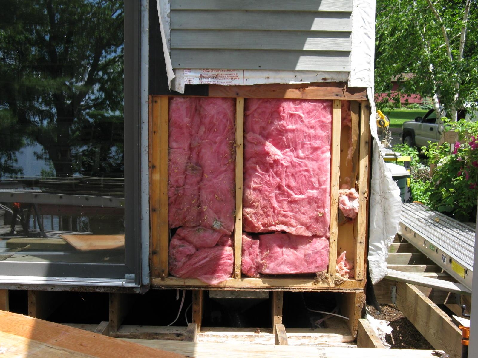

the "ledger" board was attached OUTSIDE the siding. there were thin...maybe 1/2", spacer boards in the valleys of the siding so the ledger didnt"crush" the siding. After the spacer boards were nailed on, the ledgers were lagged to the house.
Still didnt like that method. Bunch of holes in the siding where the lags go through, moisture can lay between the house and ledger, all kinds of bugs and critters build nests back in thee, etc.
I like free standing. Both work. Both work well. Just have my preferences is all.
   / Built two decks this weekend #26
Deck ledger board attached to house rim joist. Poor flashing details = water damage and rot to the house rim joist. Not much fun to repair. I like the free standing deck method.
