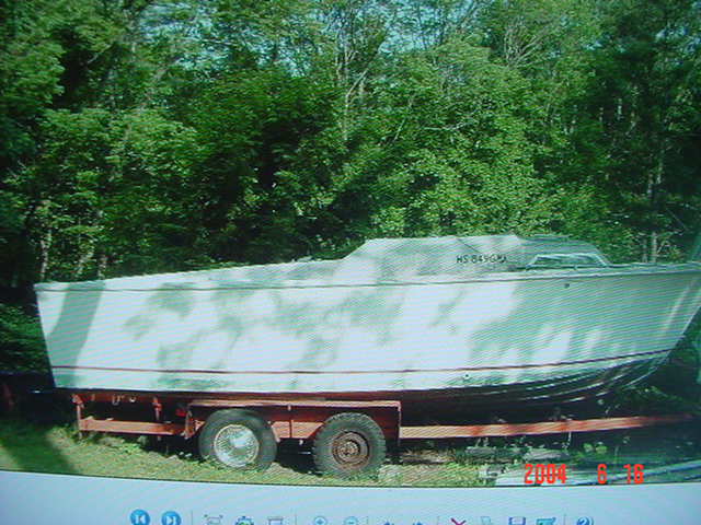

My flatbed has the mobile home axles all 102inches of them, I bought it used and it has been a good trailer.
The brakes are junk. I have been able to replace the components with new parts from a Hudson trailer dealer.
The mobile home use only tires are junk (for a trailer that is used frequently) and will earn you a fine around these parts. But you can replace them with Load King LowBoy heavy duties (AN excellent DOT tire) also there are better rims with a "bump" which prevents rotation if the clamps come loose.
I bought this trailer soon after I decided to make money with the tractor and I was still a little green /forums/images/graemlins/blush.gif, if I knew then what I know now I would have passed on the mobile home axle setup in favor of six or eight lug one piece truck type wheels.
I bought the trailer building books (vol 1 and 2) from Northern and have found them worth it though the author has a fetish for the goofy offset tongue "step neck" couplers.
