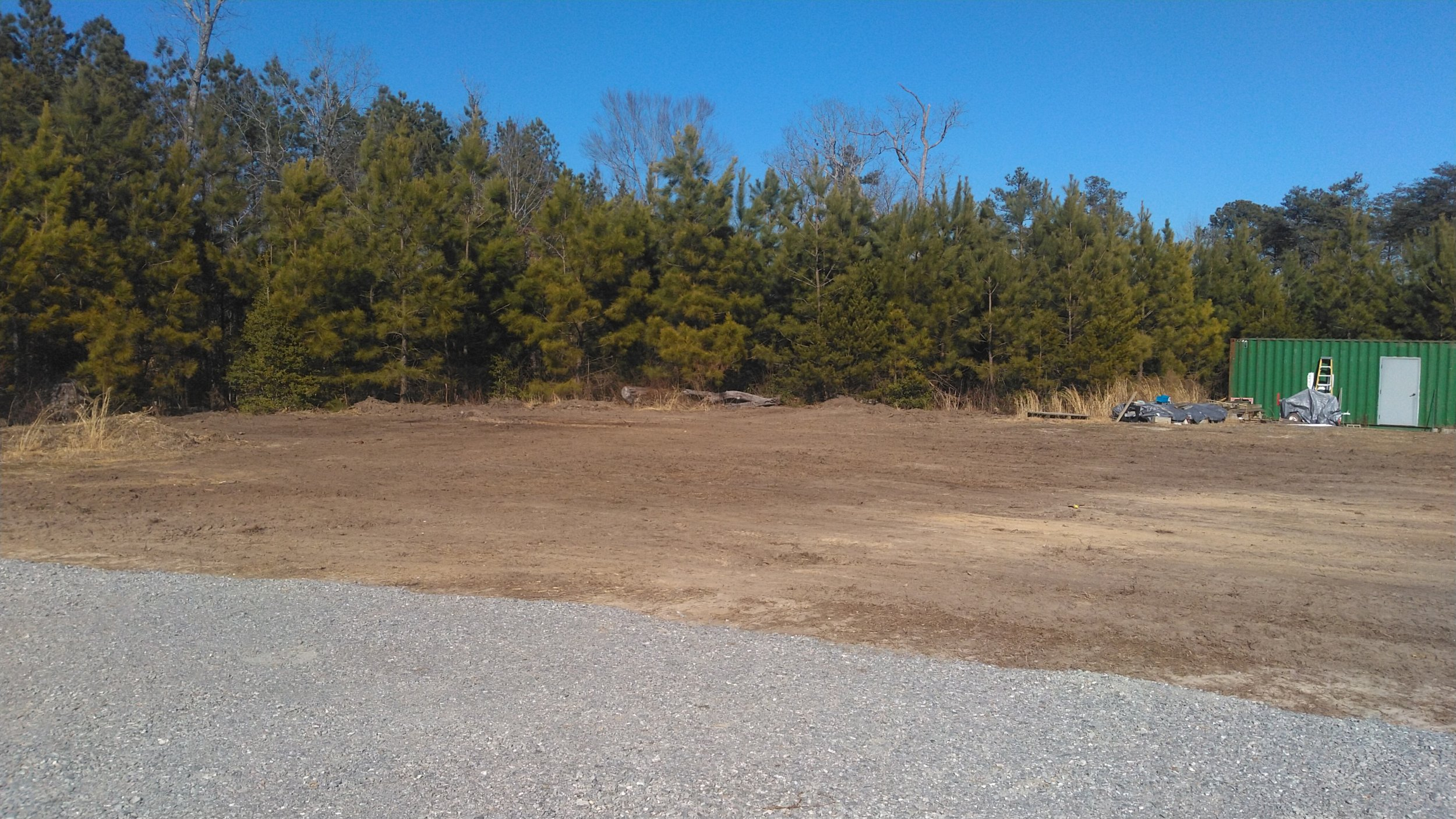

I had the same issue. Bought a shipping container and put a door on the side of it. It is portable and they cannot say anything about it. I am still using it and built shelving in it for storing boxes and plastic containers. It does get hot in there but CT. might not be as bad as down here in VA. I also have a work bench in there.
/ Building Shop before House #12
I had the same issue. Bought a shipping container and put a door on the side of it. It is portable and they cannot say anything about it. I am still using it and built shelving in it for storing boxes and plastic containers. It does get hot in there but CT. might not be as bad as down here in VA. I also have a work bench in there.View attachment 743697
This ⬆️ is the best idea so far. Get a building permit for the house you want to build and have a power pole set to supply the building site. Then drop a container with a door and power it as the building office, then put the project on hold due to budgetary constraints.

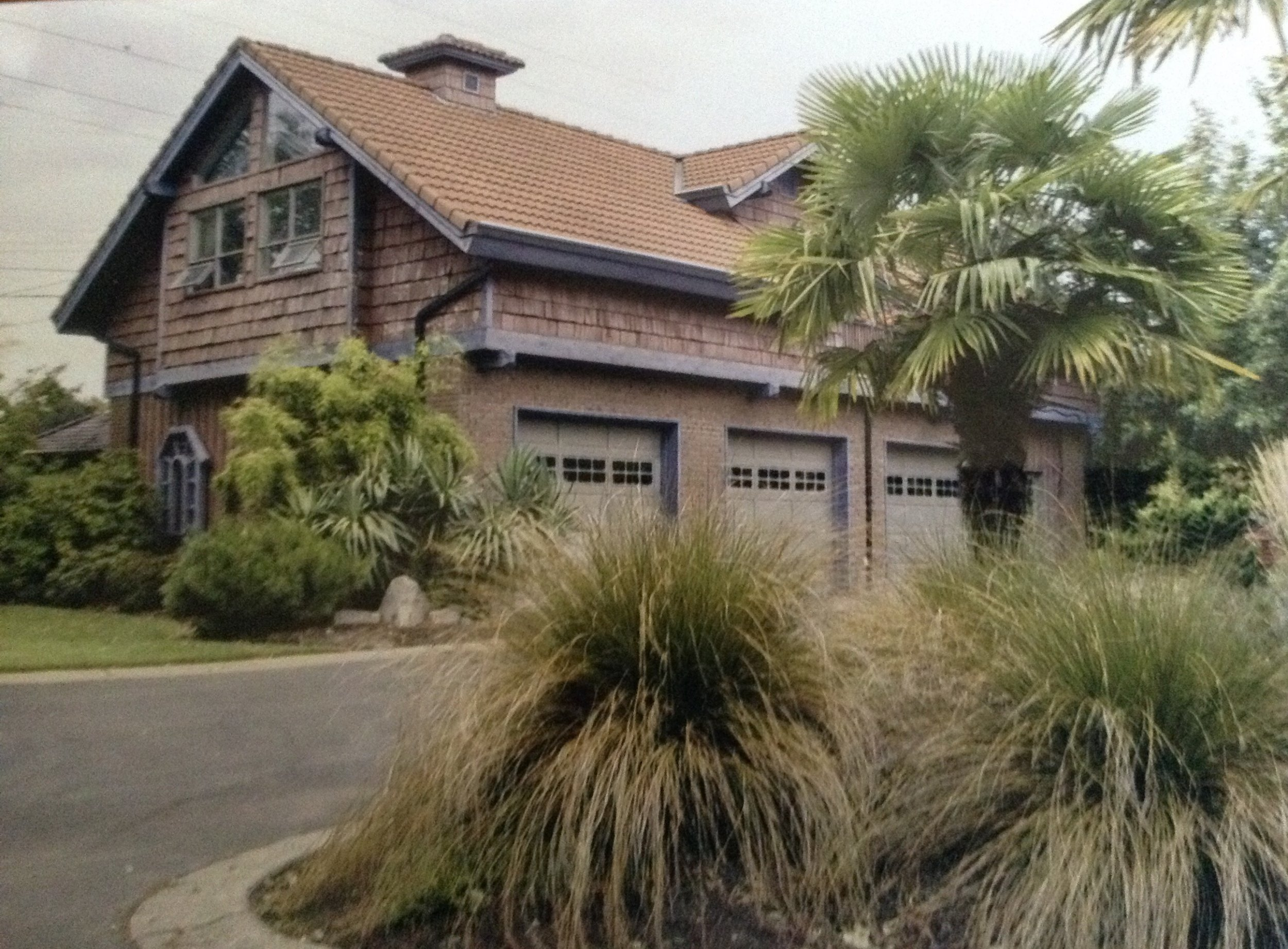

I built my garage a full year before my house
in my case, local bylaws would prevent me from using for commercial use anyways.
