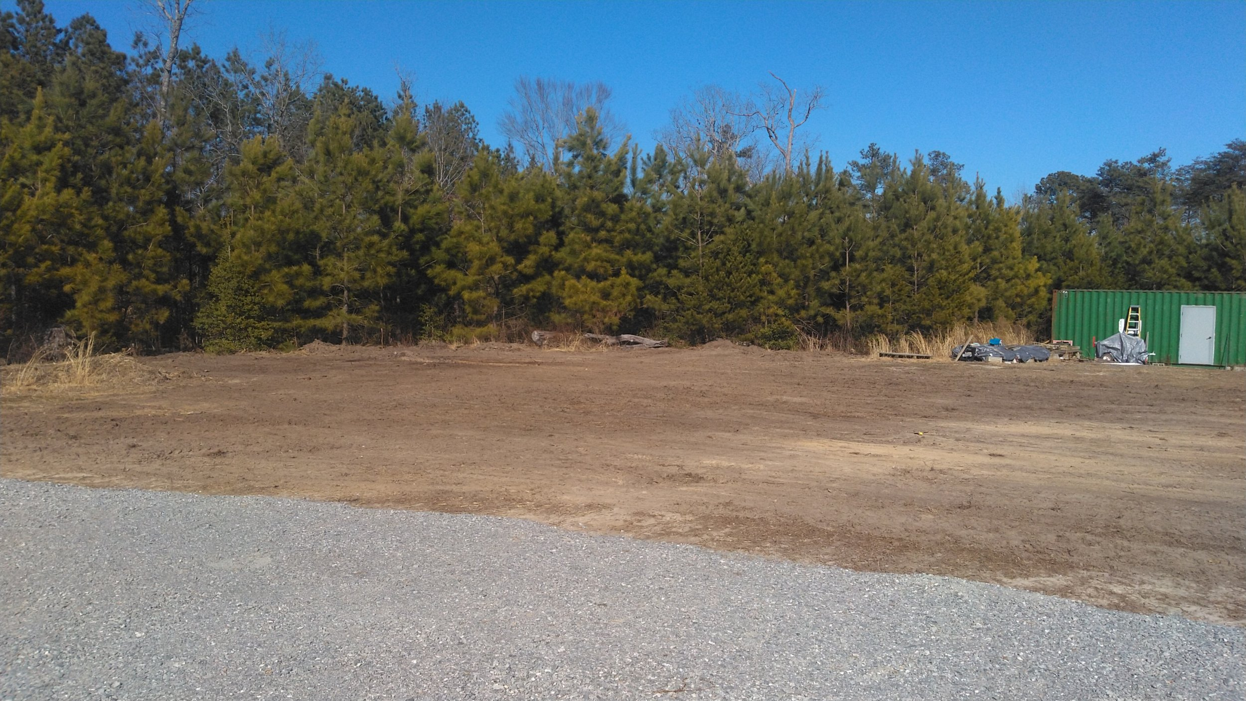

I had the same issue. Bought a shipping container and put a door on the side of it. It is portable and they cannot say anything about it. I am still using it and built shelving in it for storing boxes and plastic containers. It does get hot in there but CT. might not be as bad as down here in VA. I also have a work bench in there.
