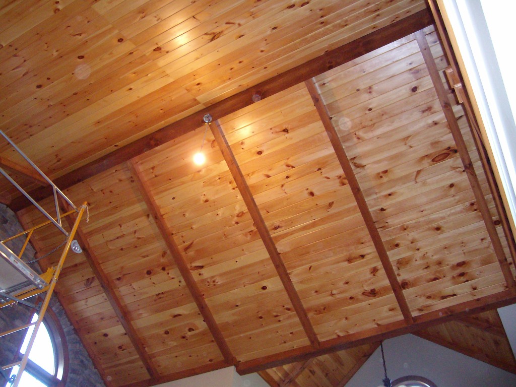

I do have another question :)
We will be installing a wood ceiling. This will run the entire length of the vaulted roof - covering the front/rear porches and the great room.
We see this is normally done in pine, so that is where we have been leaning. The wife, however, does not like the busy look of a ceiling full of knotholes. So, we checked out "clear" pine as an alternative. The basic stuff,in 1x8, is about 65 cents per linear foot. The clear is about $5.64 per linear foot. We will be installing close to 4300 linear feet of 1x8.
The question - Is there an alternative? Can I find something that looks better than knothole pine but cost less than clear? Has anyone installed a different type of wood they like?

Our vaulted ceilings are all T&G white pine (with knots). But we got a good price on it from the local log home manufacturer/mill. They have all the materials and machinery to do most anything. IIRC, they also had clear pine. We bought some materials from both Honest Abe (beams) and from Jim Barna (T&G).
- Jay
