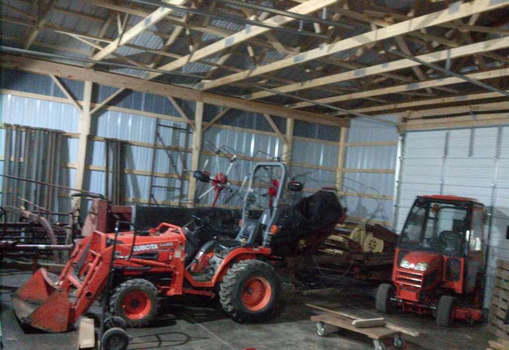

I'm still trying to decide what kind of outdoor floods to use. My goal is to be able to light 360 degrees around the house. I'd like to hear thoughts on halogen vs LED. Indoors, I really want to go with LED as much as possible but have concerns on flicker. Opinions seem to vary widely on this - especially since almost every switch in the house will be a dimmer.
I would go with non-dimmed LEDs built into waterproof fixtures.
I have three 20w LED flood fixtures in the shop (the 6000k version of these: LE® 20W Super Bright Outdoor LED Flood Lights, 200W Halogen Bulb Equivalent, Waterproof, 1300lm, Warm White, 3000K, Security Lights, Floodlight - - Amazon.com ), they are spaced about every 15 feet along the 40' wall (one in the center and one ~15 feet on each side of it) and they light up a 40x30 shop pretty well.
Planning on one for each end on the outside (centered on the 40' end) and possibly one for each 30' side as well.
Also planning on 4 of the 50w version pointing straight down in the "work bay" (I like a LOT of light to work by).
I would put them as being at least as bright as a 150W Halogen floodlight, but with a very wide beam pattern. The Amazon ad claims that they are as bright as a 200W Halogen.
Here is the view in the shop from underneath the 3rd light, looking at the area lit by the middle light and the far light:
I also have a couple of the 10W version that I am currently using to light up some Christmas displays. One 10W light will light up what I had to use two 75W PAR38 bulbs for last year.
Aaron Z

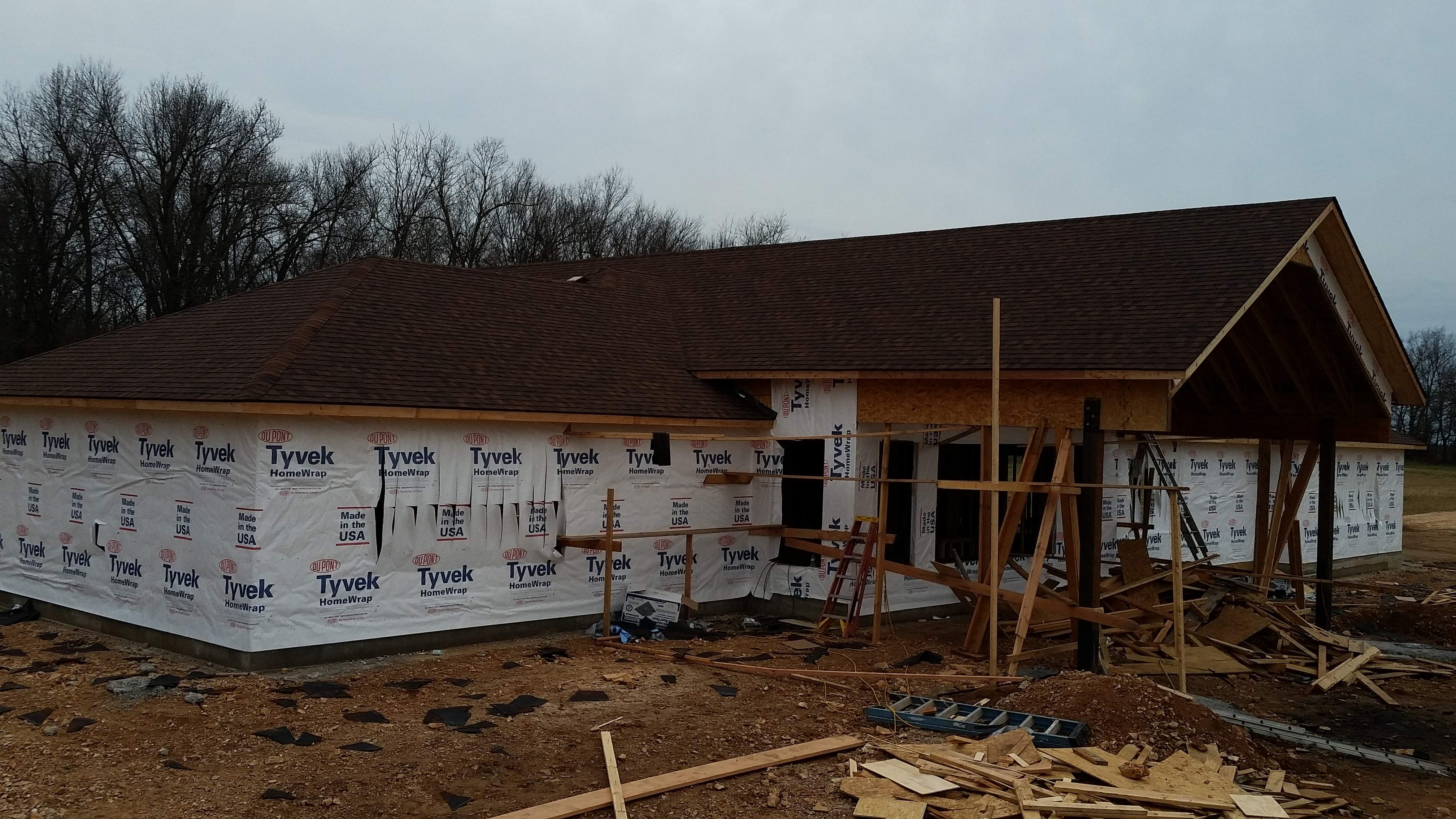

The roof went on before any additional support could be added, but I like the idea of adding the bracing by the ties. I have a few weeks before any work is slated for the underside of the trusses.
Is the cedar fascia installed in this picture? I can see something that could be flashing, or drip edge, at the top of the wood. I guess I mistook the wood for pine and not the finished ceder.
