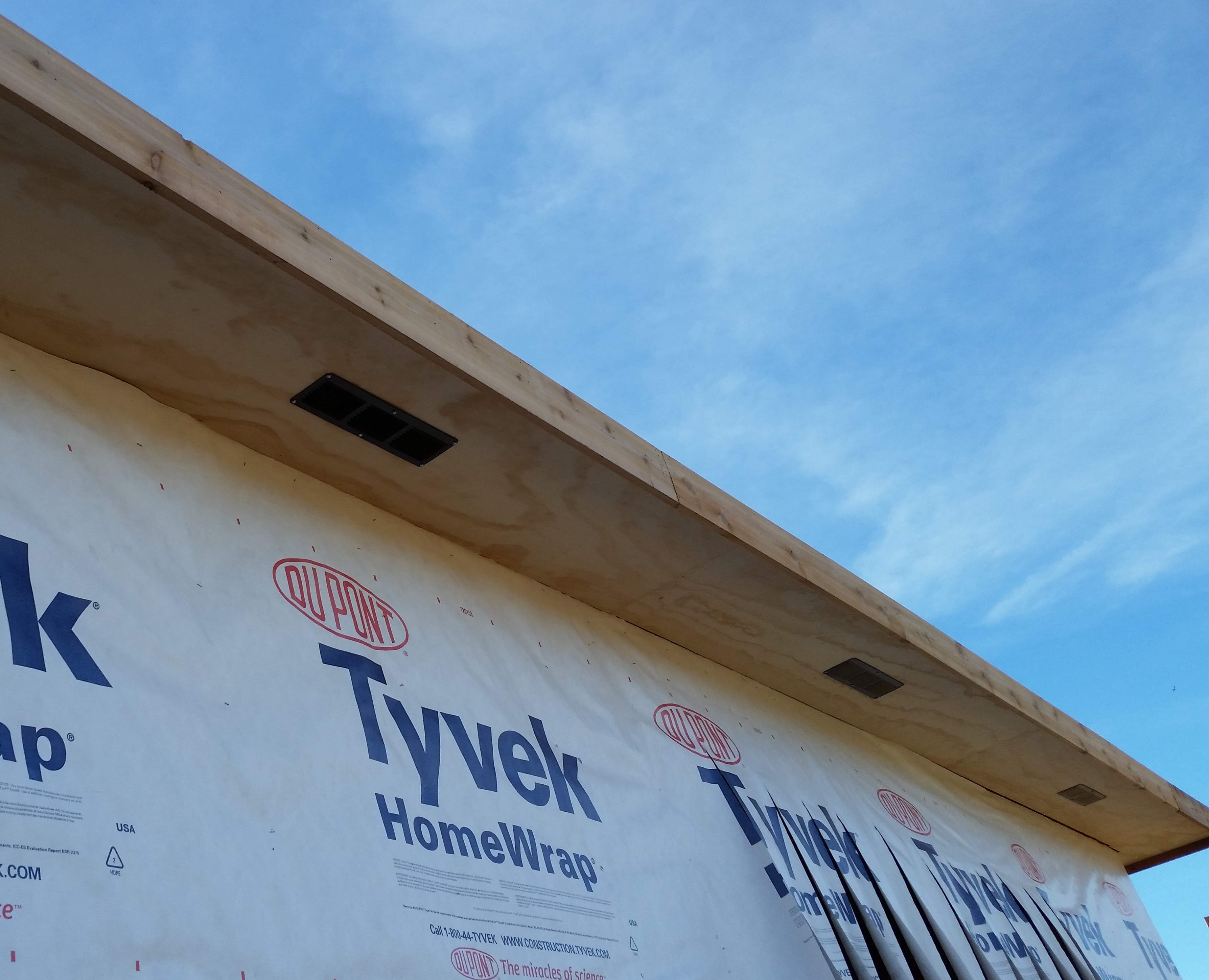

Is the cedar fascia installed in this picture? I can see something that could be flashing, or drip edge, at the top of the wood. I guess I mistook the wood for pine and not the finished ceder.
I thought the same thing Eddie. The picture looked like framing lumber and not fascia. I couldn't zoom in well enough to tell.
   / Building our retirement home
#314
Yes, the cedar is installed in that photo, as well as the drip edge. It may still appear somewhat light because it has not been stained.

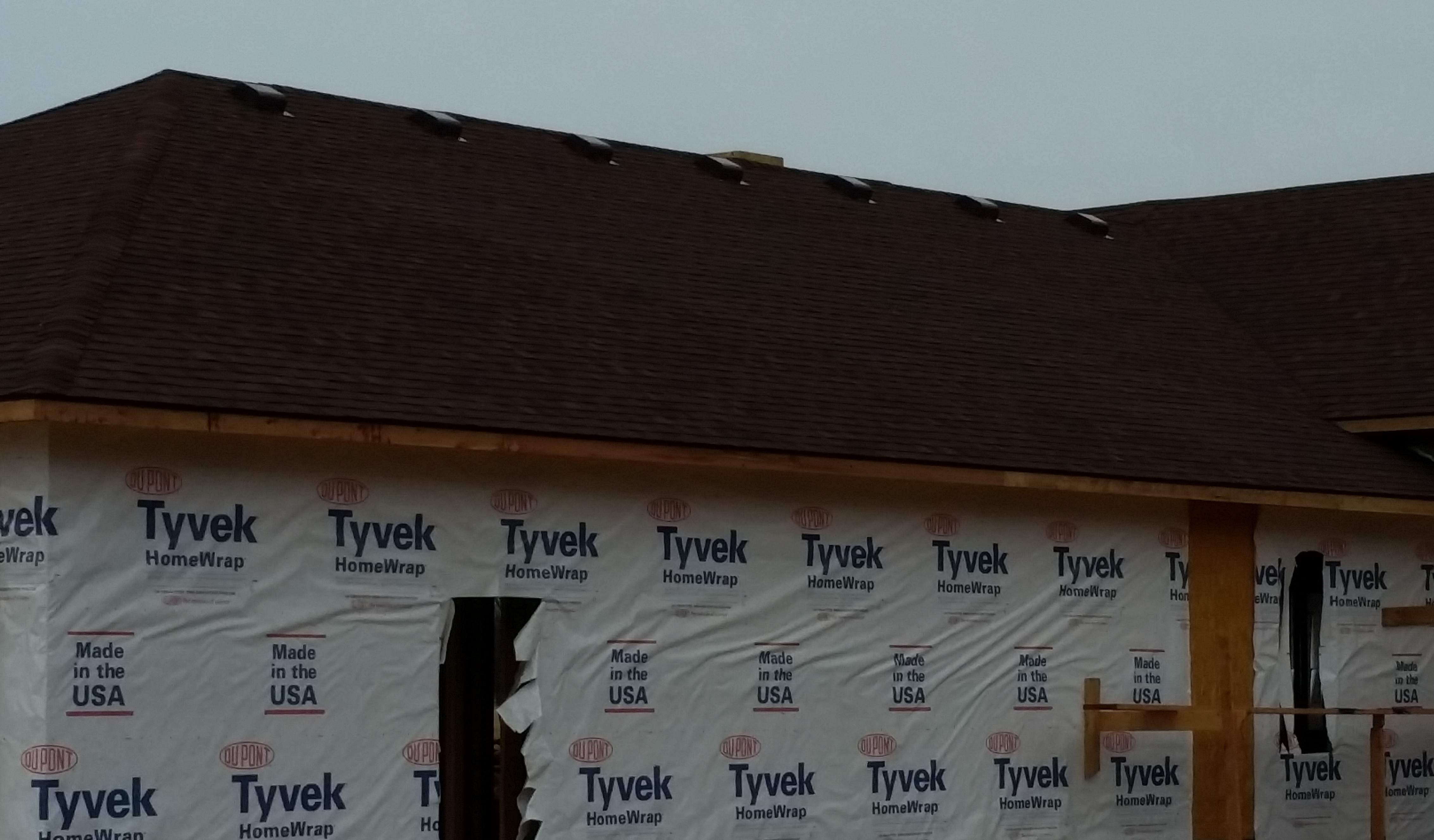

I don't think any houses here in southern Kansas have ridge vents. They all have soffit vents and multiple roof vents near the ridge on the back side of the house (non street side). Some have additional gable vents too. No issues as far as I know.
My prior home had a black plastic ridge vent. From any distance, it looked just like that ... a black plastic ridge vent. I HATED it. I'm sure it worked great but I couldn't get around the ugly.
Now, some may not like the approach I've taken on my new home. I prefer it. The vents are not visible from anywhere except the rear.
