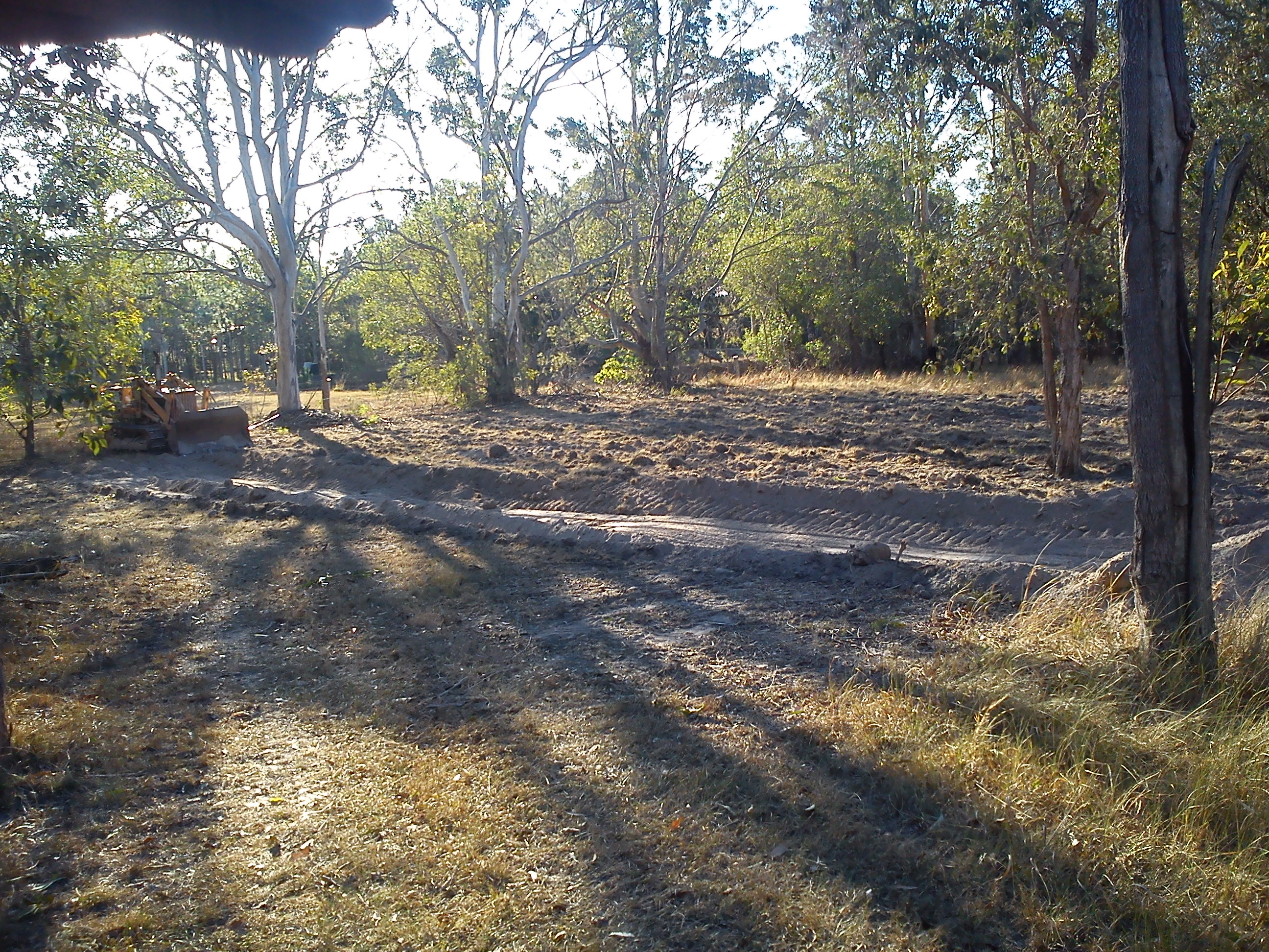

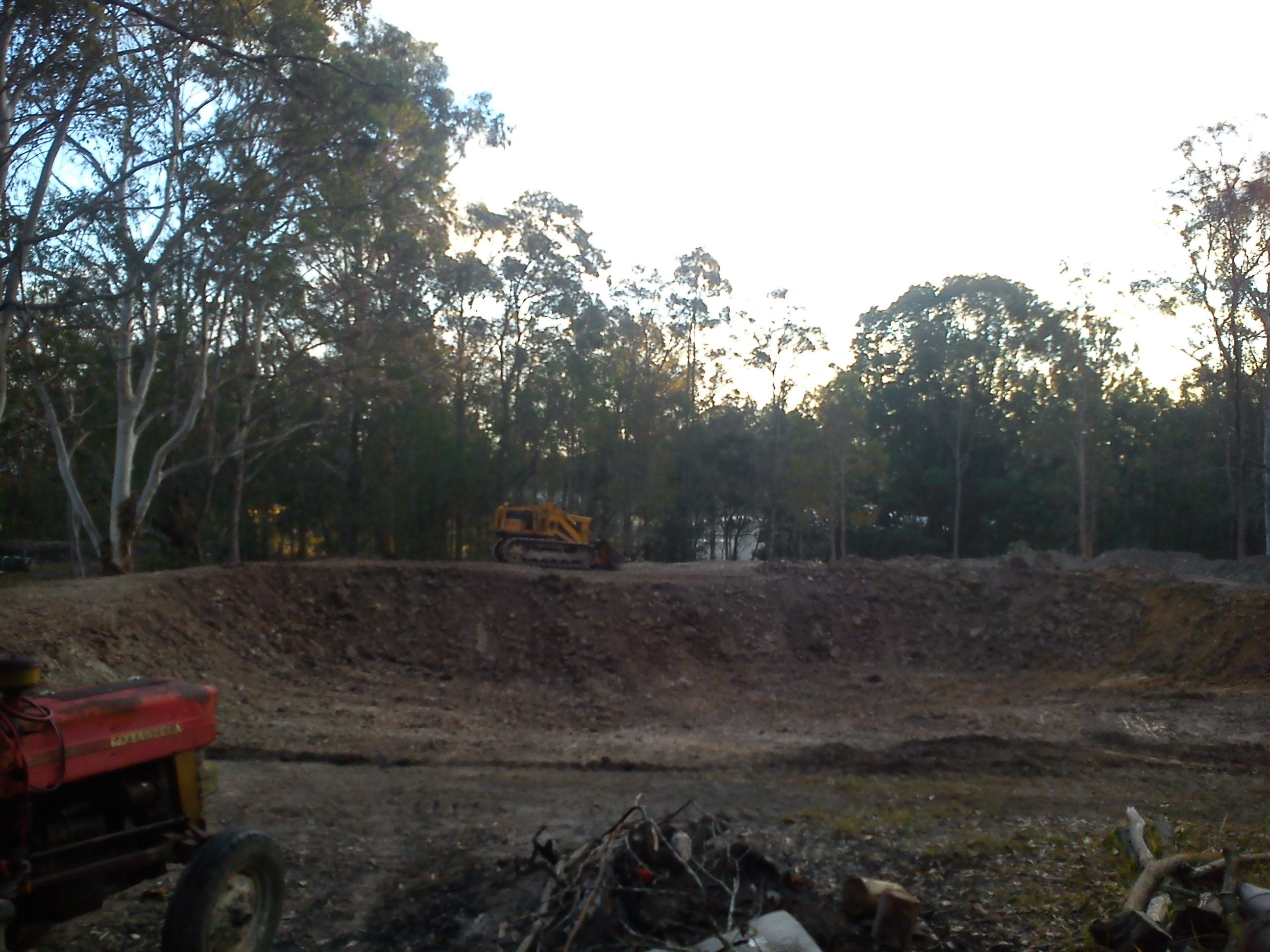

Hello there Lucky, :) I'm glad you are finding it interesting too. You're right - there's more than a bit of work involved. ;) I've seen over a dozen dams built - mostly for water for cattle, but that was decades ago :shocked: when I was a boy, growing up on our family dairy farm. I'd never been involved in building one ..... until now. Relying only on my memory of watching dozer operators working, and betting on my ability, this is the (almost) finished project. Now only tidying up, watering newly-germinated grass and periodic fertiliser application should be all that's left. :thumbsup:
I'm just a little bit puzzled by your term "mini dam" :laughing: is that a Canadian expression we here in Aussie don't know of, although I believe you may mean a dam of a much smaller capacity than the normal supply-the-town's-water-needs type dam? We refer to those as "reservoirs". This one of mine is only about 22mx26m - it's a little oval, and will fill about 3.5m, not as big as my neighbour's, but just a little larger than our first dam. I can't wait to see them both full! :D
Before, during and after ... what do you reckon?

I reckon you are so good on the equipment with those smooth side hills, that your family should let you spread the icing on every birthday cake!
/ Building our new dam
#65
I would be much better at eating the birthday cake (or any other cake) :laughing: my better half can cook anything extremely well, and evicts me from the kitchen! :thumbsup:
Also ... it took ages to get those slopes the way I wanted them!
Another funny thing - after I raked lightly to cover the seed, a lot must have settled into the cleat marks, so now in most places it looks like it's been sown in rows! :D
Very nice work. Your photos and explanation are great. Interesting that I spend a lot of time shaping my land so it will shed water and not pool up while you ( and many others ) try to trap water.

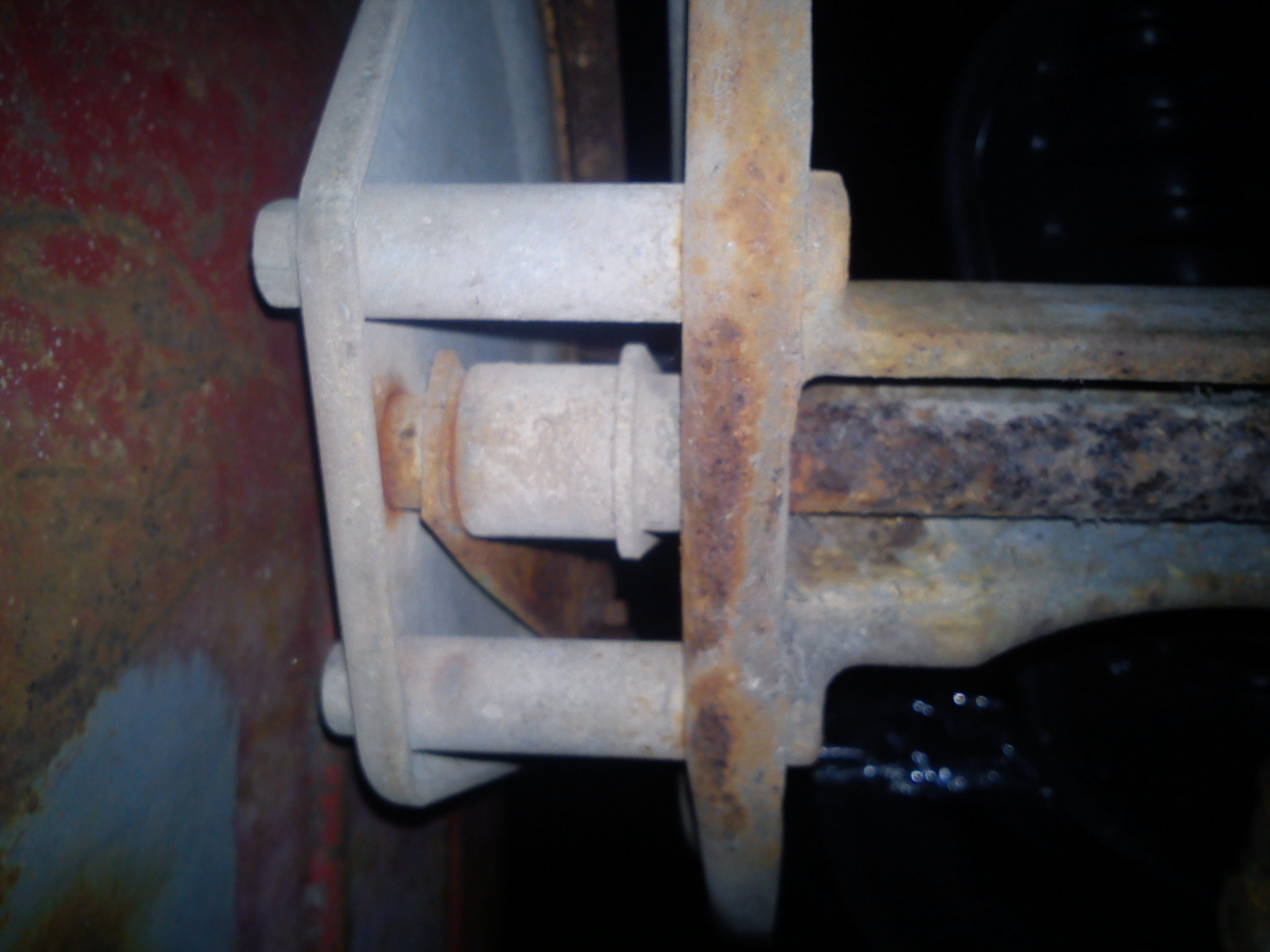

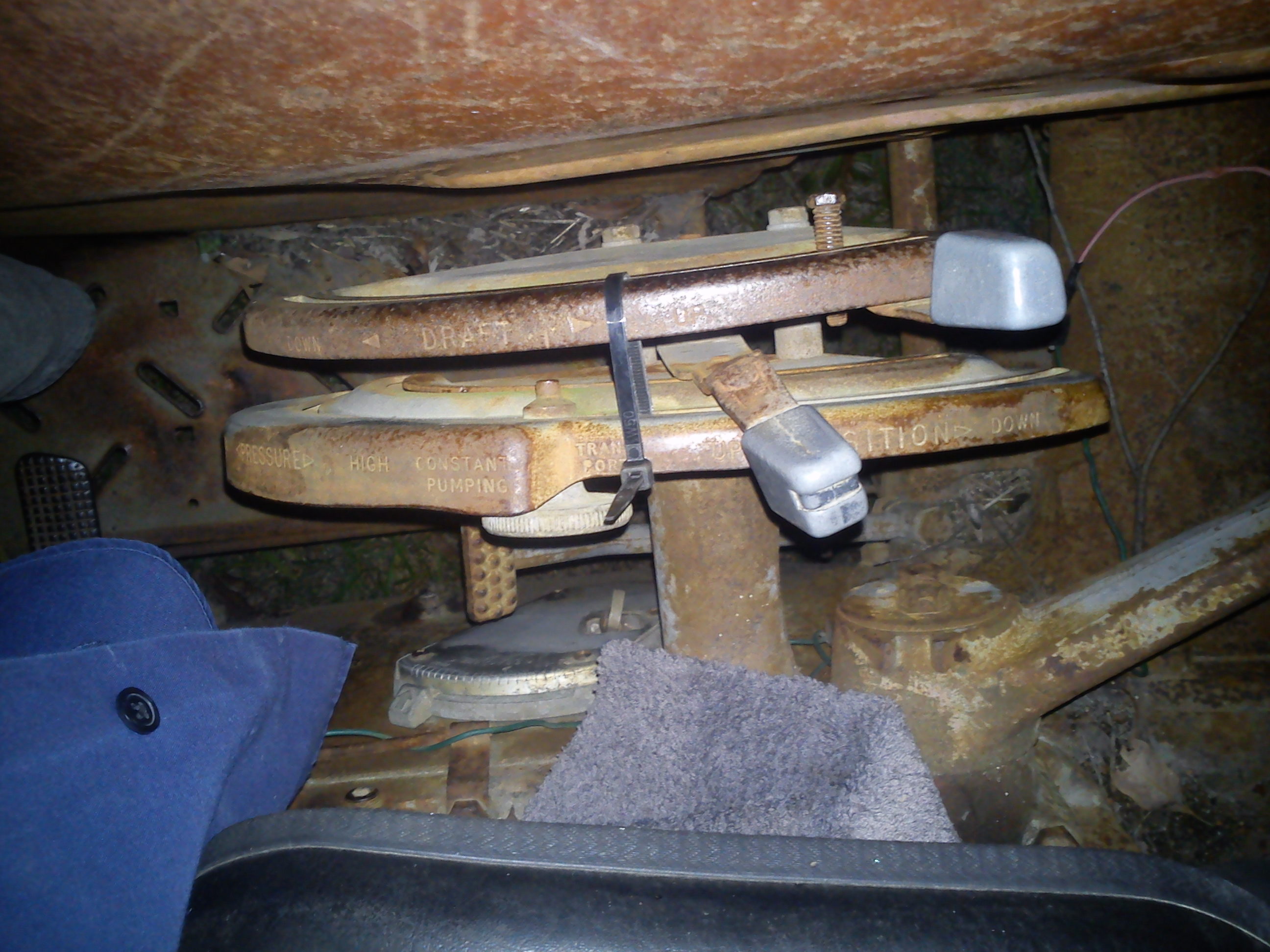

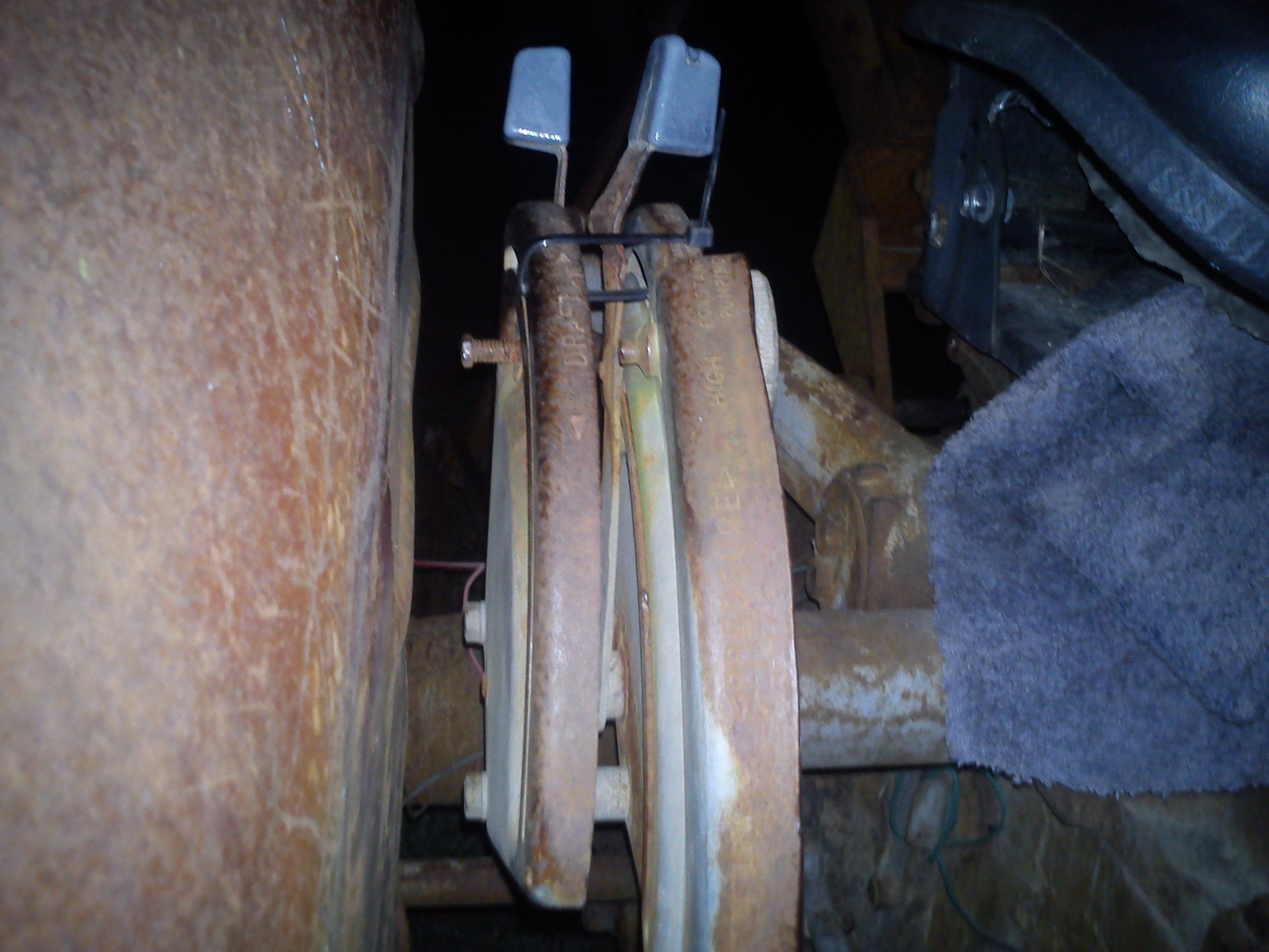

Hi, Your tractor has controls a little different to mine, but the operation is mostly the same.
The noise you tell me I think is a knocking or a hammering sound? Like you hit a thick piece of timber with a hammer? Does it also seem related to engine speed?
The outer lever with the round ball-shaped handle is the Draft Control, and the inner square-shaped lever is the Position Control.
"Draft" regulates lifting strength; or will sense and regulate load. "Position" regulates lifting height, and that height will be kept automatically.
The Draft Control is used when you are ploughing the soil. You set the lever at a suitable location and it will let the hydraulic system "feel" the load on the tractor and adjust the height of the plough to keep it from overloading the tractor and losing grip. When using the Draft function, the Position lever is usually near the top, and when you want to raise the plough to turn around you just pull the Draft lever right up.
The Position lever is used when you want to lift an attached implement to a specific height. In this mode, the Draft lever is usually at the top.
The "Position" lever also engages a function called "Constant Pumping" which is used only when a hydraulic attachment such as a loader is connected to the system. This function should never be used without an attachment connected - otherwise it will destroy the internal pump.
You said the Position lever doesn't work, but the Draft lever does. When you are using one lever, is the other lever at the top? Remember, the Position lever cannot be in "Constant Pumping" position - that is the cause of the noise I believe you are hearing.
Here is what I would like you to check. Do these first steps with the engine stopped:
1. Look under the round arch-shaped mount for the lever assembly. You will see the shafts for the levers. The first pic below is what mine looks like from underneath. The Position control shaft is a tube with the lever near one end but not at that end, and the Draft control shaft is inside it. Move each lever and you should see the Position control tube moving, or the end of the Draft control shaft moving when you push or pull the relevant lever.
2. Next, start up the engine and let it idle. Carefully raise the 3PL arms with the Draft lever.
Now both levers should be raised. You should hear the knocking noise when the arms stop at the top.
3. Next, increase the engine speed a little and note if the noise knocks faster.
4. Next, move the Position lever toward the "Lower" direction and note if the noise stops when the arms begin to lower.
5. Otherwise the arms might not lower. If they don't, push the Draft lever toward the "Lower" direction and again note if the noise stops at the moment the arms begin to lower.
Please reply with your answers and comments on anything you saw happen, or not happen, in each of these test steps.
The second pic is what my quadrant and lever set looks like from the driver's seat.
The third pic is the view from the front of the tractor.
Check these things carefully please, and let me know your results.
Pat. :drink:

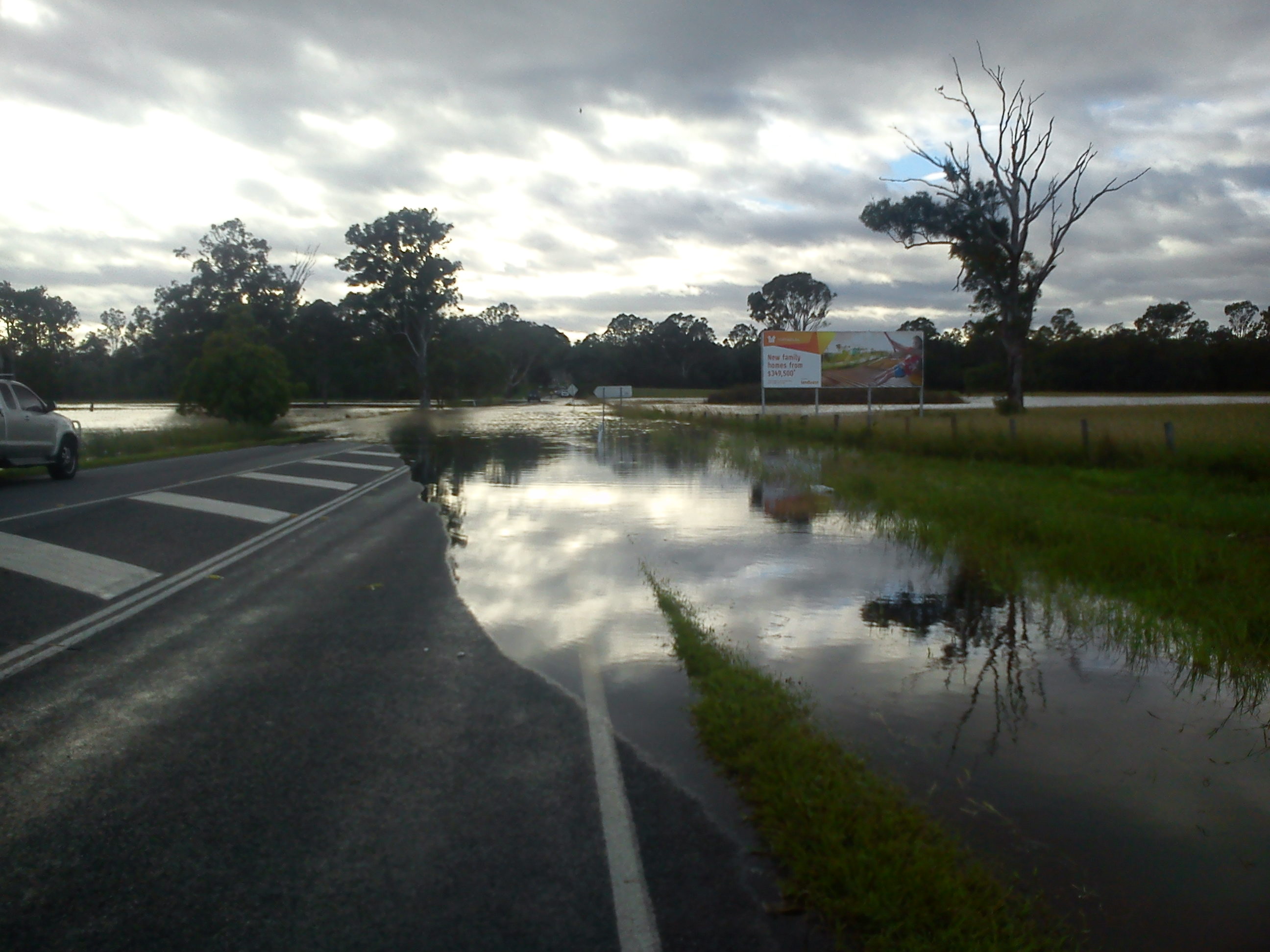

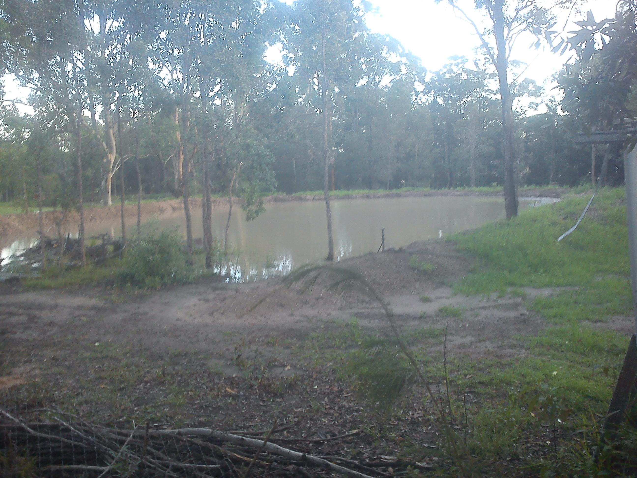

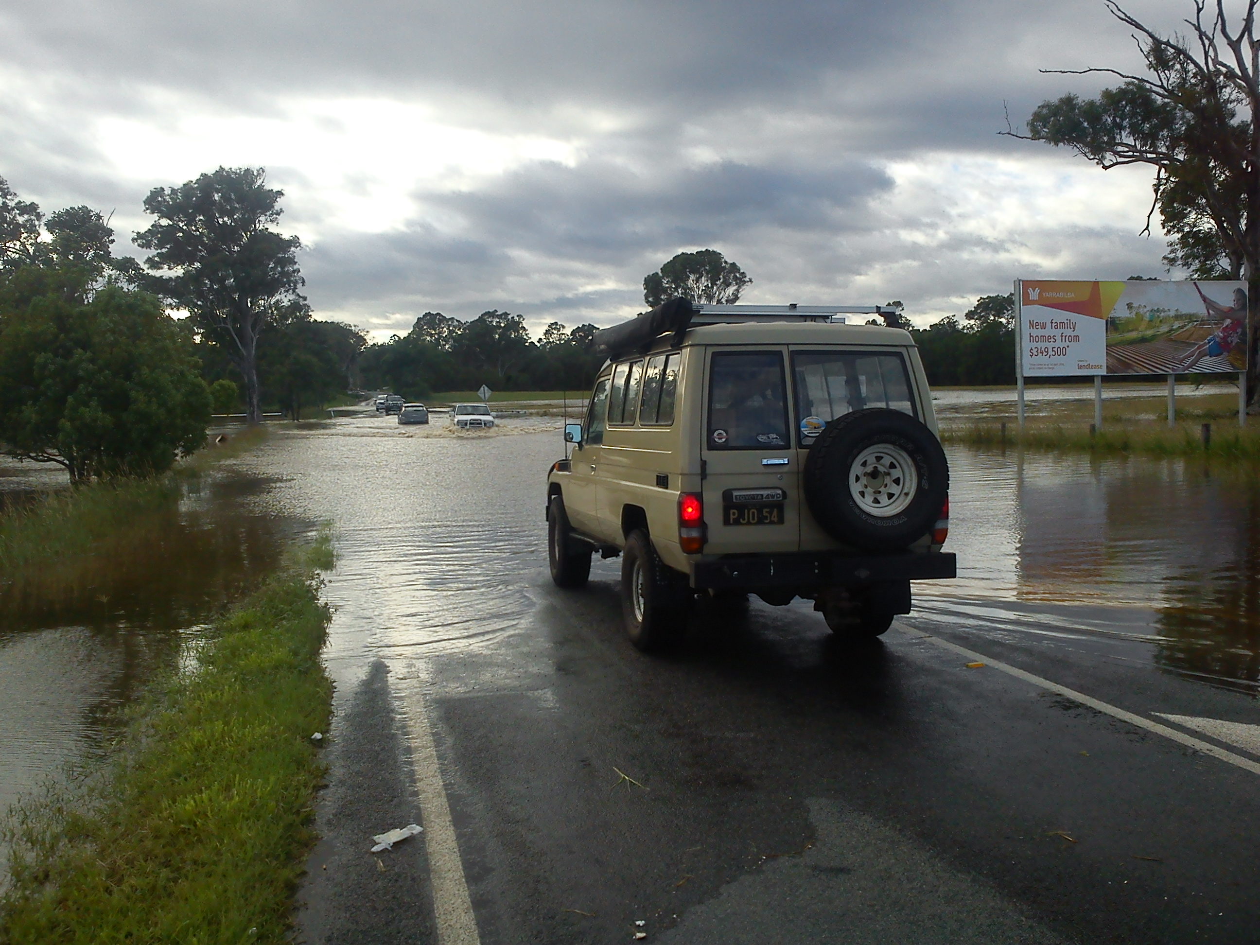

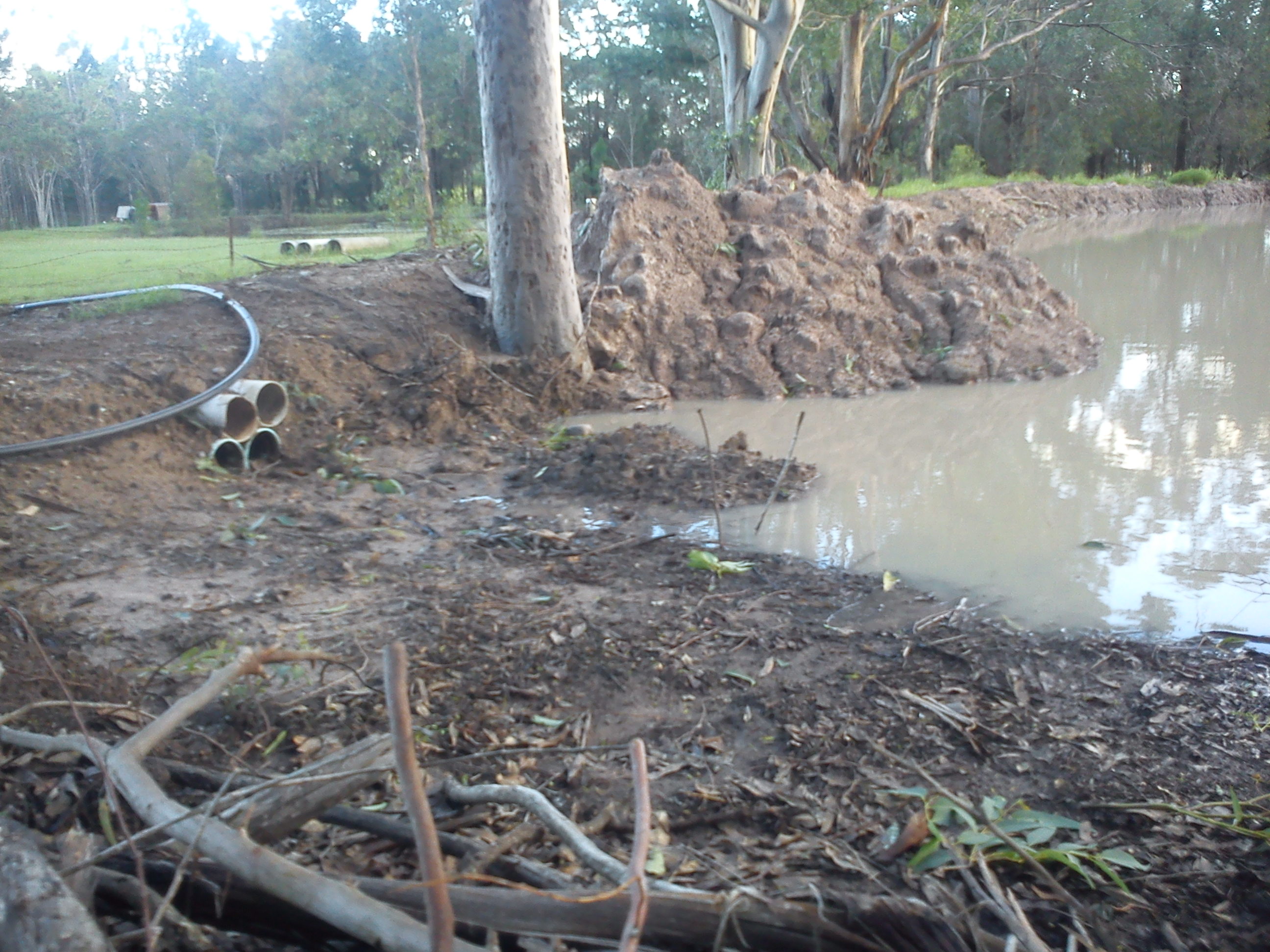

Hi All, Back on topic with finally an update on progress with the dam.
We've had an exceptionally hot and dry summer, plenty heat and almost no rain. As a result I've had to give the wall a light watering almost every day because the "soil" doesn't absorb moisture quickly at all. Adding some fertiliser every couple weeks helped establish the mostly cooch and kikuyu - that's about all that's left now. The ryegrass couldn't handle the hot sun without at least some shade. The last two weeks or so we've had some light rain-showers and cooler days - again a help for young grass. About six weeks ago we finished the water in our other dam - moved the pump to our neighbour's dam, which last week had only around 4 feet of water left.
You may have heard recently about a serious-calibre cyclone (Debbie) in NE Australia ... caused a lot of damage 6-700 miles to the north of us. After crossing the coastline it turned south, no more serious winds but dumped a heap of rain as it travelled south. It's gone out to sea again, but we're now contending with severe floods! Missed work yesterday and today - roads covered by floodwater - no problems for us, but a lot of folks' houses and businesses are flooded. It's levels are just tonight beginning to drop.
As a result, my top dam is full again, overflowed all day yesterday into my new dam, which went to within 2 inches of overflowing.:D
Good news overall :thumbsup: no leaks, nothing moved, washed away or damaged - just as well because it filled up so quickly.
We received 240mm (almost ten inches) of rain in 28 hours. Further inland upstream in the river catchment received 500mm (18") with one locality reporting 945mm (34") in around 36 hours. No wonder we're floodbound. :confused2:

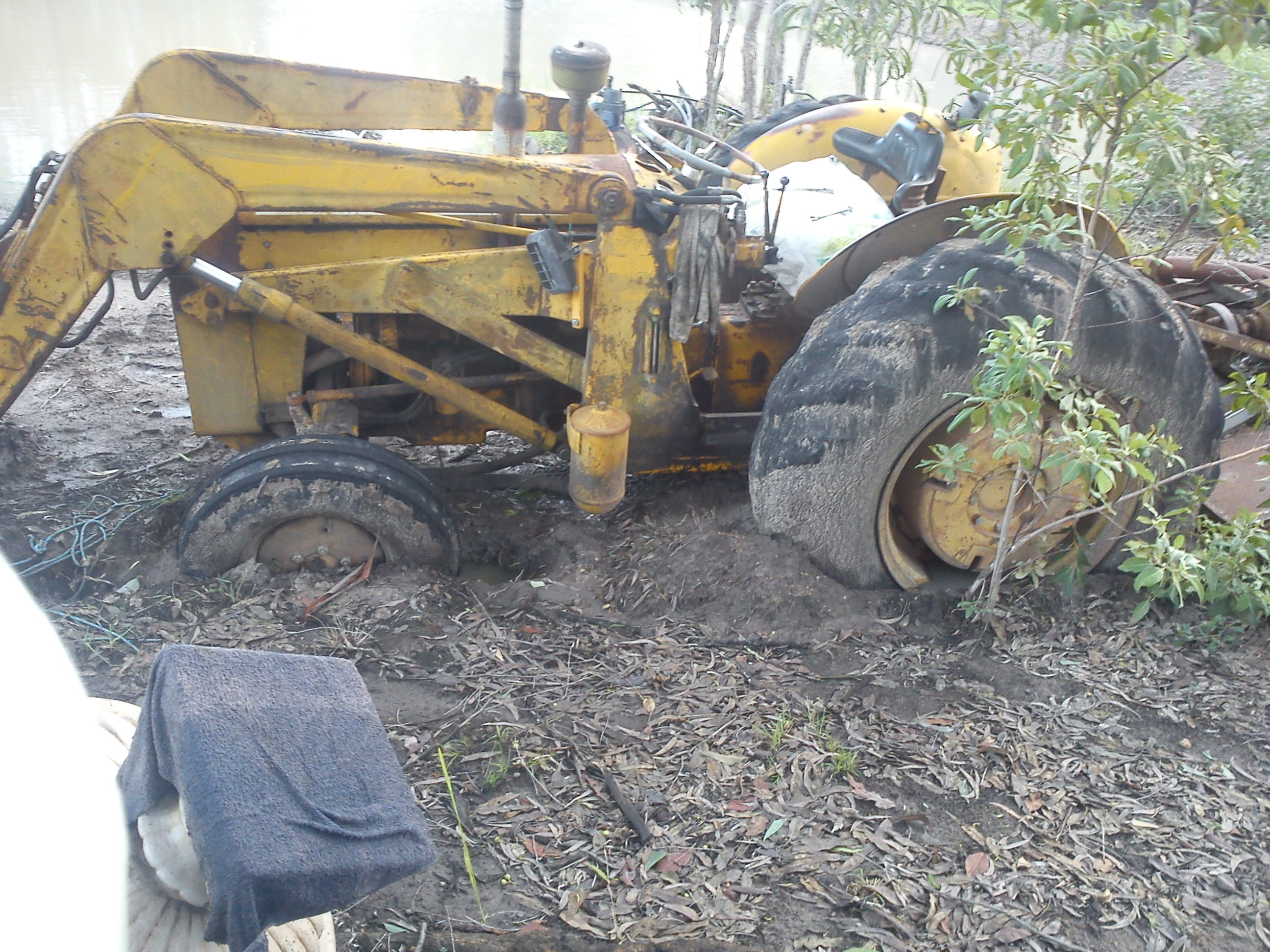

1st & 2nd pic - New Dam; 3rd pic ..... Oops! Soft ground and heavy tractors aren't a good combination! :eek: A couple of days and it'll drive out - otherwise a bit of help from the 135 should be sufficient. :laughing:
The road to work; and some stupid people in their vehicles:
It looks like we will both be pumping from this dam to use at least half the water from it, to allow me to tidy up and finalise, do some more work to improve the aesthetic appeal and plant some more grass seed around the general area. That might have to wait until around August - approaching spring.
