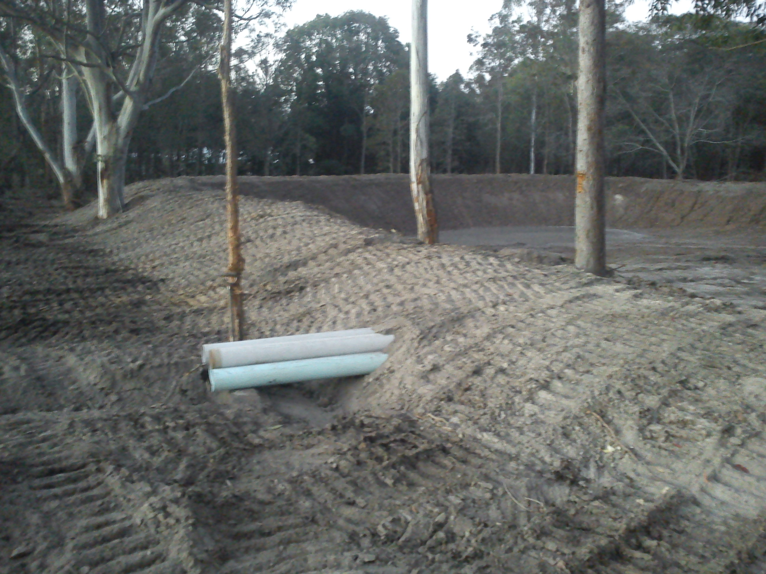

Yes mate, I need to build it yet. Initially I thought I'd wait and see - this dam is filled by the overflow from the first dam. I've seen the flow over its spillway quite a few times, while it's been sizeable it's nothing like you describe. Nevertheless there's still the aspect of debris, which could be quite a bit more of a concern to four 6" pipes, as opposed to one 24" diameter outlet. They'll surely be more prone to becoming blocked by branches and twigs from nearby trees. Therefore I reckon you're correct, it needs to be done as part of the job, so it's there and ready when it's needed. I'll have to build it on the opposite side where the ground slopes away from the dam, and it can be on natural ground. I reckon a generous amount of clay on the end of the bank and some rockmelon-sized stone on the spillway should be sufficient protection against erosion there. I did the same on our first dam after I enlarged it and raised its overflow level by about 2 feet. I could see it didn't appear completed - the bank was only done three-quarters of the way around it, resulting in it overflowing at the natural ground section with about 4 feet of bank above the water level. I built the missing section of bank and lengthened the dam about 25% more. I did this several years ago with that same tracked loader and, while its spillway could only be positioned on the bank in a particular location, the rocks and clay there have almost prevented any erosion at all.

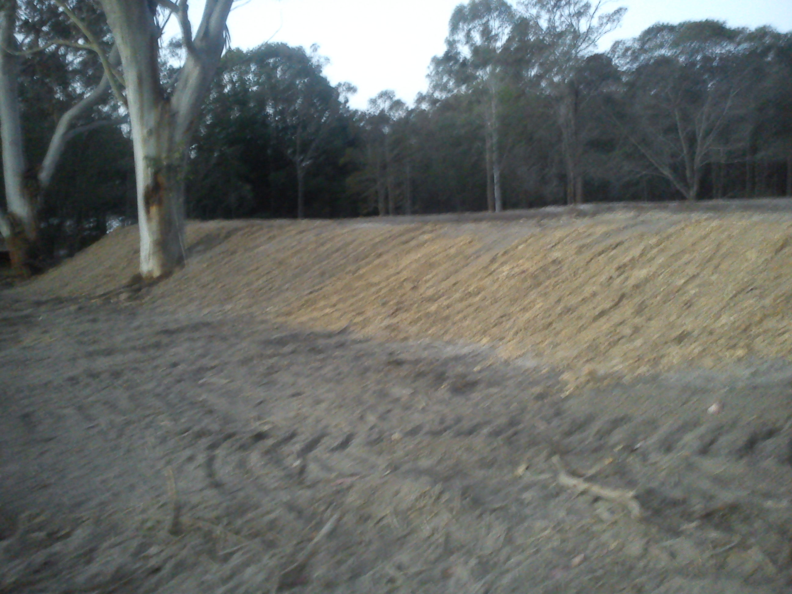

Happy to be able to state the seed and fertiliser has been spread, raked lightly and is now awaiting tomorrow's forecast (hopefully light) rain! :thumbsup:
Finished one hour after dark ..... with a head-torch! :laughing: I must also add our daughter was a great help in all this, but I had to rake it in so she could finish some homework. I also ran the 135 along the lower edge a few times just to press the soil a little, in case it began to wash away - might help a little. ;)
Also, yes, I'll also be happy when grass is growing. :thumbsup:

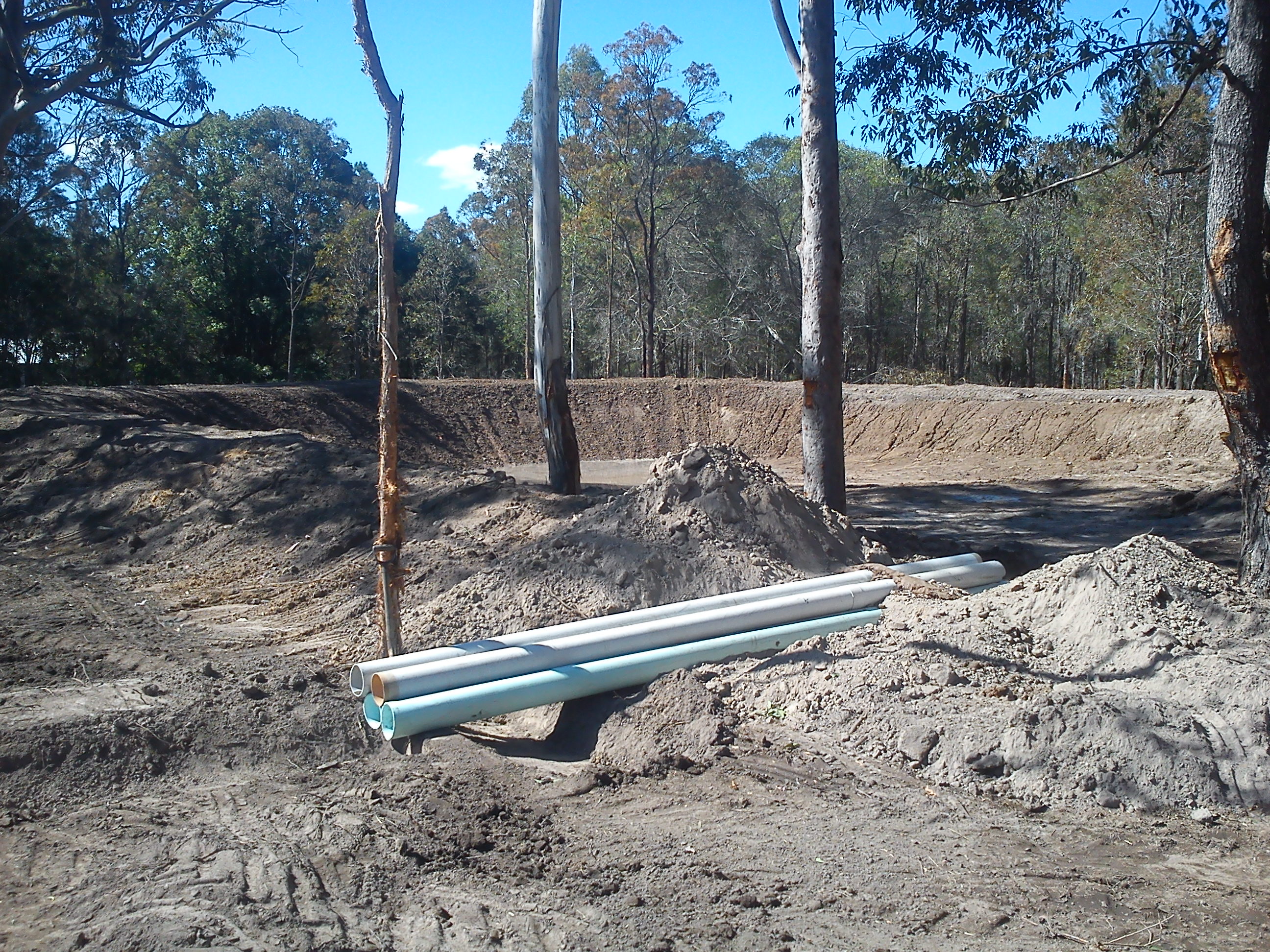

Any thought to sinking a debris fence to the entry side of those pipes to perhaps catch some of the branches, etc. that could become a potential blockage?
/ Building our new dam
#23
You must have read my mind ..... I've saved a length of chicken-mesh about 2 feet high and planned to use it for that very purpose!
/ Building our new dam #24
My small pond I put a 90 elbow facing up on the pond end. Some debris catches there but you can see it to remove. It also sets the level of the water. I couldn't use a spillway in my setup. Jim
/ Building our new dam #25
A debris fence a little in front of the pipes sounds like a good idea. But you have clean it doing a flood, or you could find the fence swep into the end of the pipes. I have hardware cloth (1/2 inch mesh) over the overflow pipe (vertical opening) and it is always clogged with 1 inch debris and twigs, which traps more and more until little flows out.

Both ideas are good, however I believe in my case it would be a benefit to stop any sticks and branches with maybe a 2"x2" mesh screen across that corner - it would need to be about 15 feet long and around 12" high, but it should allow leaves etc to pass through and out the pipes. This won't block them, and I feel it's preferable to allow leaves to escape, rather than keeping them in there to rot in the water. Twigs and branches should I expect become caught in the mesh, and then easily removed later - it just means walking into 6-8" water in that area, as the pipes are right up the back in the shallow end. I can still add some smaller mesh if required - even plastic "gutter-guard" mesh for roof guttering or something similar. :drink:
