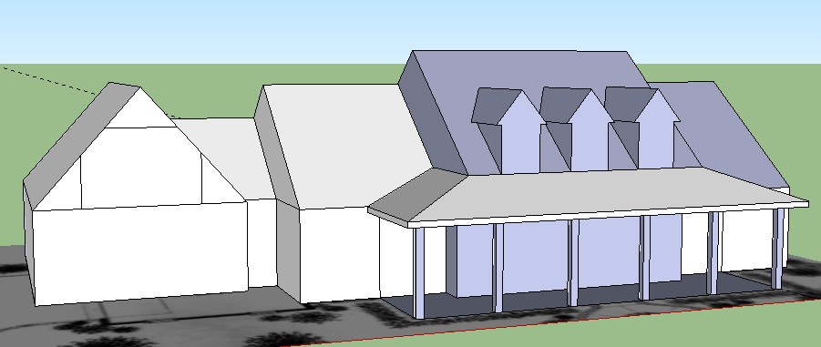

I am kicking around ideas on how to build our new home debt-free. The best one I can come up with is to build the garage part of our new house first and finish it out inside like a house. We would live in it while we save for the house. When we have enough money to get the house "in the dry" I would start on the construction of the house. It would be much easier to do more of the work myself when I simply open the door and there's the house! With our income and house construction costs, the drying-in stage could be started two years after moving into the "garage". Once dry-in is complete, I think I could have the house complete within a year. I have to keep a realistic time schedule since I do work full-time and have a family.
The "easy" way to build this house (and the way most people suggest) is to simply take out a loan and hire a builder. However, I do not want to go into debt and I also want to do a lot of the building myself.
I should be able to have our house complete and still be totally debt-free in 3.5 to 4 years. Once we move into the actual house, I'll remove the interior walls in the garage, pull up the flooring, and install overhead doors. I will install a mini-split unit to heat and cool while we live in there, so that will stay and I will have heat and air in my garage, if needed.

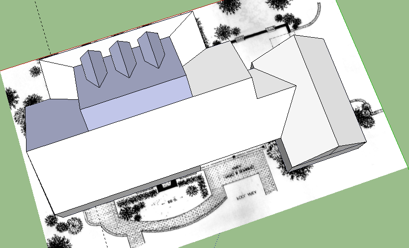

The garage as planned is 25'x32' (outside to outside of stud walls). The way it connects to the house makes it a good candidate to build first and connect to the house later. You can see my crude 3D model below:
I have some ideas to keep it "temporary". As long as it will pass inspection, I can use screws to attach the interior walls to the trusses and concrete floor. I won't mud and tape the joints to the ceiling and just cover them with cheap wood trim. For the overhead doors, I will frame them and put the proper herder in place, but then build a stud wall that fits in the opening and screw it into place. Would drywall over and just cut the drywall when it's time to disassemble.
For the outside, I could use an affordable siding material until the house is complete, then we can have the garage bricked when the house is. For the roof, I would install cheap shingles and then have it re-shingled with the same we put on the house. This is a maybe, I'm not sure how different the shingle will look two years down the road. There may not be enough of a difference to worry about.
One problem I'm not too sure about it using siding now and bricking later. The eaves would have to be re-done to accept brick. I believe it doesn't matter on the windows...
As far as my experience goes... I have had a hand in every part of the construction process and have a very good understanding of building science and techniques. My future neighbor is a retired home builder and we have talked extensively about this and I have his full support. I'm sure he will prove to be an invaluable resource to have close by.
As far as help goes... my wife and I each have a large family. I have architects, engineers, and HVAC guys on my side. She has plumbers, concrete workers, electricians, and general contractors on her side. We could build the house from the ground up just with family. Now getting everyone's schedule to work out would be the main problem... But I do have people with expertise to consult with.
Any advice or suggestions are welcome. If you are just going to tell me to take out a loan and hire a builder, you have missed the point. :)

Here in the peoples republic of Maryland they won't let you do it that way, at least if your honest about your intentions. You have to complete the project before they will issue a occupancy permit. A mobile home on a temp permit while your building is usually allowed and it's way more pleasant then living inside the middle of a construction project.

Since you referenced it having to pass inspection talk to the Authority Having Jurisdiction (AHJ) about the permit requirements and limits. If you are required a building permit they have a time limit to complete construction, usually 1 year but can be renewed for additional cost. The AHJ may have minimum zoning requirements such as exterior material, square footage, and having to have a two car garage just to get the permit. If you have to permit it all up front you probably will not be able to occupy the structure prior to final inspection. If you have to follow code every sleeping area has to have an escape window, smoke detectors, minimum HVAC, and proper plumbing for the bath and kitchen areas.
If your plan is for five years these costs up front may be more than the interest on a construction loan. I would talk to the bank about that option. It may get you in the house faster and with less overall cost. I got a construction loan at low interest and you only pay interest on the amount you draw. We ended up taking out a mortgage to cover the balance after we finished the house but we also built stables at the same time. Also the cost of materials almost always goes up, never down. Over five years your cost increases could be significant. One hurricane can drive the price of lumber through the roof just when you want to do framing.

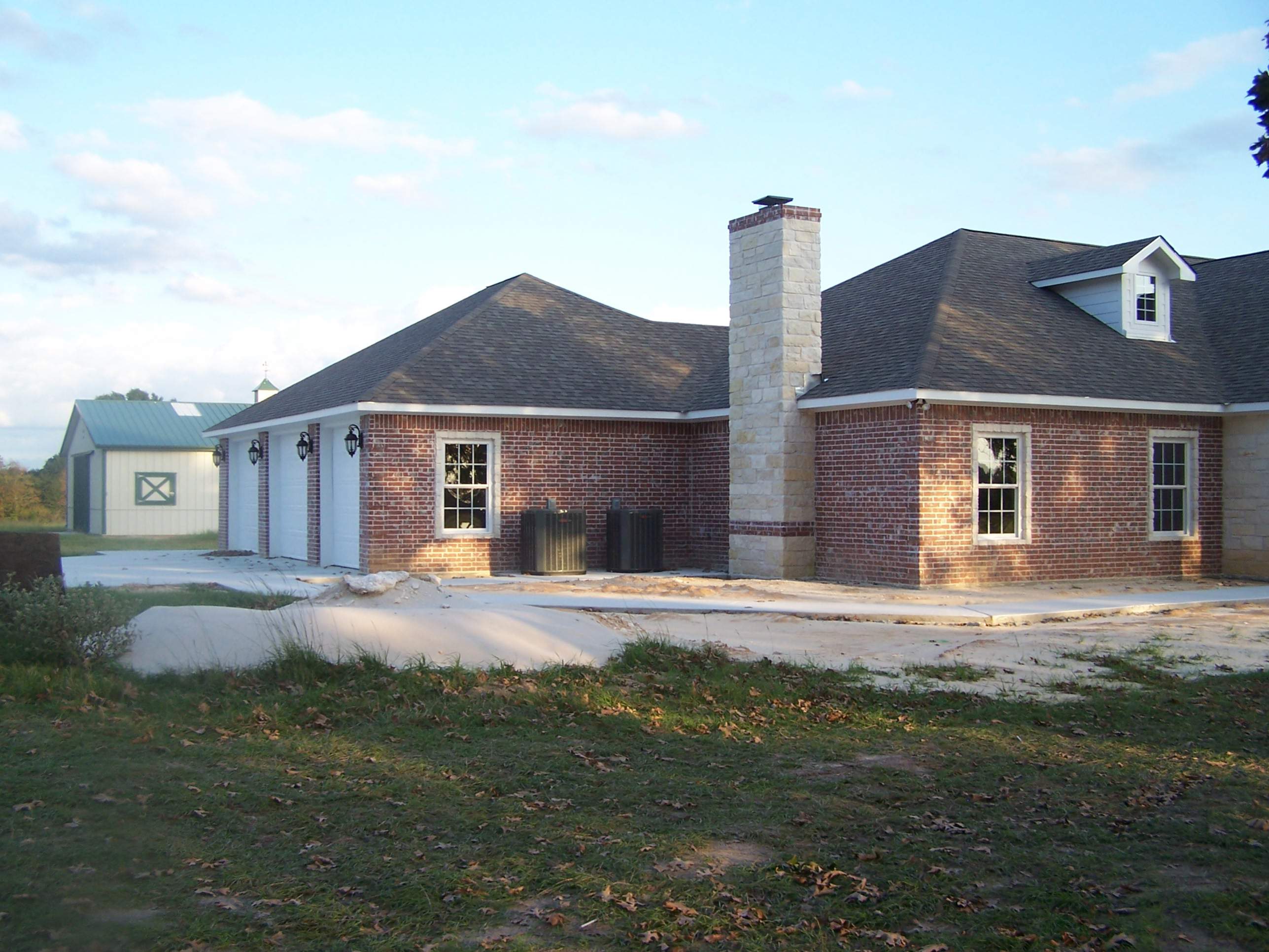

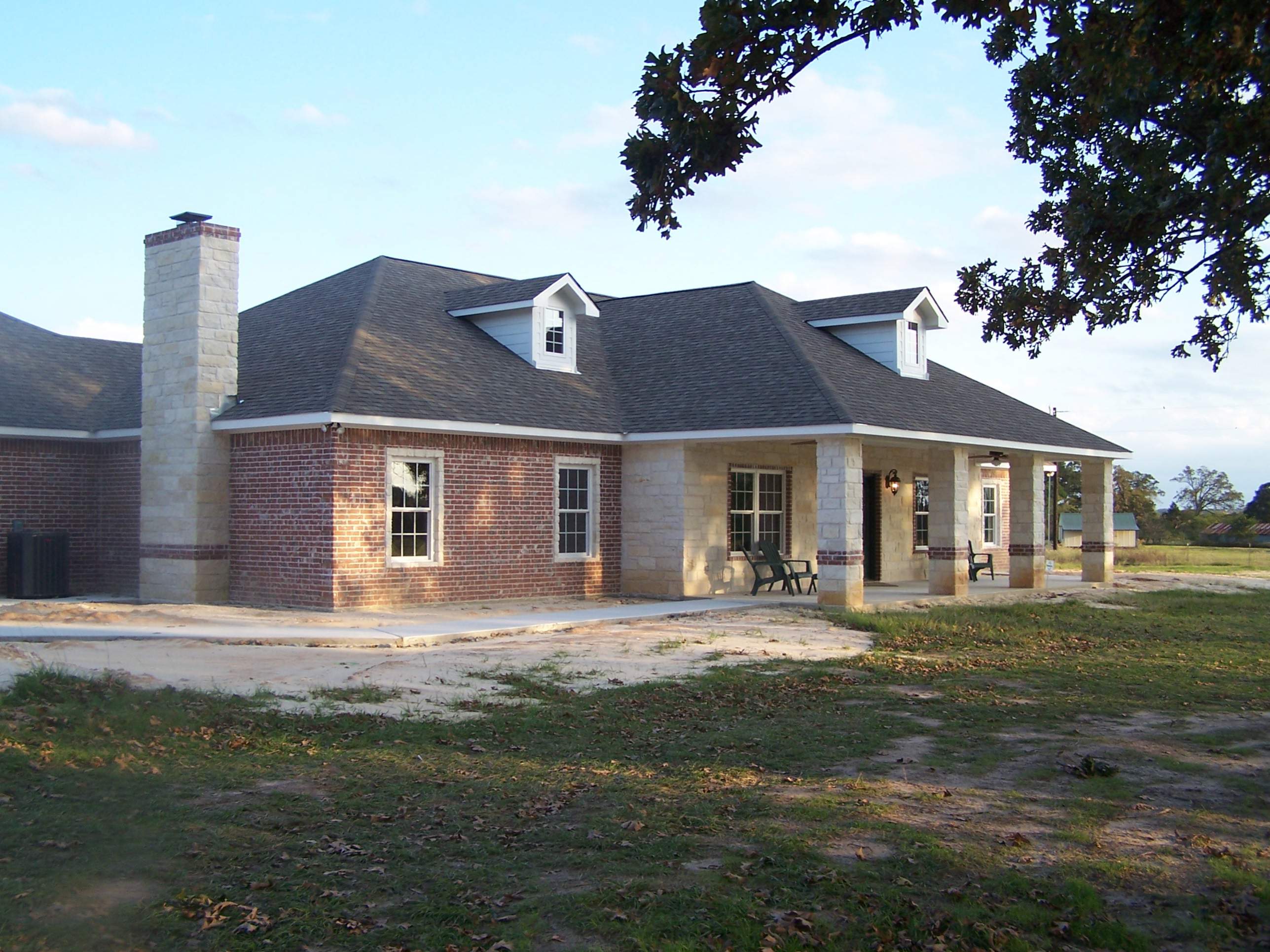

We timed our move down from Alaska at just the most opportune time. We got max value for the house and were able to plow all the profit into a new house here on our 80 acres. In those days the gov gave you the opportunity to avoid tax on home sale profit by using this profit to build another home of equal or greater value.
Anyhow, I built this house and did everything except the foundation. We started in May and finished in mid October. Our first shower was by candlelight because I didn't have the electrical back to the bathroom yet. We lived in a log cabin on the property along with all the mice, chip monks, pack rats - took baths by swimming in the lake and started work at sunrise every day and quit at sunset. It was a wonderful time.

I assume, looking at the plan, that you do not live where it snows ? Those intersecting roof lines would be a killer for holding snow and ice dams...
Many have commented and I have spent a long time investigating locations with little in the way of restrictions on building timeline and permitting process. There are still places where you have relative freedom, but fewer and fewer all the time and definite actions being taken at local government level to introduce code and the "cash cow" inspections and permitting that goes along with it. Last but not least, local government are simply addicted to having their nose in your business and you having to ask permission for everything - which means the opportunity to say NO every time ! If you read the minutes from council meetings, many of the conversations are highly stress inducing (stress being when you have to exercise the full force of your willpower to NOT strangle some stupid bureaucrat who is having a great time denying something that is of no consequence whatsoever to anyone - like a property line setback of 50 feet that is on a precipice which the owner is asking for a 10 foot variance on for building a garage)
