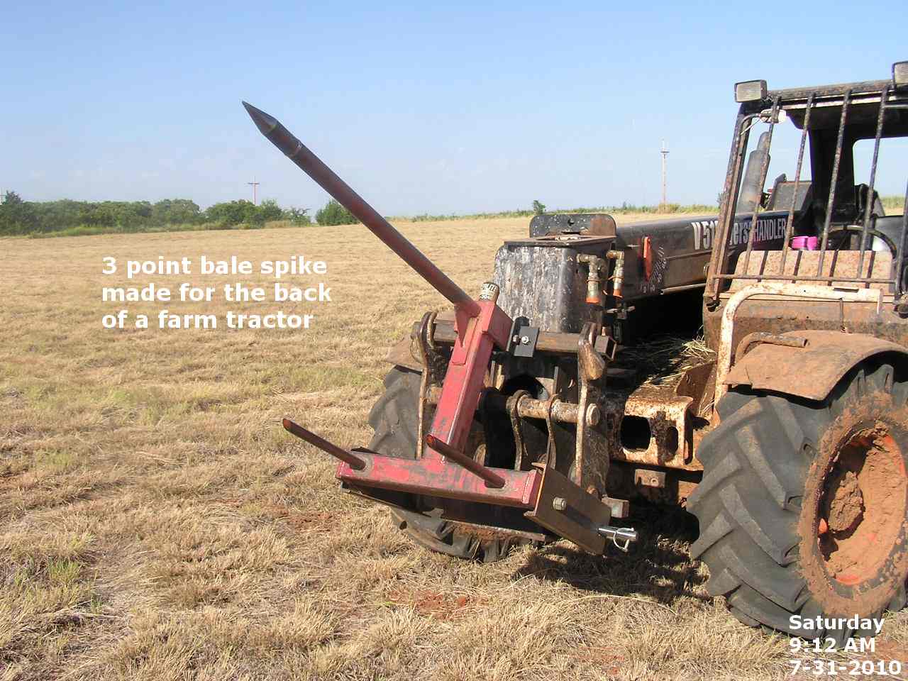

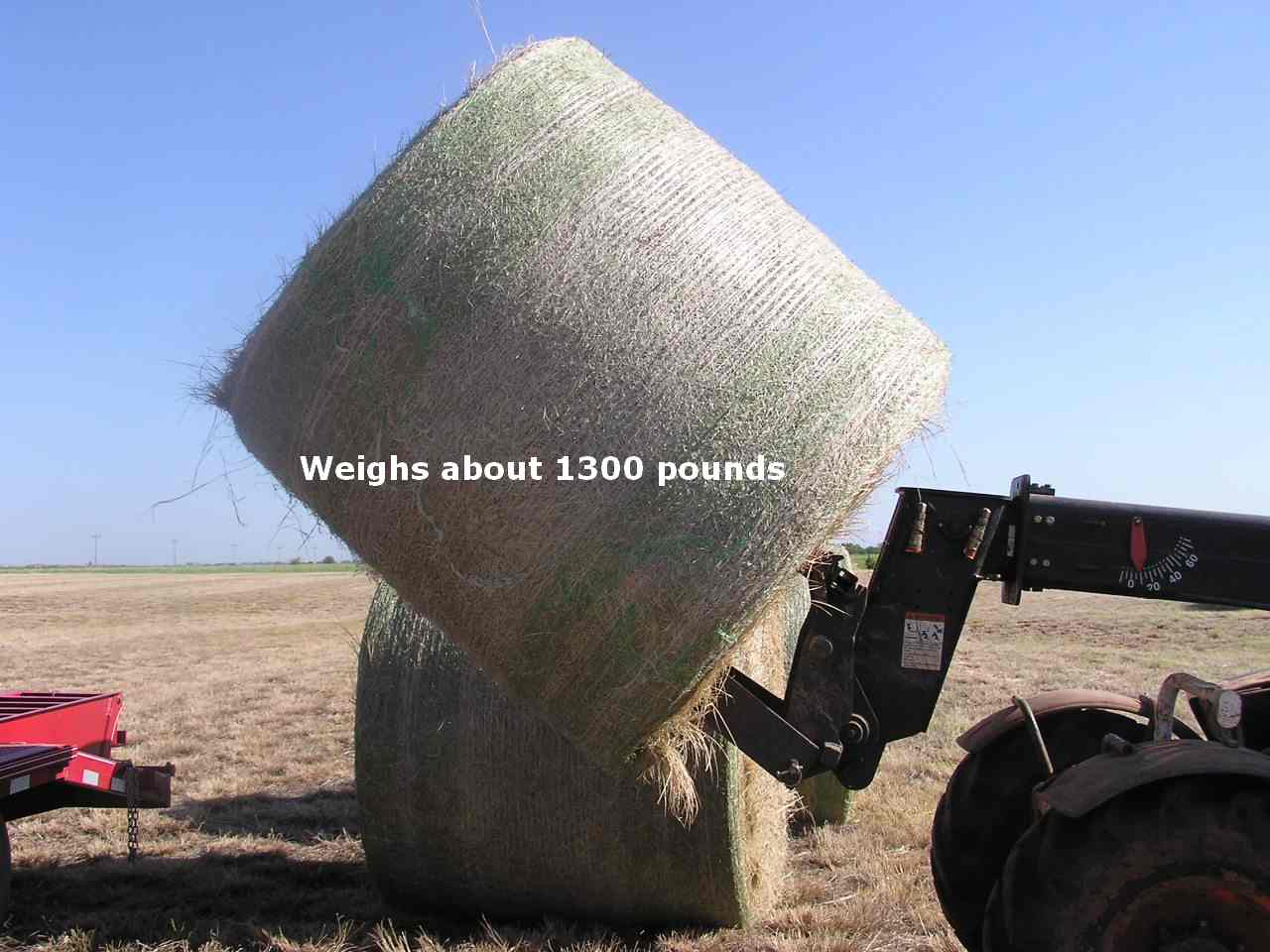

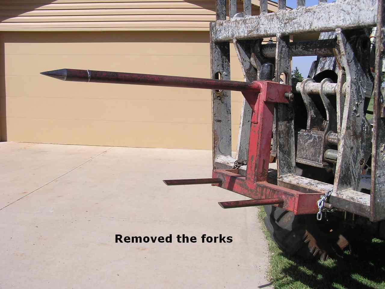

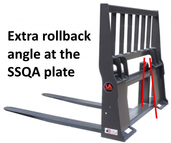

I vote for extra rollback.
This is my first machine that could use a bale spike. I took off the forks and hung the 3 point bale spear on the fork frame. Soon found out it didn't have enough rollback:
Put an adapter together with a lot of rollback:
It worked great:

I thought about that, but then I would have to modify my bucket to fit ssqa, and have a $300 Kubota quick adapter that I would have no use for.
