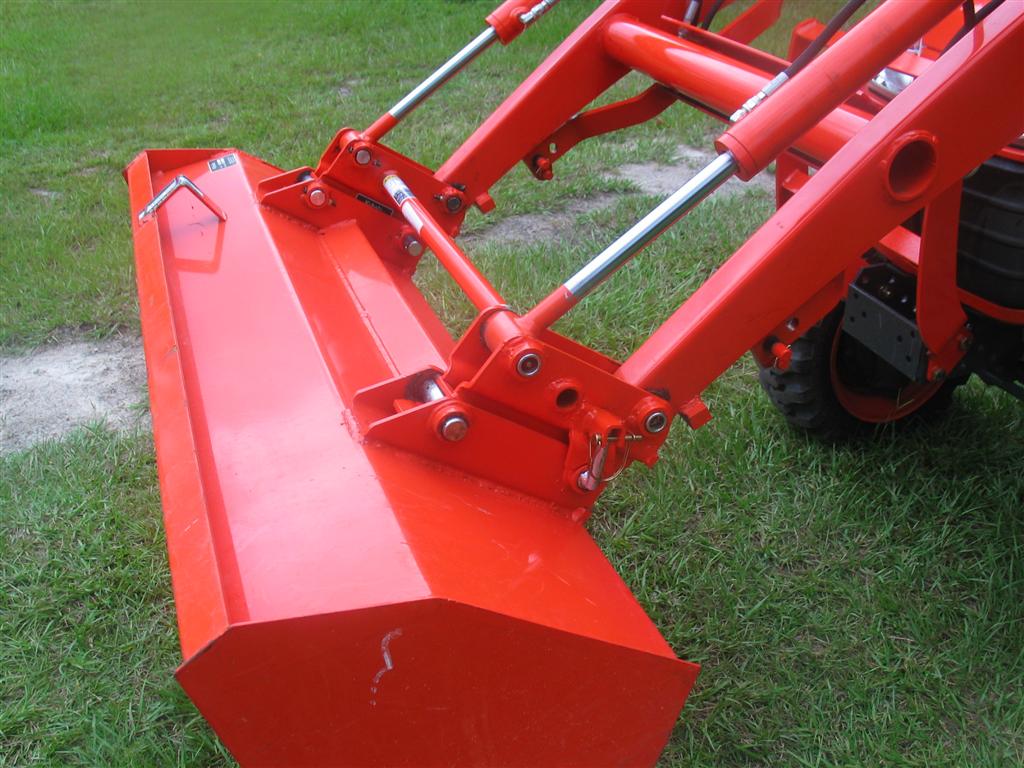

Hi Lou, I am building a spear that will attach to my loader in place of the bucket if that makes more sense. Unfortunately I have the Kubota quick attach so I have to design and build myself.
Pictures would help, but what is different between your Kubota quick attach and a tractor QA that takes skid steer attachments?

Thanks, Tex. I have seen adapters to fit that style:

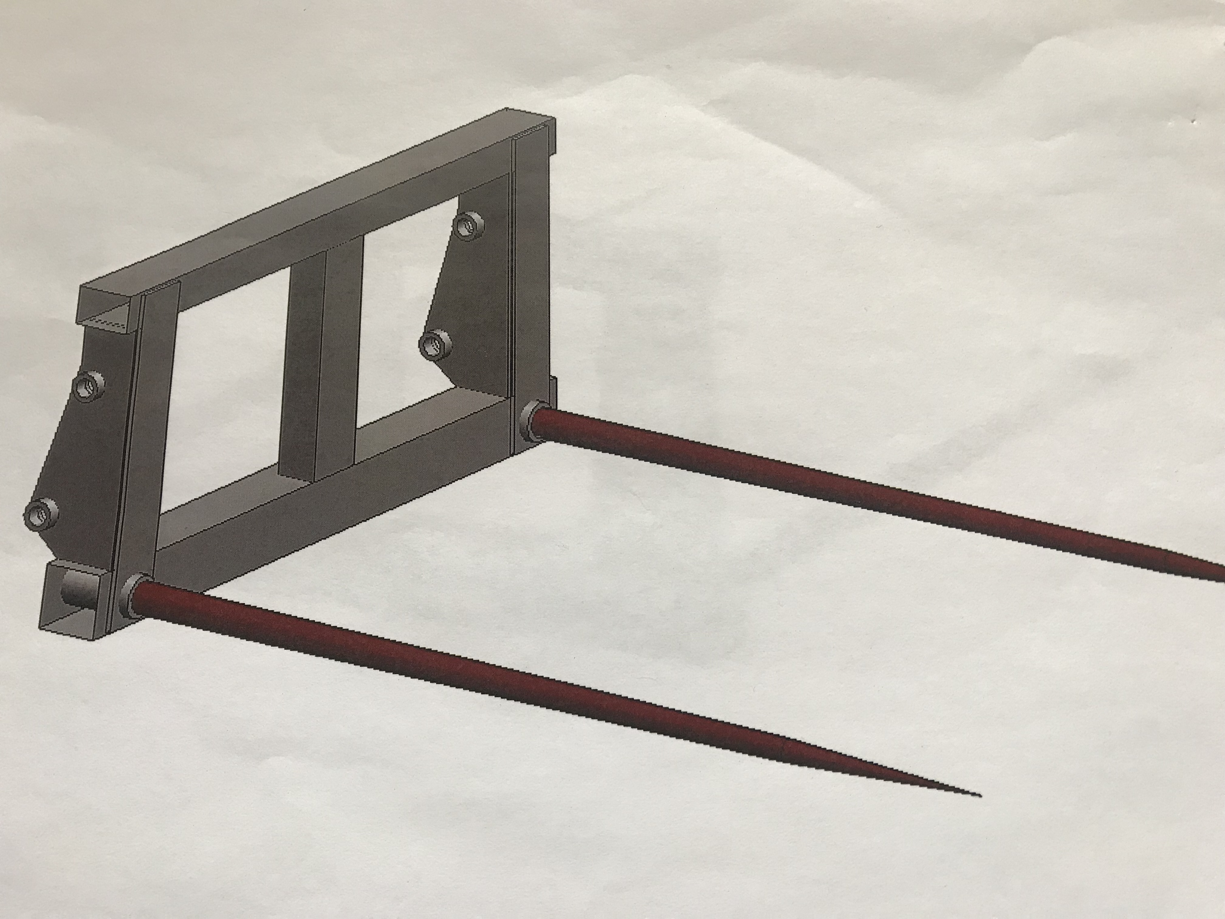

Here is my final design. I have the bale spikes and sleeves, going to the fab shop monday to get started.
   / Building FEL hay spear, have a question #28
Just make sure your spread allows you to go into a pallet.
   / Building FEL hay spear, have a question #30
Looks like enough rollback :thumbsup:.

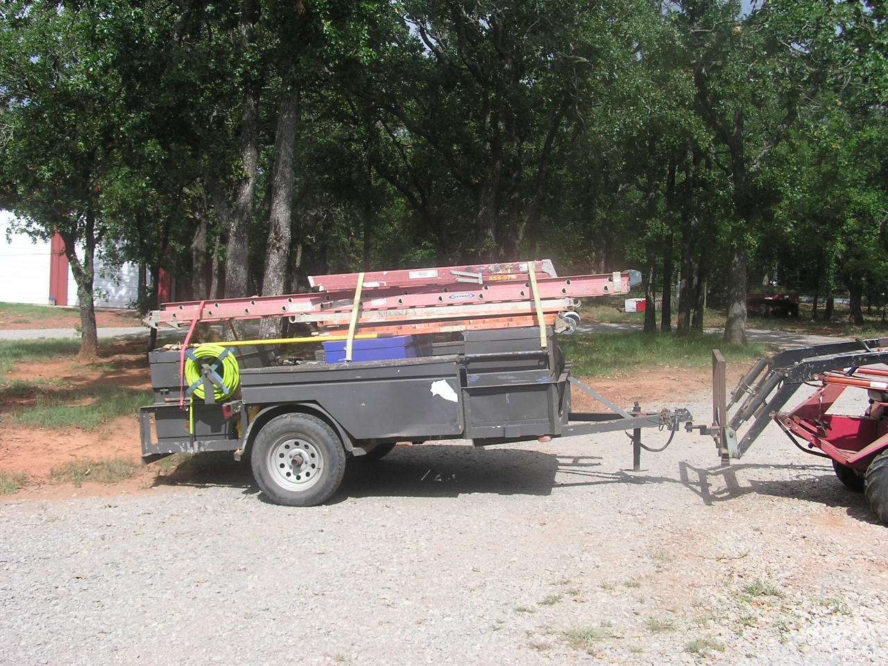

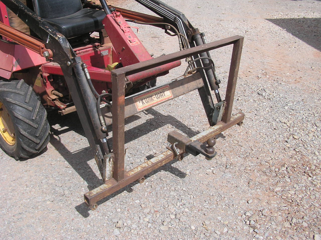

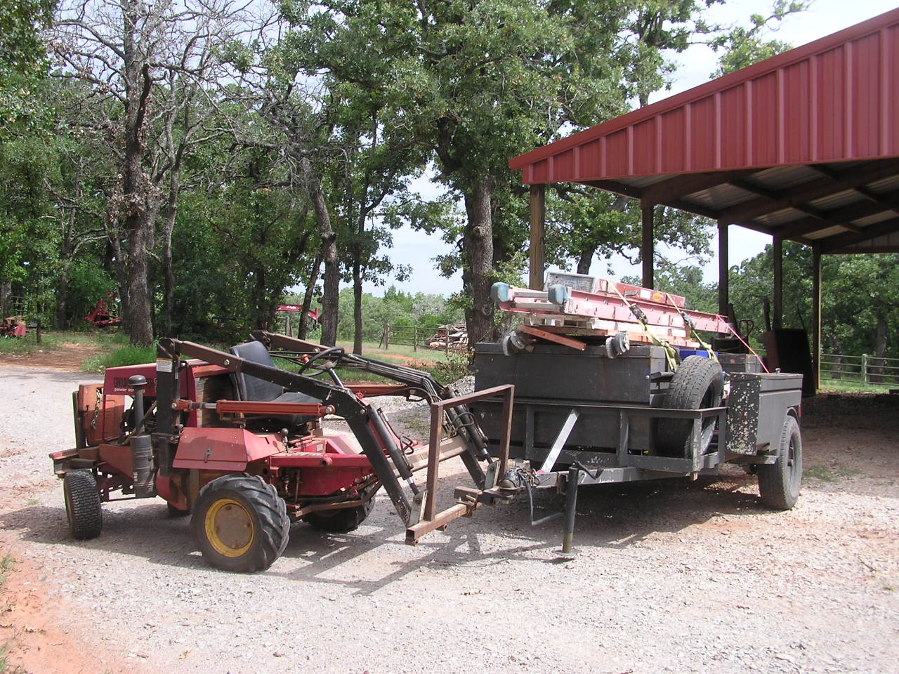

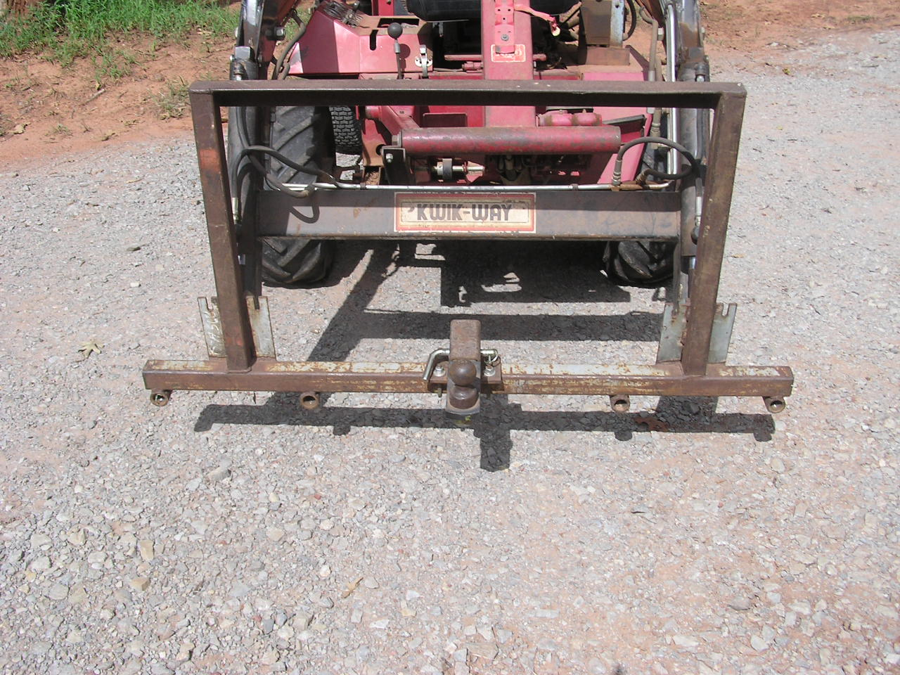

Now would be the time to build in a receiver hitch and chain slots. Also something at the top to mount a boom pole: fel boom pole - Google Search
The chain slots and receiver are visible on my brush fork frame:
Moving a trailer without getting off the seat to raise the jack:
