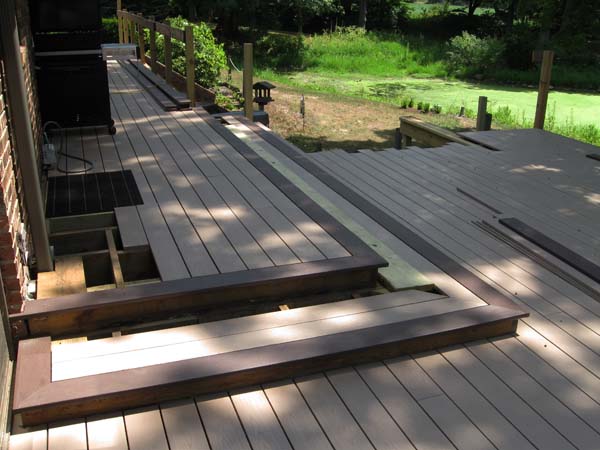

Checking this thread out again, I noticed the issue on the exposed ends of the deck. I'm sure the builder will make it look OK with added trim boards, but for anyone else doing a composite deck, consider "picture framing" it. This is what my contractor did with my Azek deck and it really worked well. It has a slight overhang on all sides. The attached photo shows steps on the deck. We used a contrasting color to give a "visual cue" for safety.

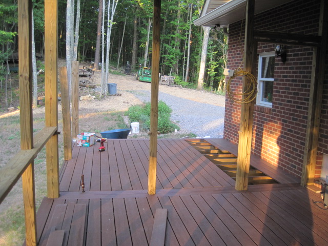

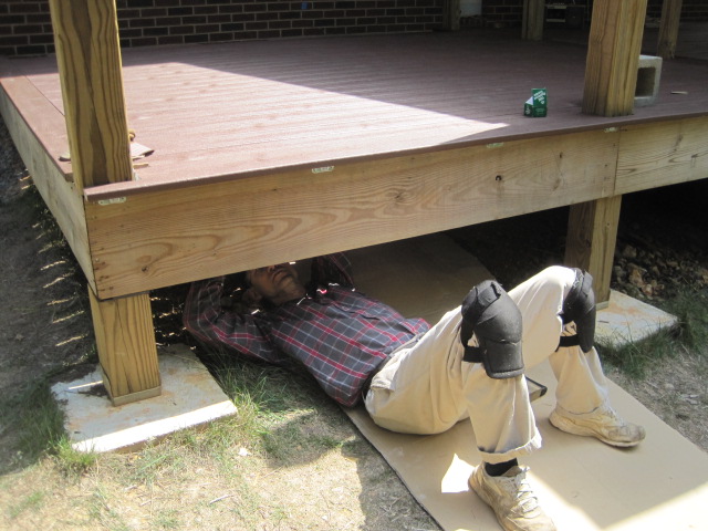

We picture framed our deck. It added a lot of time to the installation but does hide the exposed ends of the composite decking.
View attachment 317038 View attachment 317039

Yeah, I'll talk to the builder about the possibility of picture framing the outside edge. I think he can get in there with a circular saw and cut out enough of the ends to drop in some square edge Trex.
