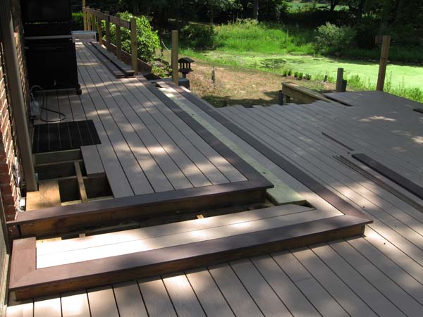

Checking this thread out again, I noticed the issue on the exposed ends of the deck. I'm sure the builder will make it look OK with added trim boards, but for anyone else doing a composite deck, consider "picture framing" it. This is what my contractor did with my Azek deck and it really worked well. It has a slight overhang on all sides. The attached photo shows steps on the deck. We used a contrasting color to give a "visual cue" for safety.
My next door neighbors did the same thing with the deck rebuild they did last year, and it sure looks sharp.
Obed
We picture framed our deck. It added a lot of time to the installation but does hide the exposed ends of the composite decking.
