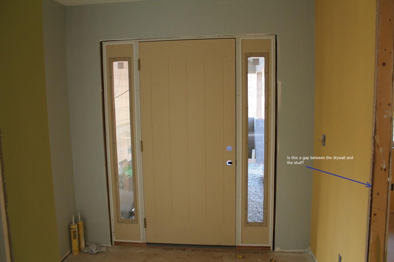

I was interested in the drywall adhesive used rather than screws. As I said I don't do this for a living so I was open to learn anything new. I noticed in the picture of your front door that the drywall seems not to be too secure to the wall opening on the far right. Is this a failure of the adhesive or a shadow in the picture. It looks like a rather large gap.

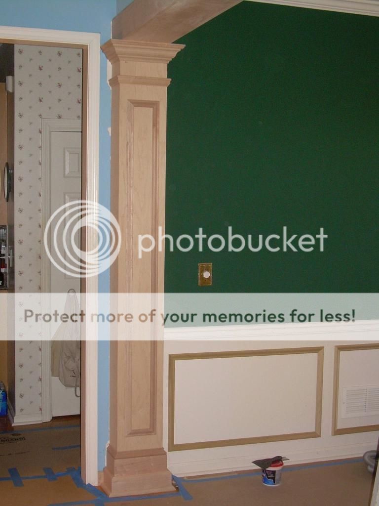

I was lamenting the fact that I don't have any close-up shots of trim miters in my "carpentry photo thread" for Peter so see, and looky what I found...a close-up of a column base and top.
This was the removal of a "plain" column and replacing it with something a bit nicer.
To be really fair, this was going to be stained, so it has to be good, it would be unfair to expect this on all your miters for paint-grade work, but it shouldn't be that far off.
****, that is scary good. Amazing, indeed. That is how it is done. Take note, Peter.

Thanks Stu, it also makes it much easier when you're "mitering" around a square box that you built yourself. It ain't hard to get good miters on sheetrock though, it can just take a little bit of "fudging". Any decent carpenter can do it, if that is what the boss is requiring.
