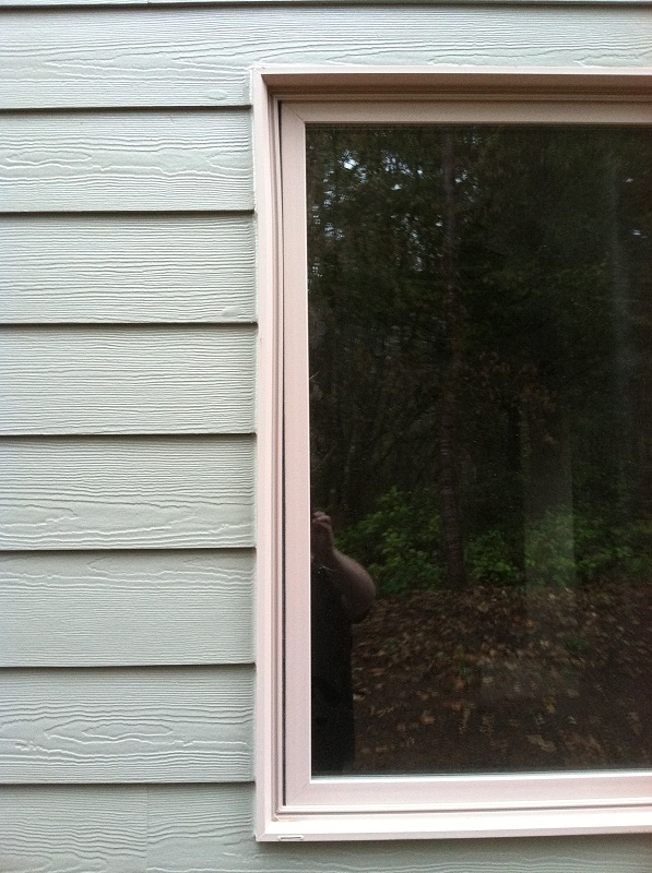

It appeared at first the slider in the sun room only needed a track pulley adjustment. Then as we went down along the edge there was a widening gap below the handle too.
This must mean the frame is not plum and bowed in in the middle. Better get a 4' level and start checking walls, door frames, window frames for vertical and floors and ceilings
for level. They won't be perfect, but should be very close. Run all the double hung windows up and down to see if they jam. operate the crank out windows. Open and close all the doors all the way. The front door should have a wiper of some sort along the bottom to seal it.
Why the door is bowed in at the top without even being latched is beyond me. Did it arrive in a box or was it just sitting in a warehouse somewhere as a returned item?

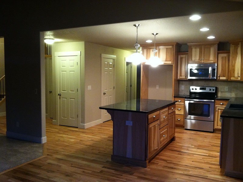

The outside corner baseboard is just like I was explaining about inside corners. They are not at 90 degrees after the mud is put on. On an outside corner they have to under angle the 45 cut and then file or sand away material from both pieces till they fit tight. If the try to just adjust the angle on one side it will appear as one board is thicker than the other. If they file that off you will have a rounded corner. Do they have a miter saw on site?
Baseboards are normally a little thinner than door trim for obvious reasons. It looks like your stuff is all the same thickness.
Not to argue with your neighbor, but the amount of filler your trim is going to need is way too much. You will be able to see the varying thickness from the filler
along the edge of the boards with your naked eye. The joints will probably separate. Paint can only stretch a little bit.
When these guys tell you, "that's the way we do it" tell them that's not the quality you are paying for. If they won't budge make them give you a warranty in writing that
problems won't develop from their method.

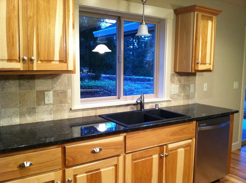

Yeah front door, sliding door, unacceptable. The "ugly" corner is pretty sad I don't recall seeing anything that bad when my house was built. Its not going to be perfect though, a bunch of 2x6's nailed together with some sheet rock is not exactly a precision surface to work with. The painters made mine look spectacular but the ugly corner that's liptstick on a pig there. That kitchen window...agree. I will say all my hardwood trim and all the natural wood on the stairs to the 2nd floor is furniture quality craftsmanship, I was impressed they were able to do that with a portable contractor saw.
Here's an idea, take a look at these two pics. This trim is in a 'craftsman' style not much different that what you are doing with two exceptions. The rails (trim) along the top of the doors and windows are thicker than the stiles and overlap the stiles about 3/8 inch on each side. The different thicknesses give it some depth and both the thickness difference and overlapping is a lot more forgiving vs trying to cut things super accurate.
Does this look familar? I made them rip this out and fix it, no way you jam a window in like this on new construction.

I'm with Dave. :thumbsup: I'm not a big fan of the base board and door casing being the same stuff, too difficult to get a good/even joint, if the carpenters don't care. If the casing is thicker than the baseboard, the base just kills into the casing nicely with the reveal similar to what Dave was saying for the casing header (which I would like to have seen done as well.)
