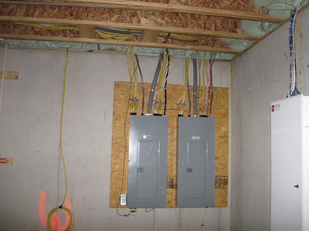

While I agree that the overall appearance of the wiring is important. But, don't overlook the accuracy! I was pleased with the overall neatness. I don't have any inside pictures, but the inside also looks fairly nice. What came as a surprise is the mistakes. I have recently identified numerous labeling errors. I have one circuit that is labeled on 2 breakers. I have a bedroom circuit that is not on an arc fault circuit interrupter. I found a breaker that was not labeled at all. And my favorite, I found a circuit wired with #14 that is on a 20A breaker (it is an AFCI). I would at least spot check the labeling.
Here is a picture of the closed panels at my house. I was pleased with the overall appearance. I never thought to do any testing, or even look at labels and notice that there was a circuit labeled the same in both panels.
