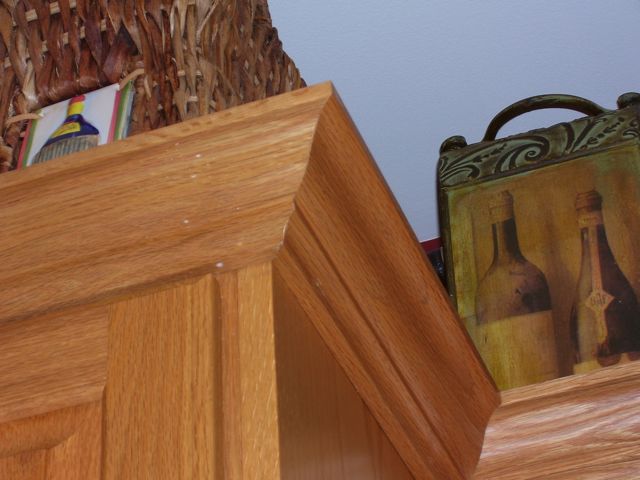

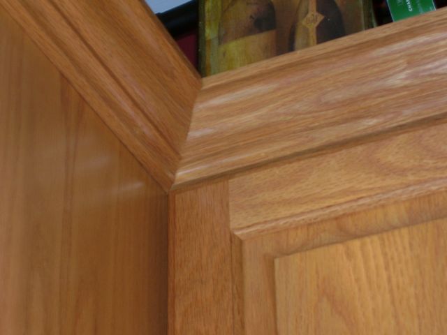

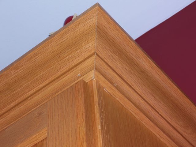

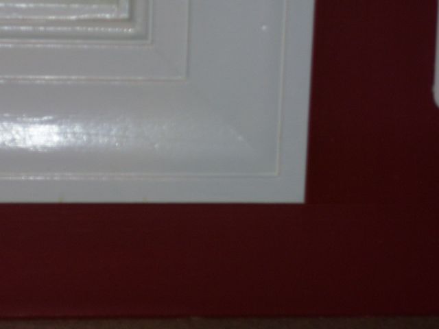

Also here are a couple of pictures of how the trim was done in my house. The trim carpenter only did finish work for the builder including the installation of cabinets and building shelves. What a perfectionist he was! Didn't matter if it was cabinets or base trim, he always took pains to make it right.
That's what it's all about...taking pride in your work. My first boss, a Norwegian physical therapist, made his own furniture out of teak. I went to his house one day and he wanted to show me a dry bar he had built. First thing he did was pull it out from the wall and, with absolute pain on his face, admitted that he put a plywood back on it. Mind you, NO ONE would have ever known, but he did. It was absolutely beautiful. We re-build his daughter's VW bug and when we got to the part of refitting the pistons, I told him I needed a clean piece of wood about a foot long. Sven went into his shop and was gone...10 minutes....15 minutes... I finally went in there to see what was taking so long and here he was, planing a piece of white oak, exactly 12 inches long.
It's a shame that all the good framing work in this house is being covered up by people who obviously don't take pride in what they do. Don't let them ruin what was destined to be a very nice little house for your Mom.
