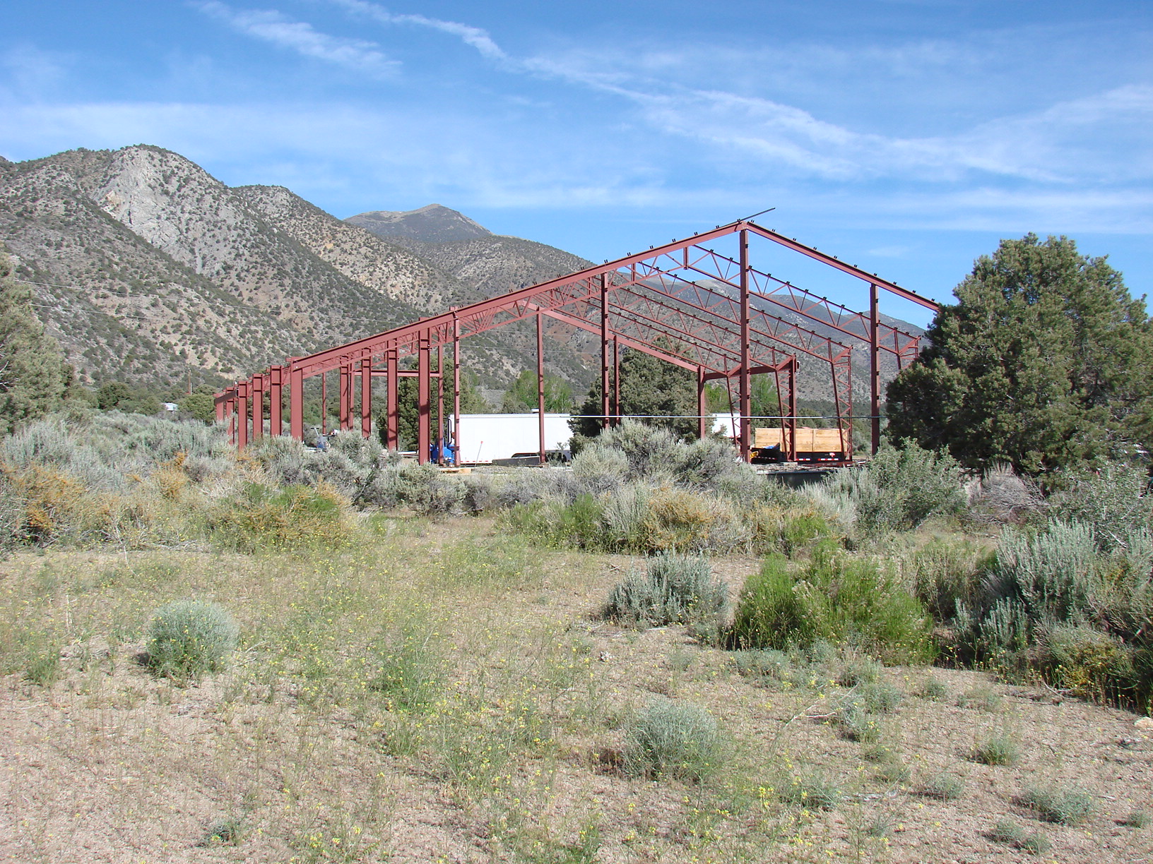

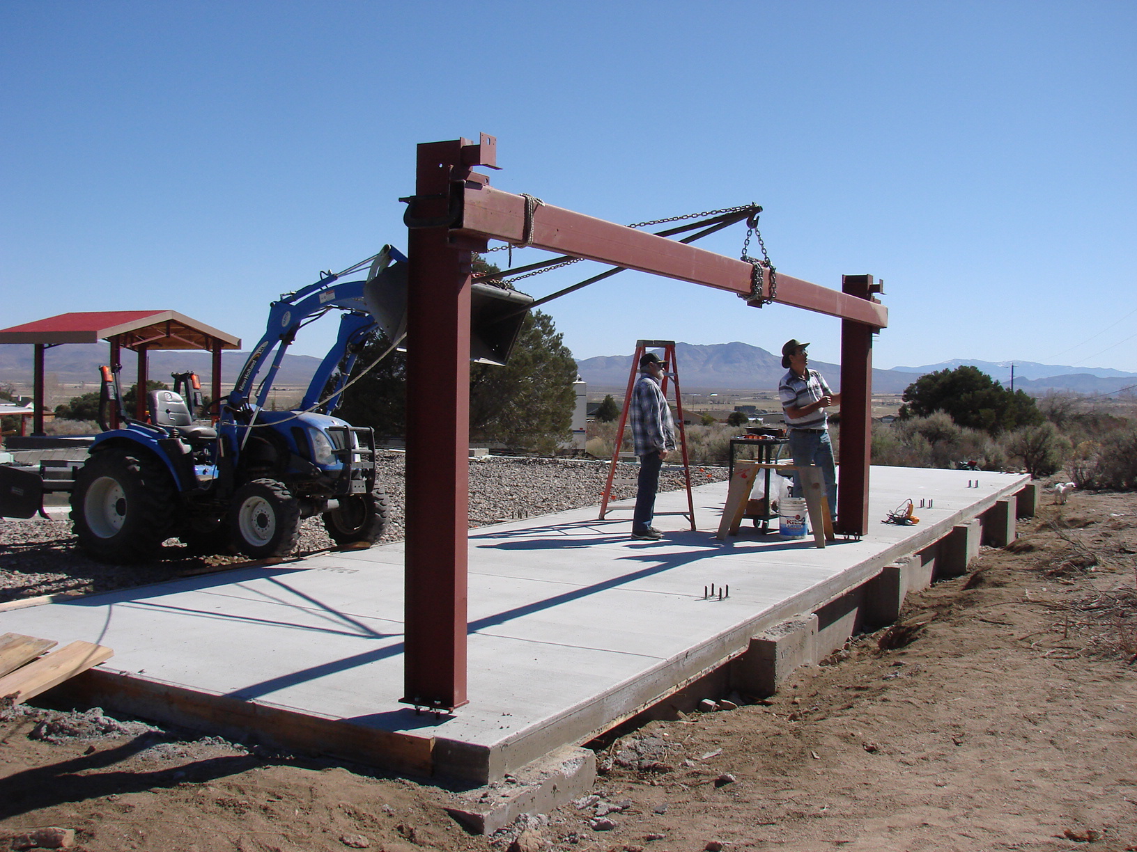

/ Building a Steel Barn #17

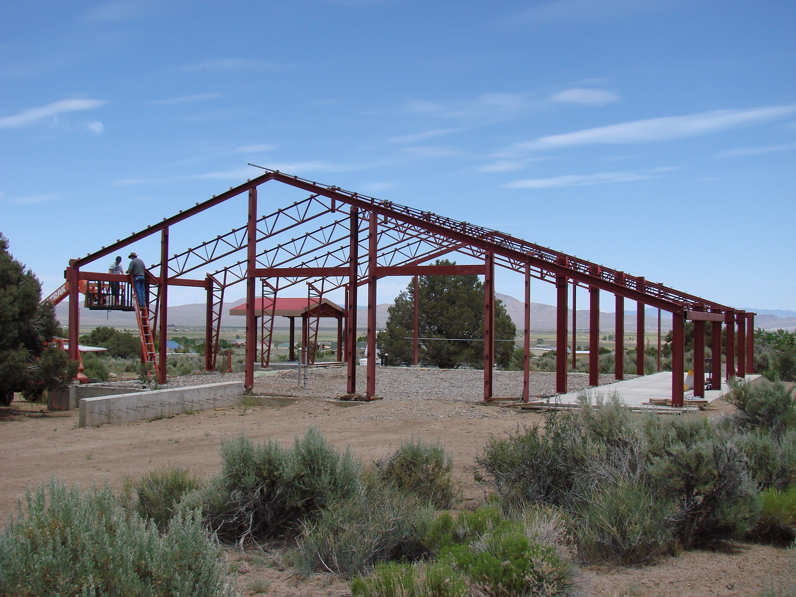

Here are some more pix of our project. Next is the roof.

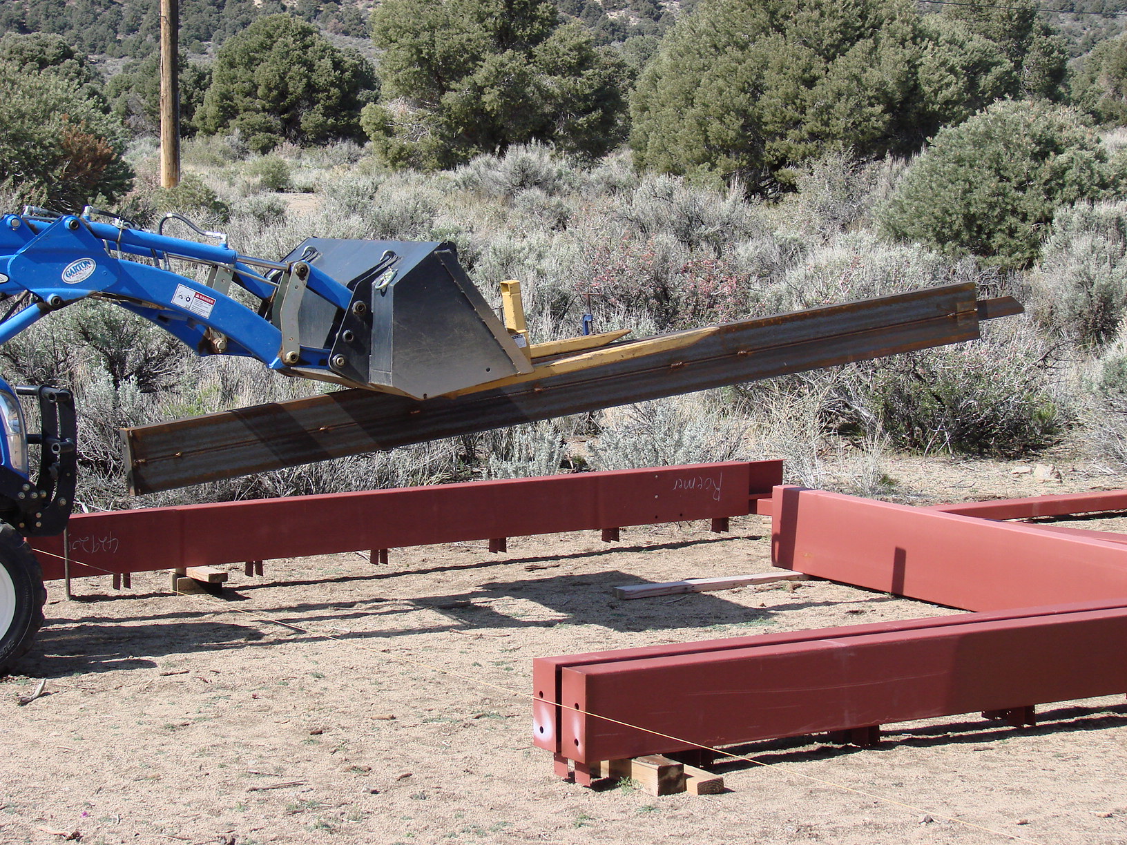

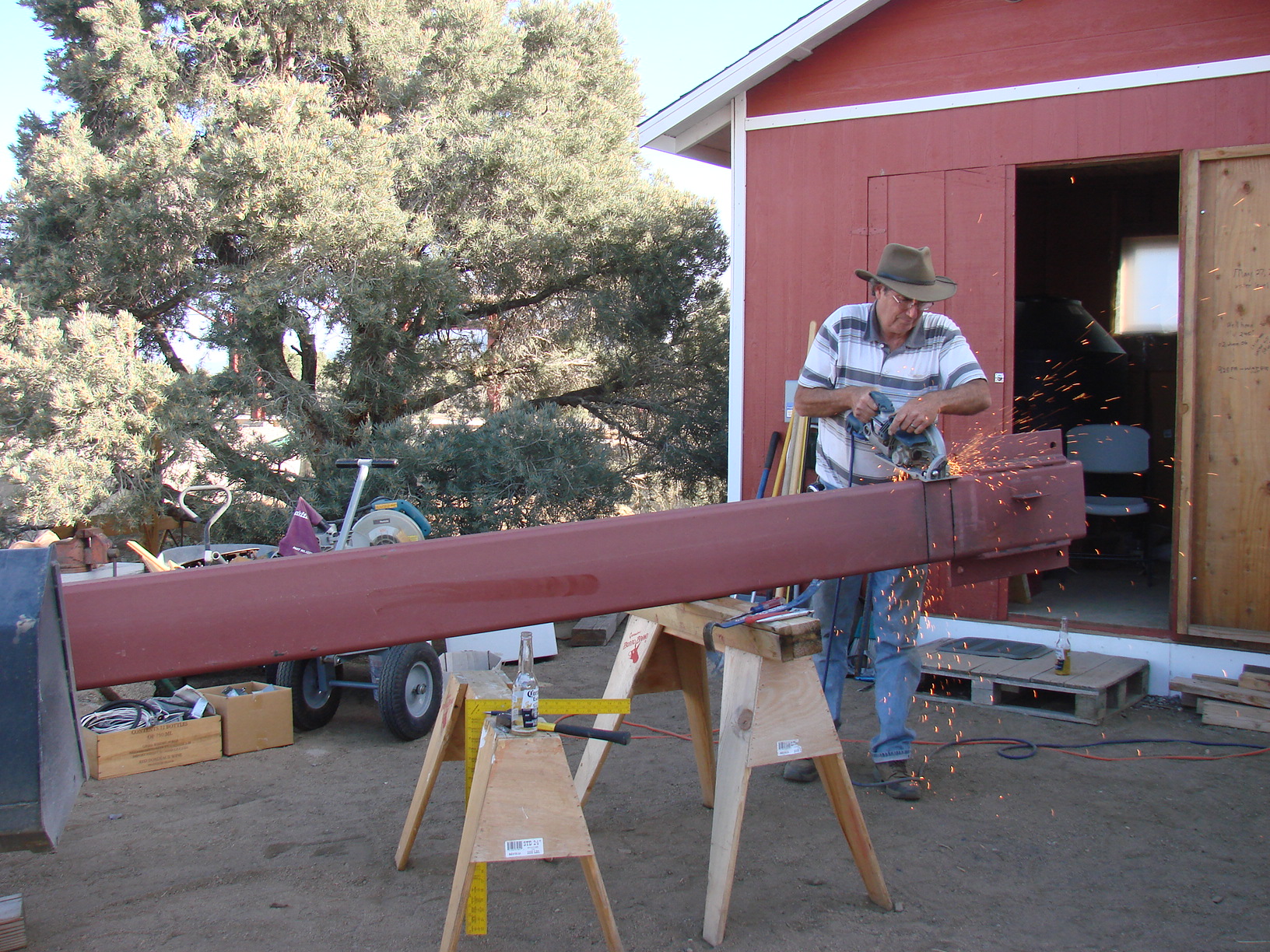

/ Building a Steel Barn #18
More pix

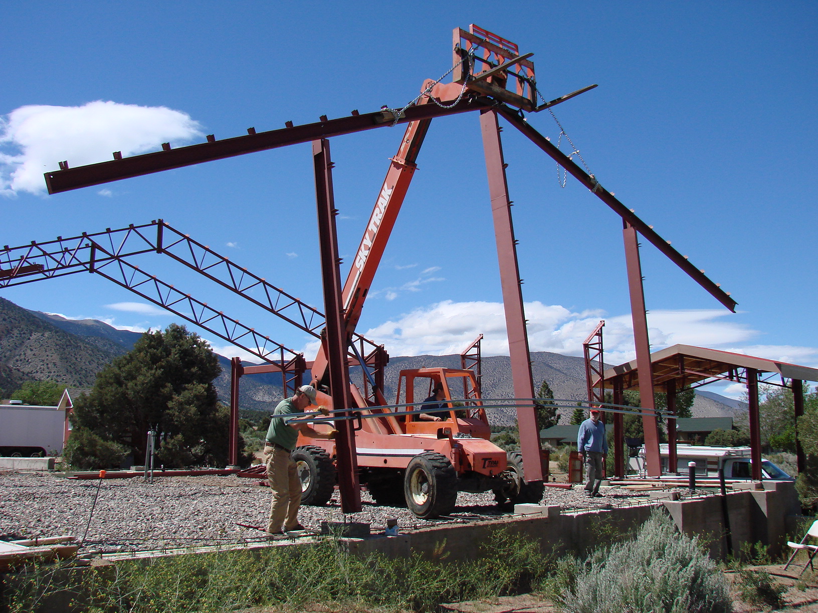

/ Building a Steel Barn #19
Still more

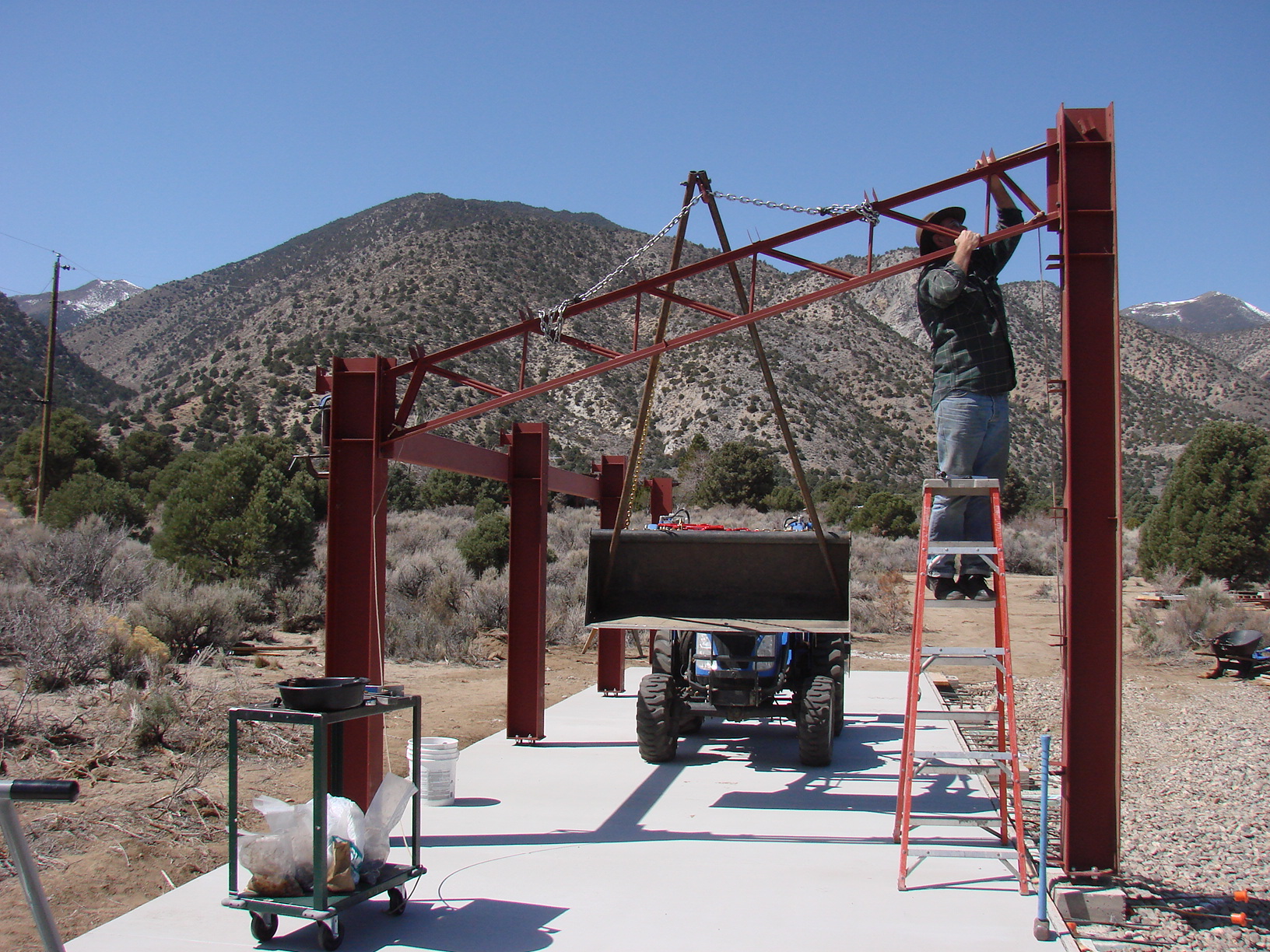

/ Building a Steel Barn #20
Some things that have really been helpful with this project are the basket for the forklift made from scrap steel, the A frame in the tractor bucket made from 1 1/4 inch pipe and chain, the tractor which has moved many, many tons of material, dug the foundation, dug about 700 feet of ditch, dug the septic tank hole and graded the whole area.
