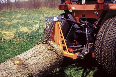

Looking good! Here is a pic I collected but can't remember where. Maybe it will help with some ideas or finishing touches?
What I found interesting is how to use the top link (if hydraulic) to raise the log and the "guard" portion that prevents the log from pushing into the tractor.
Actually that was what gave me the idea to build it. Its a Norwood log skidding attachment, they sell them through Northern tool amongst other places.

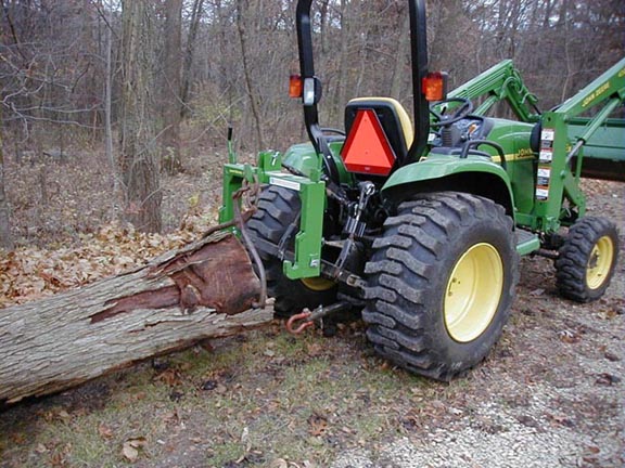

/ Building a small 3pt hitch logging arch #12
I have been using this one. Sure is nice to be able to pick some fairly good sized logs and keep them clean for the most part while skidding them out of the woods. Have about 60ft of line on the winch now, but haven't used it. Having the hooks on the frame make for multiple logs. With the tongs it is just one at a time, but you get more lift with it.

/ Building a small 3pt hitch logging arch #13
sorry for the double up. here is a side view
