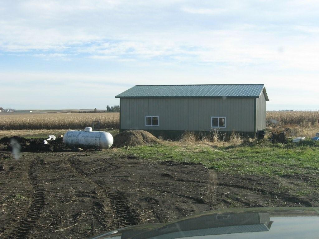

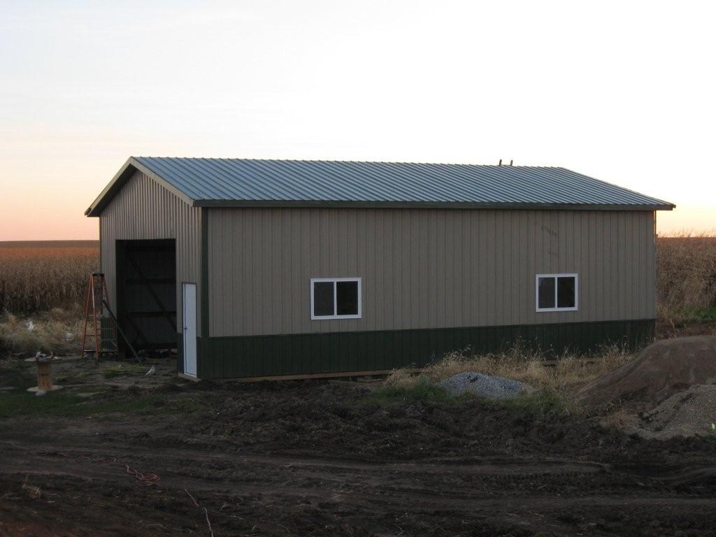

/ Building a Shop
#144
Last pics I took before it got dark last night.

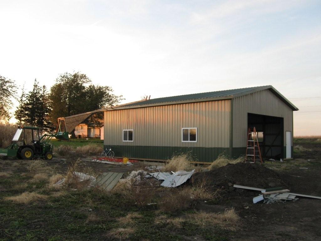

/ Building a Shop
#145
Latest status:
Just an update on the shop project. The roof's complete, including the ridgecaps/vents. Most of the trim is up, just missing a couple pieces on the back end of the roof (corner pieces on the roof edge). Have a few spots that I need to go back over and finish screwing down the wall steel, but it's all on pretty solid. The electricians put in the panel and an outlet a few days ago, no more hundreds of feet of extension cords! :) Found out that the overhead door will be installed tomorrow sometime, which will pretty much finish off this year's part of the build.
