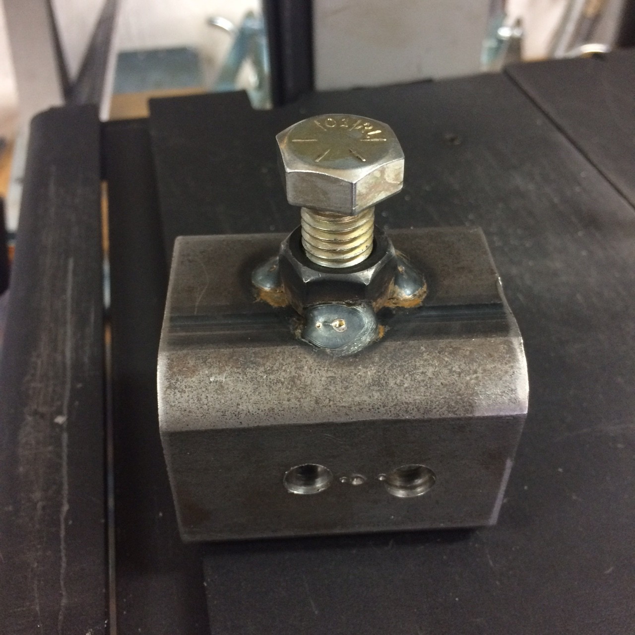

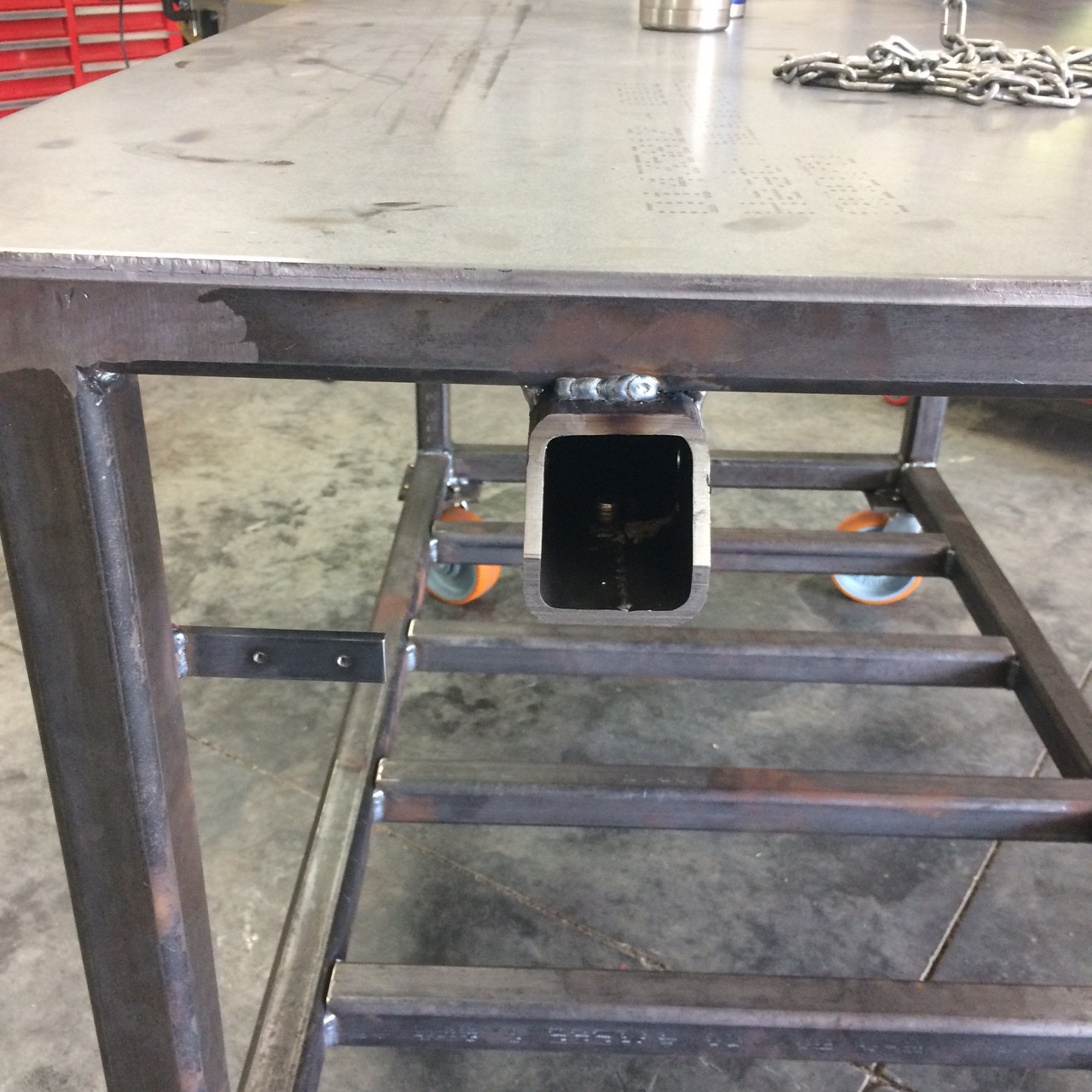

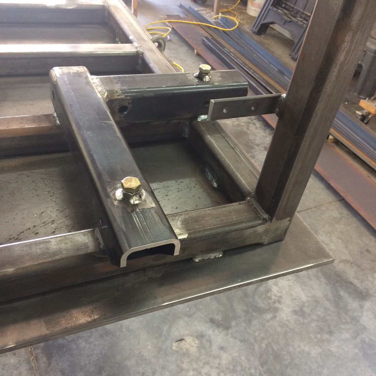

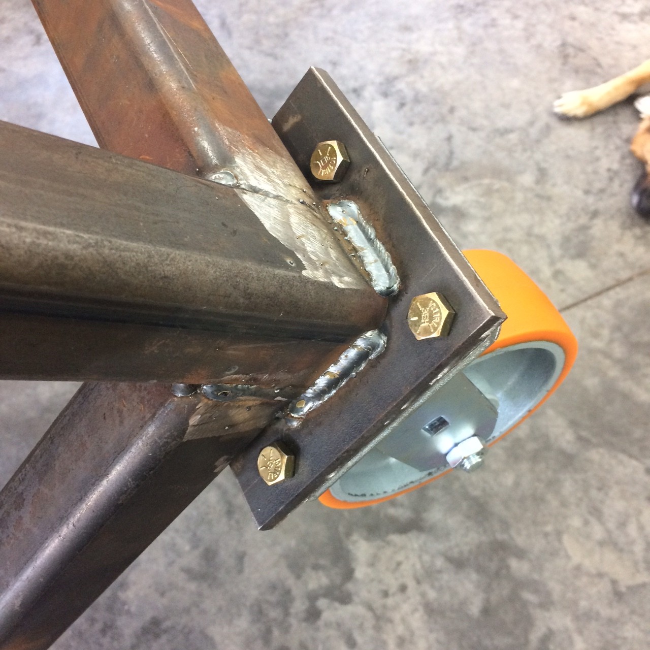

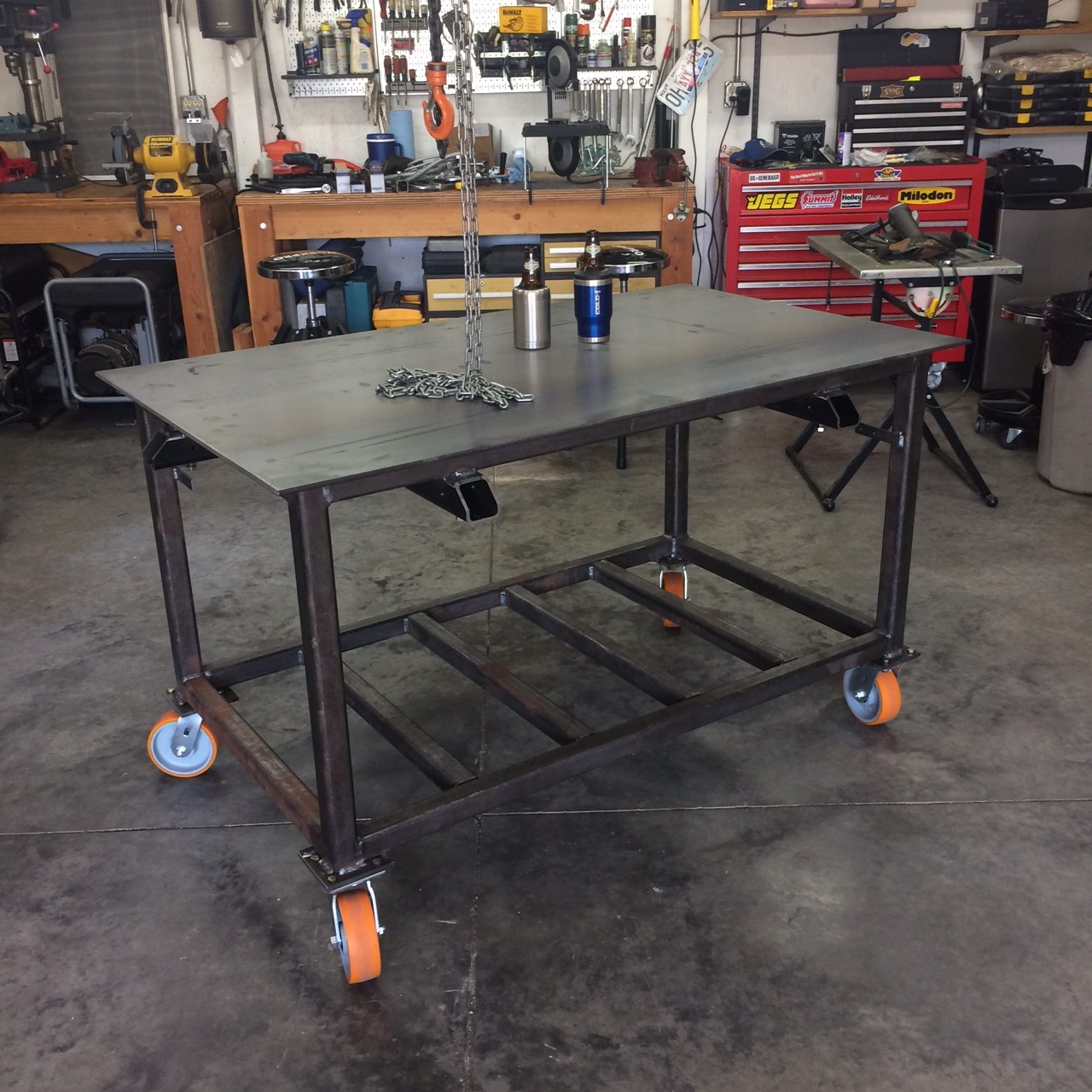

It rolls, and it rolls easy!! My son came over on Saturday and did a lot of welding. My neighbor helped me flip it over and install casters late that afternoon. I've already gotten it dirty, had to work on a couple PTO shafts on Sunday.
We did a bunch of practice on the 1/2 nuts before we welded them on the receivers. I drilled 9/16 holes in the tube and inserted the bolt from inside the tube, nut on the outside, tightened it while keeping it centered. I covered the exposed threads with nozzle gel. We did 3 very small tacks to start, then we welded. We did not start the weld at the junction of nut and tube, instead started it on the tube about 1/4 - 3/8 away, and walked it up the side of the nut. We welded every other flat. Let it air cool and then used a box end (12pt) to the get bolt out. Since I had it, I ran a thread chaser / cleaner through them. They can out great, the nuts are level, centered on the hole, the bolts thread in easily by hand.
The casters were worth every penny I can roll the table using 2 fingers. I really have to get the floor locks on!
It was a good weekend! It's not done, have a lot of small things to do: Clamp racks, grinder rack, electrical outlets, expanded metal on bottom shelf, mig gun holders, paint, floor locks... The first receiver attachment project - the vise.

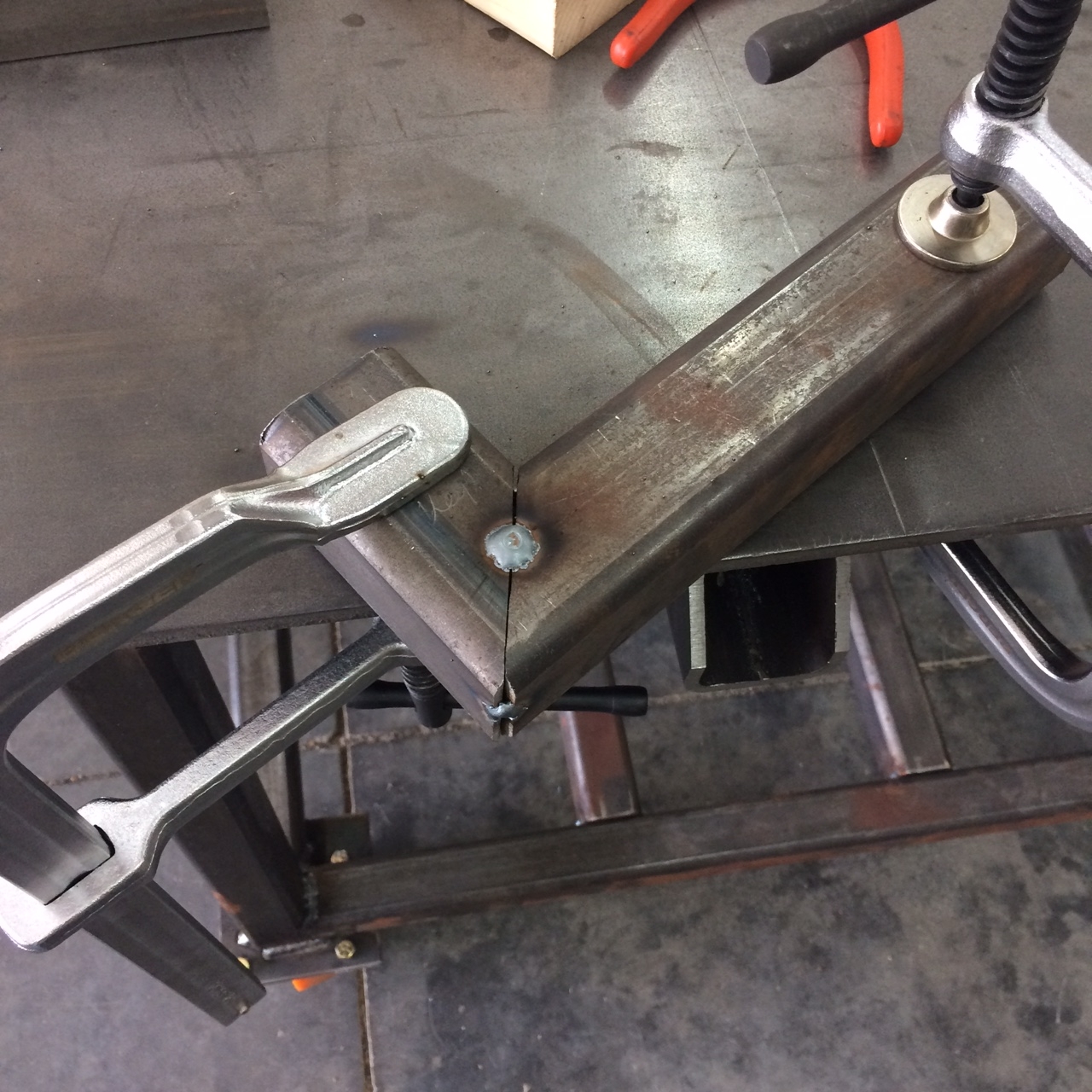

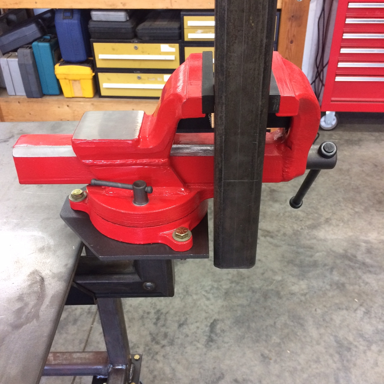

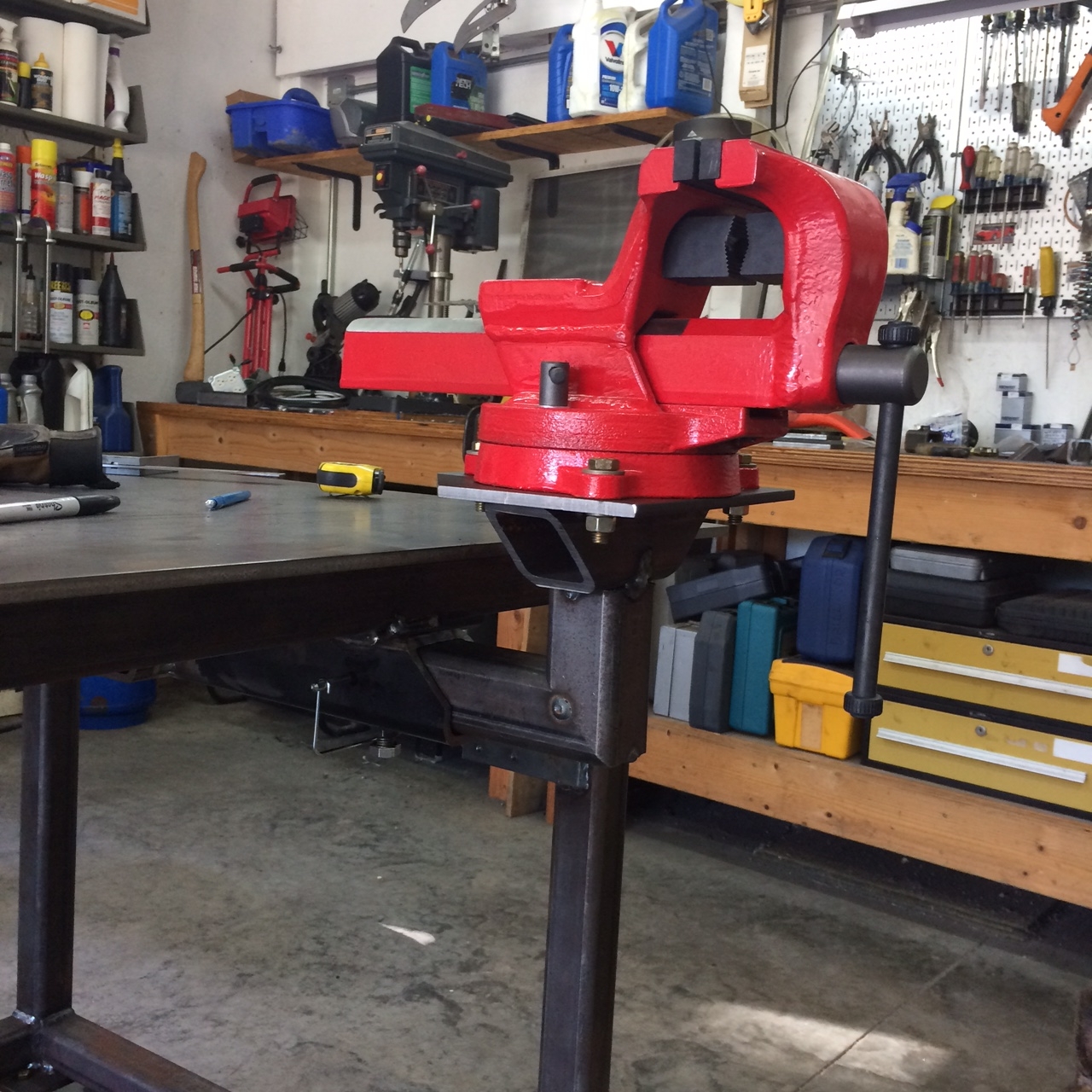

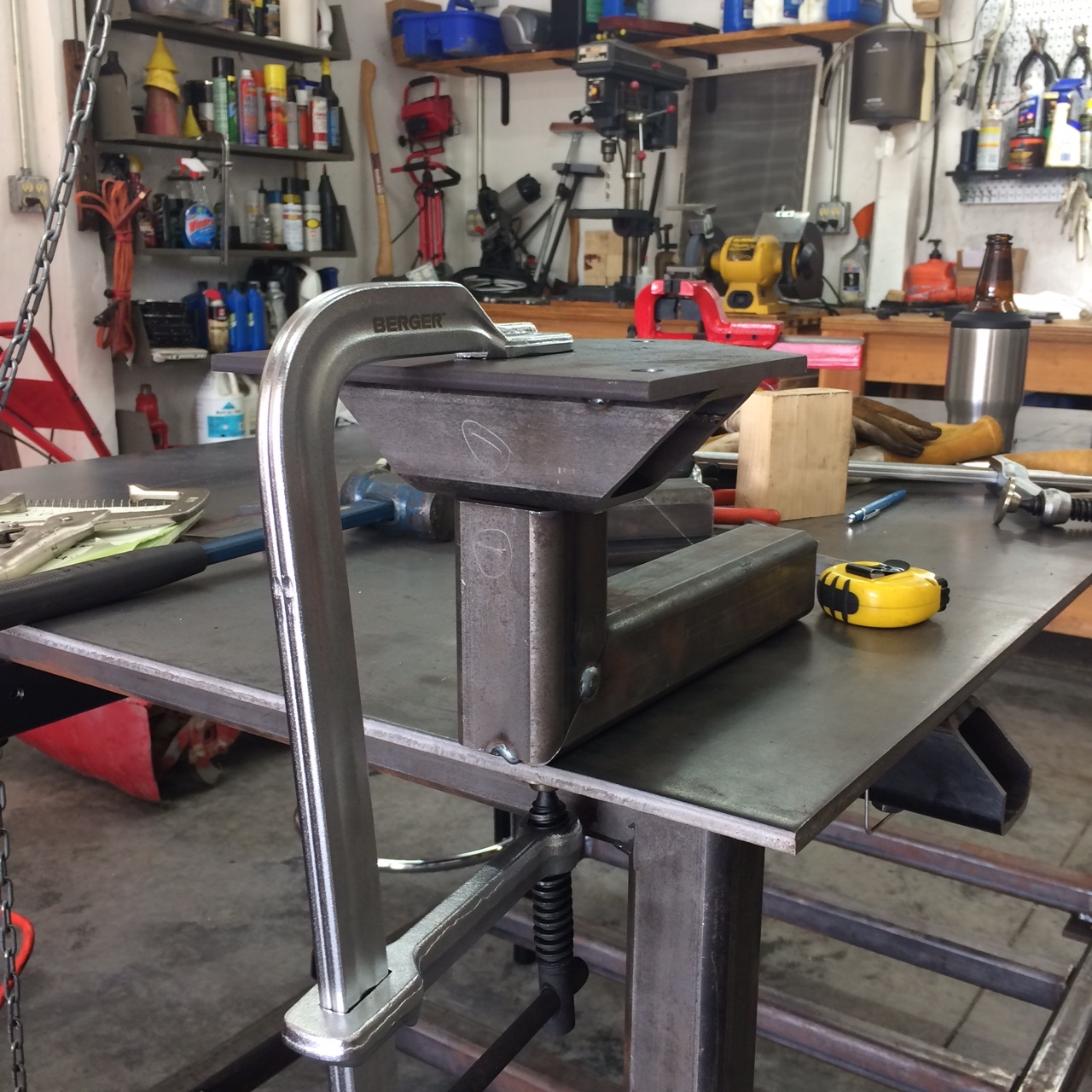

Worked on the vise mount for the receiver tube this last weekend. None of it is "welded" yet, just tacked together to see if I like the height and positioning away from the table. And of course I was supervised by Bella the shop dog...
Anyone see anything that jumps out at them about the design - input always welcome.
This weekend I will adjust it if needed and weld it up. Next is the expanded metal bottom shelf and electrical outlets.

- - - STOP - - -
If you haven't already welded your vise insert yet, I would STRONGLY recommend one of three things -
Either vee out everywhere the tacks are NOT before welding it up, or
Cut those tacks out, and either
fit the pieces back up, but space them apart (washers work good, keep the weld lines parallel but with a gap), or
Bevel at least 2/3 of the material thickness on all edges... (my preferred method)
THEN re-tack and weld it up - (you can pry the washers out AFTER tacking and BEFORE weld, if you used 'em)
Reason for this - it's a VISE. Unless you're only EVER gonna use it to work on jewelry or watch repair, sooner or later you're gonna want to clamp something HARD and grab a big hammer (or cheater bar) - when that happens, it would be nice if your welds had good penetration...
If you were already gonna do something like the above, then don't bother reading this :D ...Steve

I was not going to do that, but it makes sense... I will cut it apart and bevel the edges, re-tack and then weld. I might get my son to weld it for me, he is a much better welder, I am still a newby. Thanks for the advice!
I plan on making a few knives, but no watch repair :laughing:
