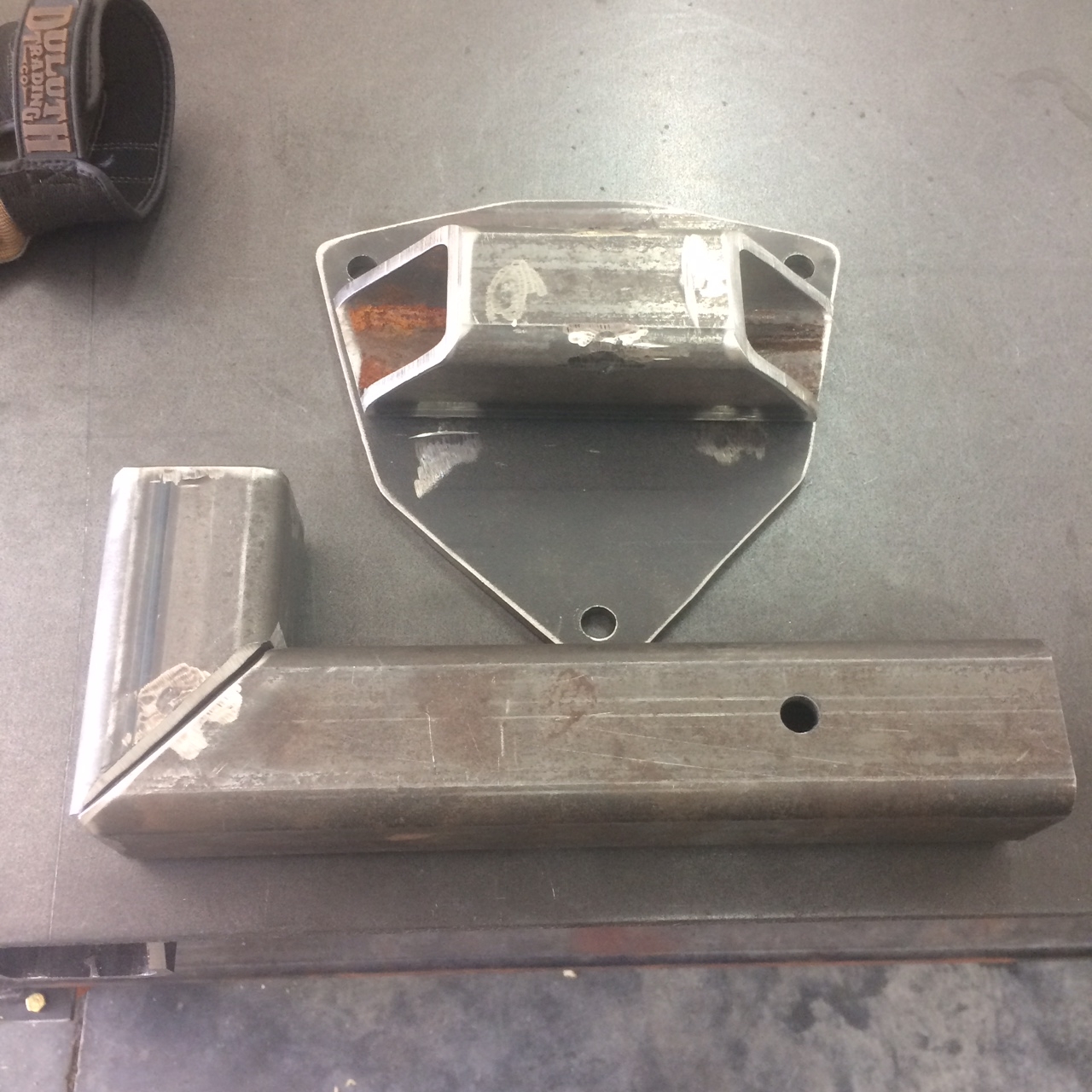

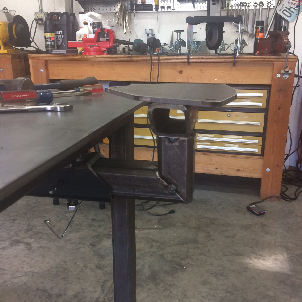

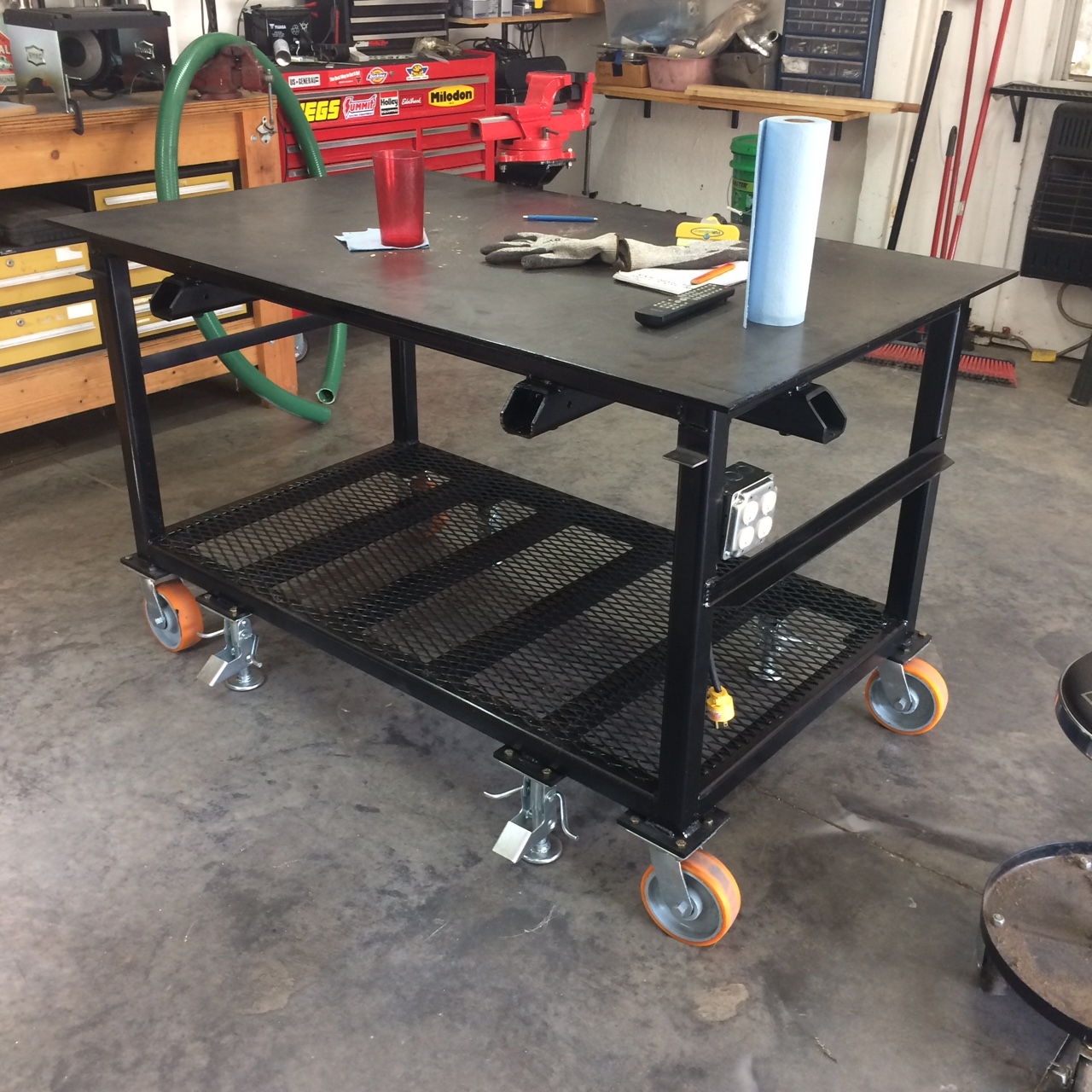

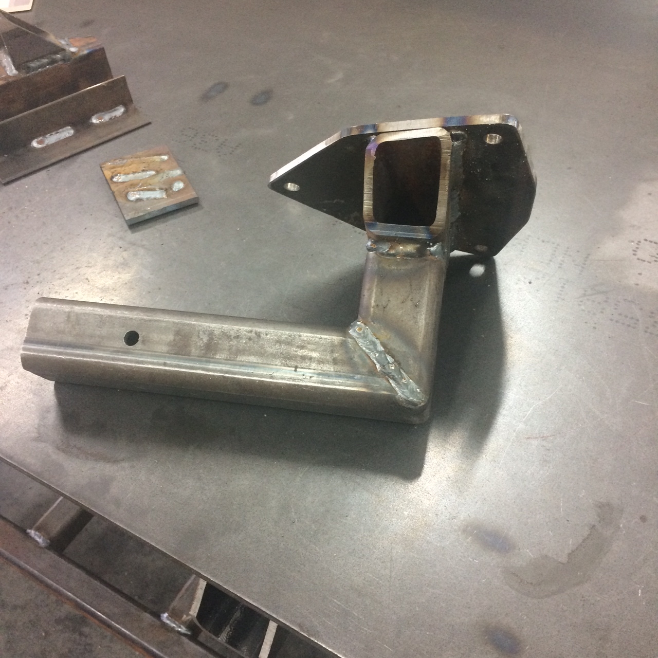

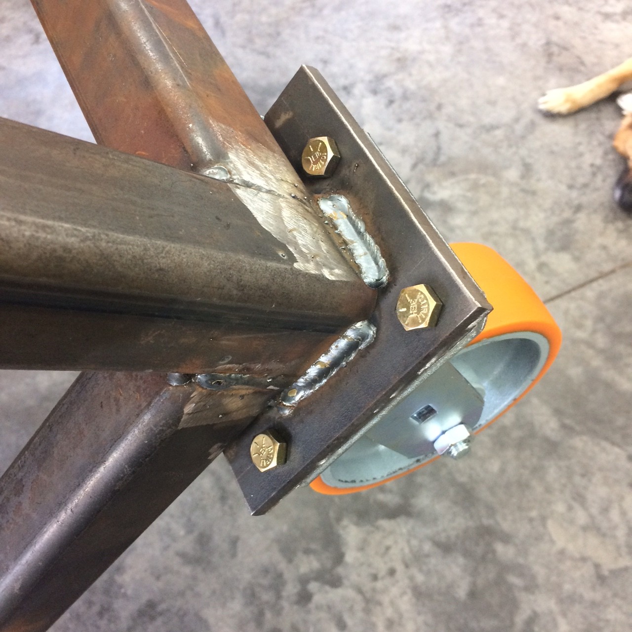

It rolls, and it rolls easy!! My son came over on Saturday and did a lot of welding. My neighbor helped me flip it over and install casters late that afternoon. I've already gotten it dirty, had to work on a couple PTO shafts on Sunday.
We did a bunch of practice on the 1/2 nuts before we welded them on the receivers. I drilled 9/16 holes in the tube and inserted the bolt from inside the tube, nut on the outside, tightened it while keeping it centered. I covered the exposed threads with nozzle gel. We did 3 very small tacks to start, then we welded. We did not start the weld at the junction of nut and tube, instead started it on the tube about 1/4 - 3/8 away, and walked it up the side of the nut. We welded every other flat. Let it air cool and then used a box end (12pt) to the get bolt out. Since I had it, I ran a thread chaser / cleaner through them. They can out great, the nuts are level, centered on the hole, the bolts thread in easily by hand.
The casters were worth every penny I can roll the table using 2 fingers. I really have to get the floor locks on!
It was a good weekend! It's not done, have a lot of small things to do: Clamp racks, grinder rack, electrical outlets, expanded metal on bottom shelf, mig gun holders, paint, floor locks... The first receiver attachment project - the vise.
Looks great! The only thing I would recommend is to round the sharp corners of the caster mounting plates to save yourself some ankle pain.

Ford850: I will round those corners.

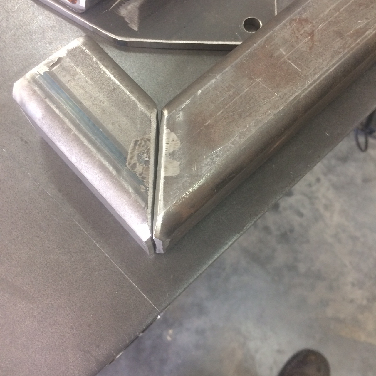

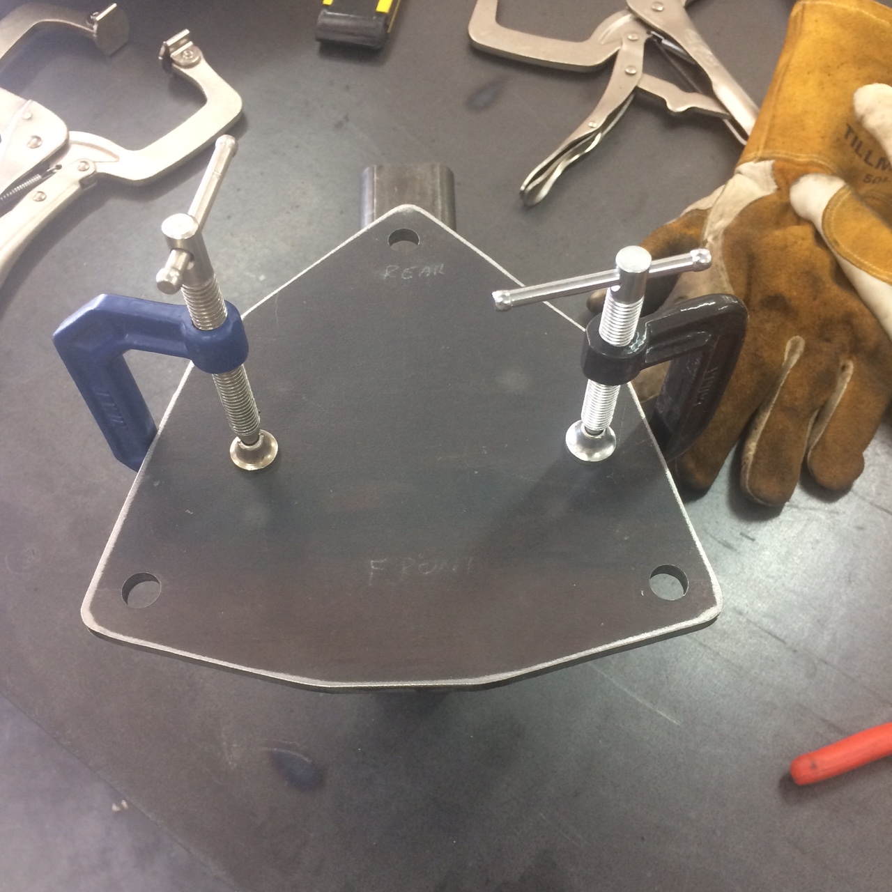

I did shed a tear, but I cut the vise mount apart :) After taking it apart I ground off the tacks and beveled the edges. My son and I welded it up this last weekend - he more than I! Tonight I will clean it up and give it a coat of primer. Also on tonight's list is to cut the expanded metal shelf to fit.

I completely understand; I felt so bad having to say something that it took 3 times reading your post before I finally decided I'd be doing you MUCH LESS of a favor by NOT saying something; as it is, it looks like your welds should have no problem meeting or exceeding the parent metal strength... Steve

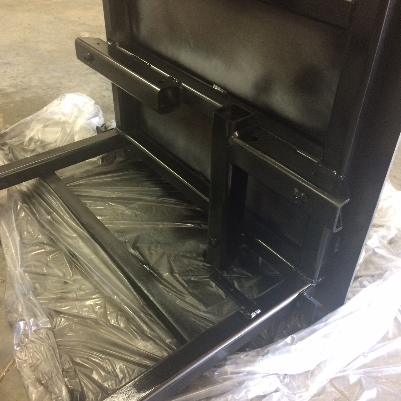

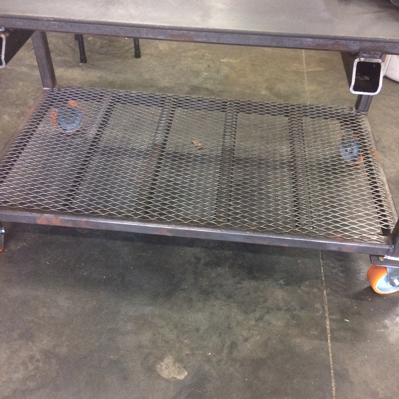

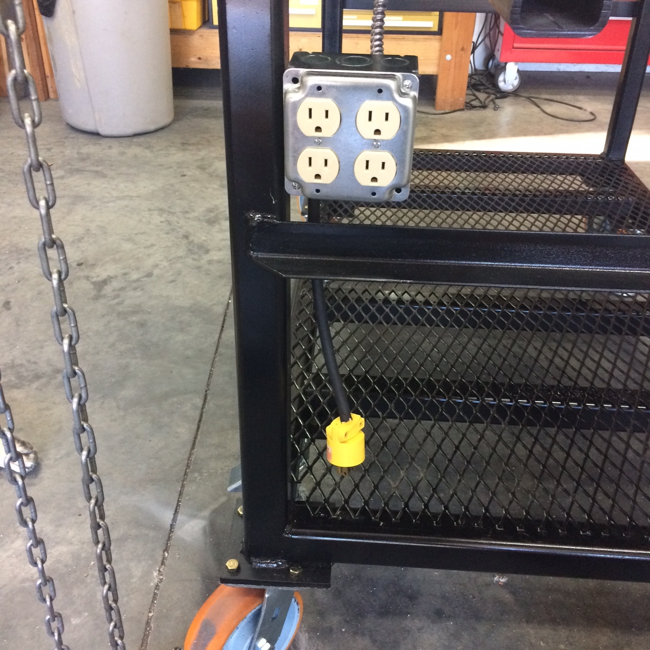

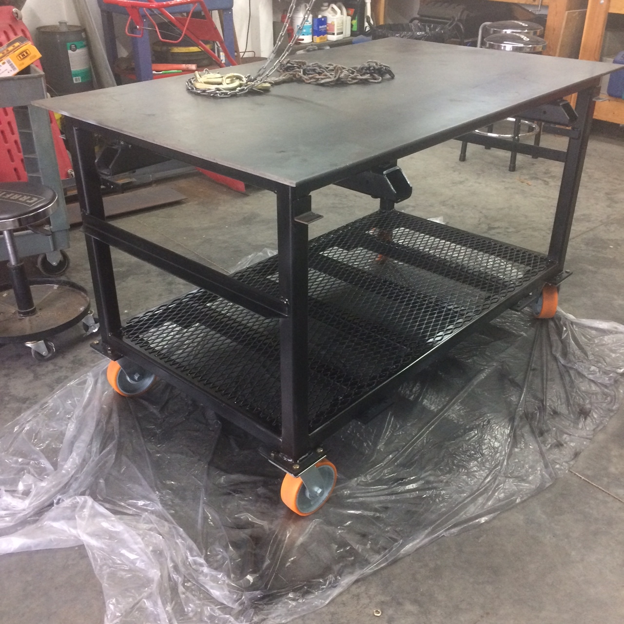

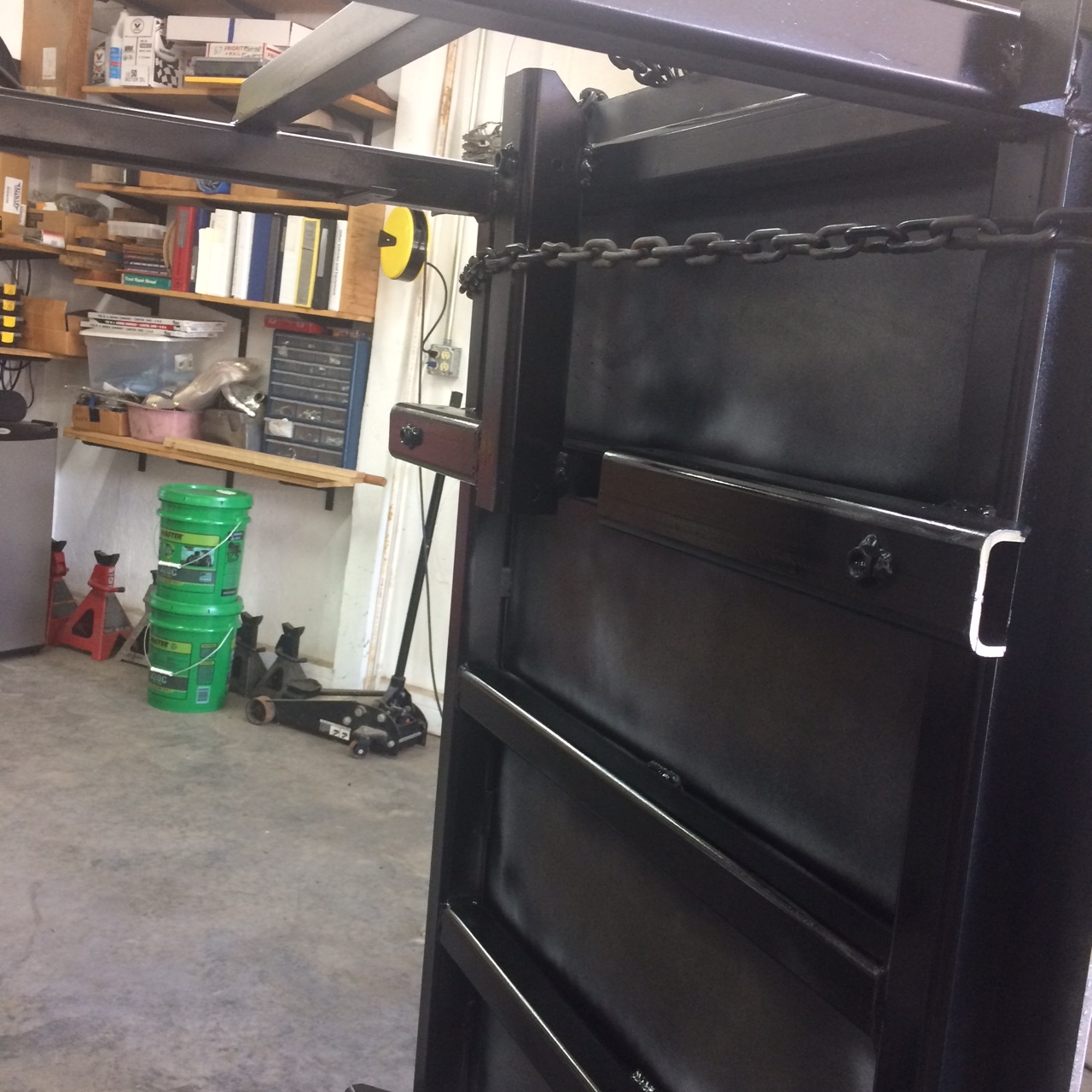

And it's done (part 1) Since I have about 11 Pics I will split this between two posts.
Weekend before last I finished up the basic construction of the table. I added clamp holders to both ends and the expanded metal bottom shelf. Also welded a piece of angle iron on each corner near the top as a ground clamp attachment point. And finally: welded the 3/8 x 5 x 5 plates (4) under the bottom rails for the floor locks. Now that I have it together, time to take it apart - took off the casters and floor locks to prep for painting

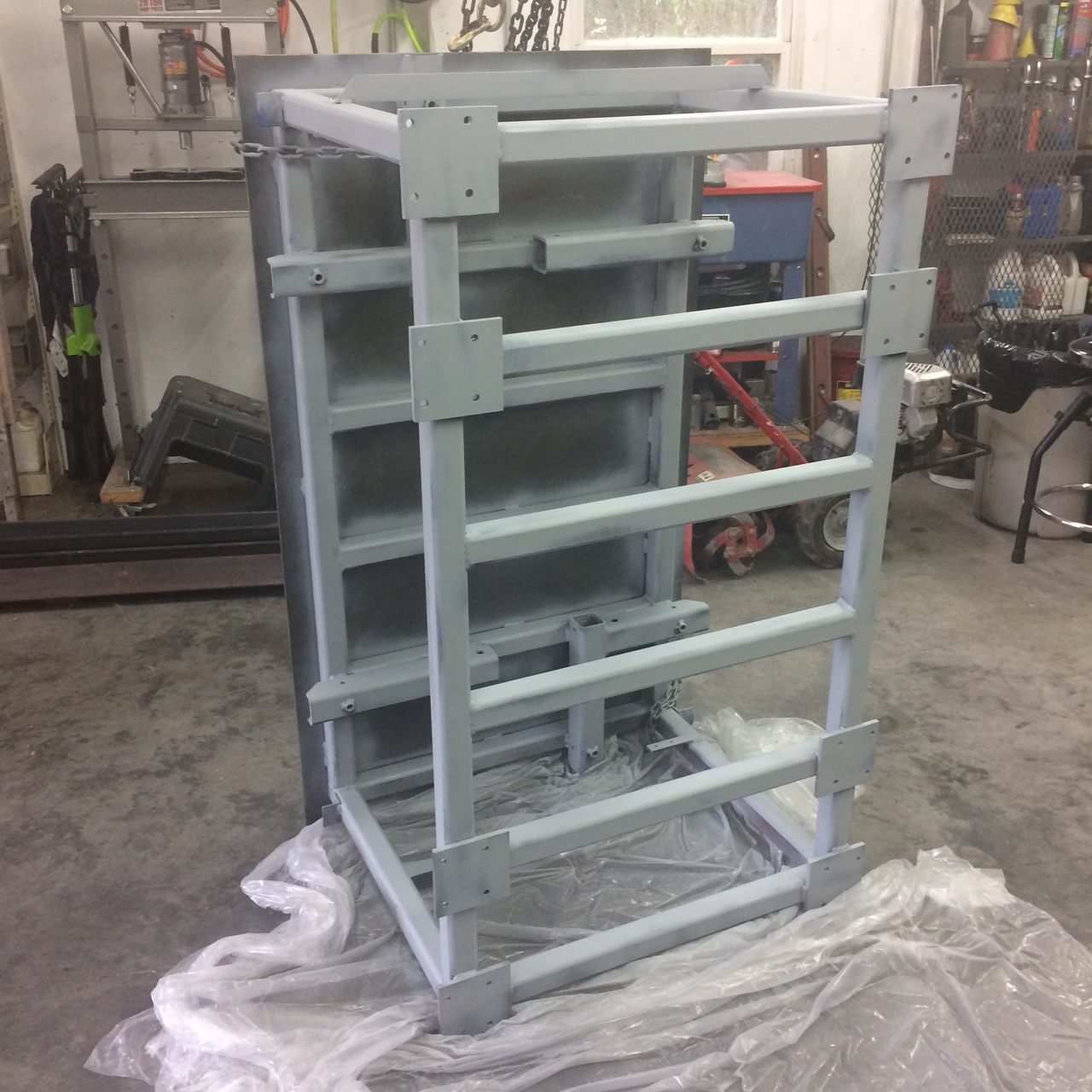

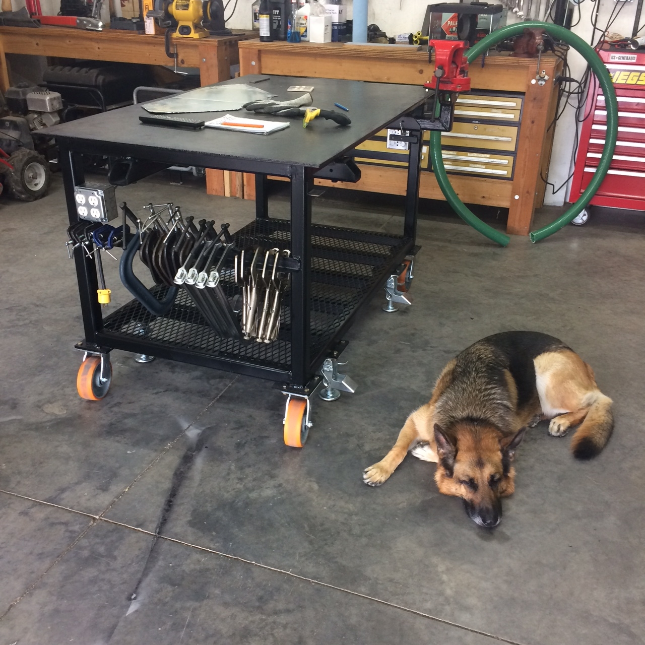

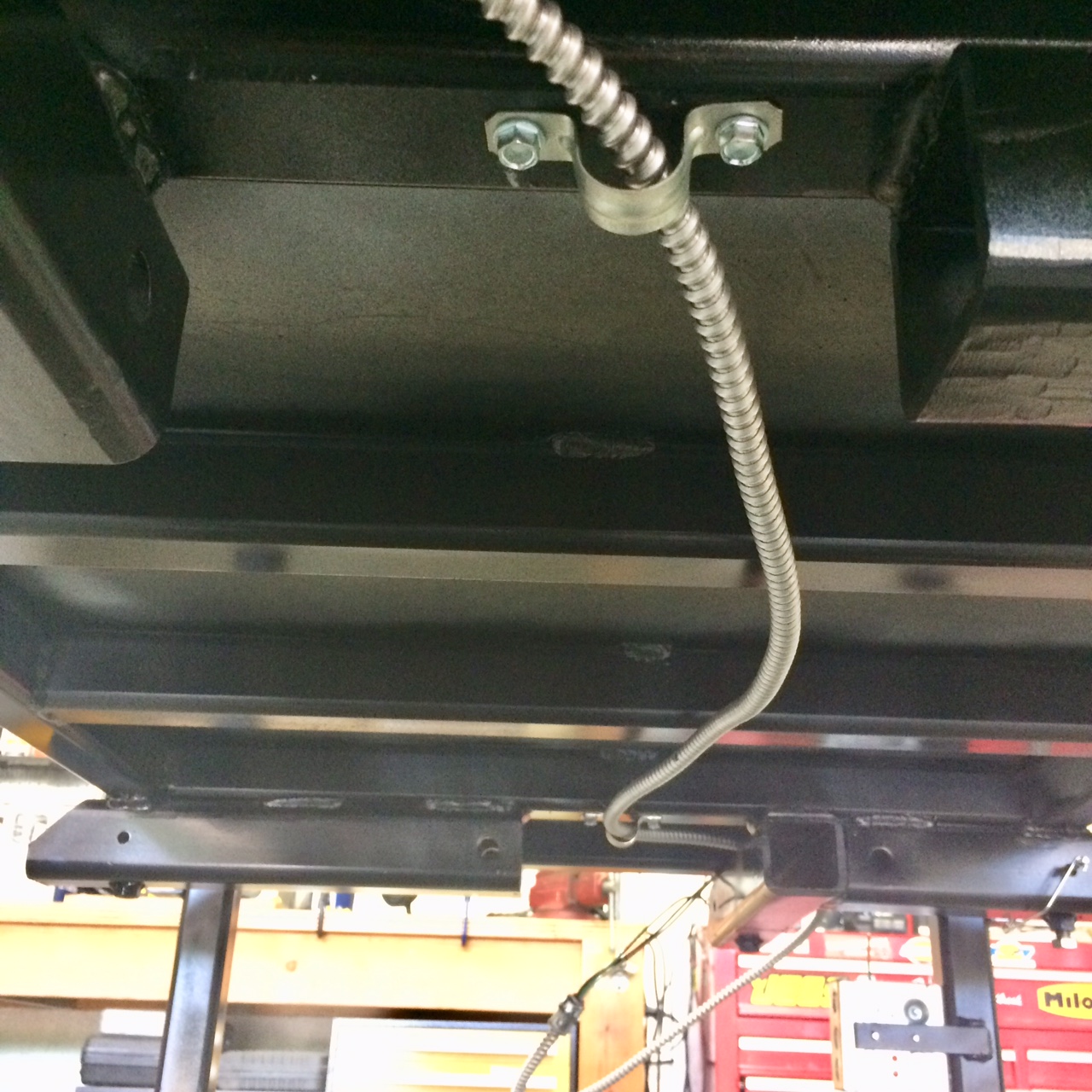

And it's done (part 2)
Spent a few evenings priming and painting, flip the table, rinse and repeat I got really sick of flipping that table!
After the painting I put the casters and floors locks back on. Then added the electric wiring - Done! Of course my shop supervisor was there every step of the way.
I have to thank TBN members: All the good ideas I incorporated into the table came from this forum! Any goofs, they were mine :laughing:

Very nice work! I like the last picture, after all that hard work it's time for a nap.

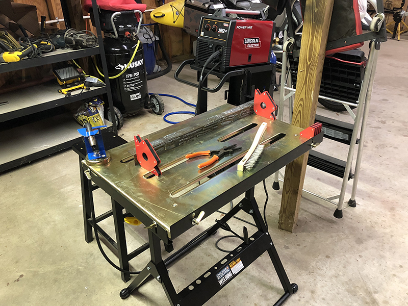

Here's mine. I'm a cheap bastard so I got this for 69 bucks new. Portable and stow-able.
