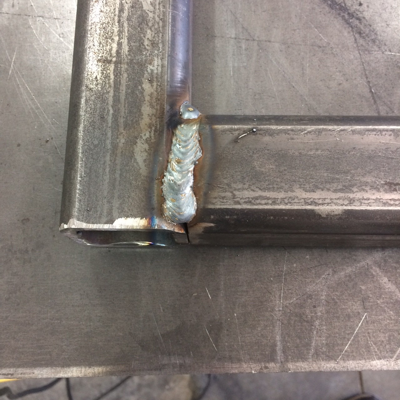

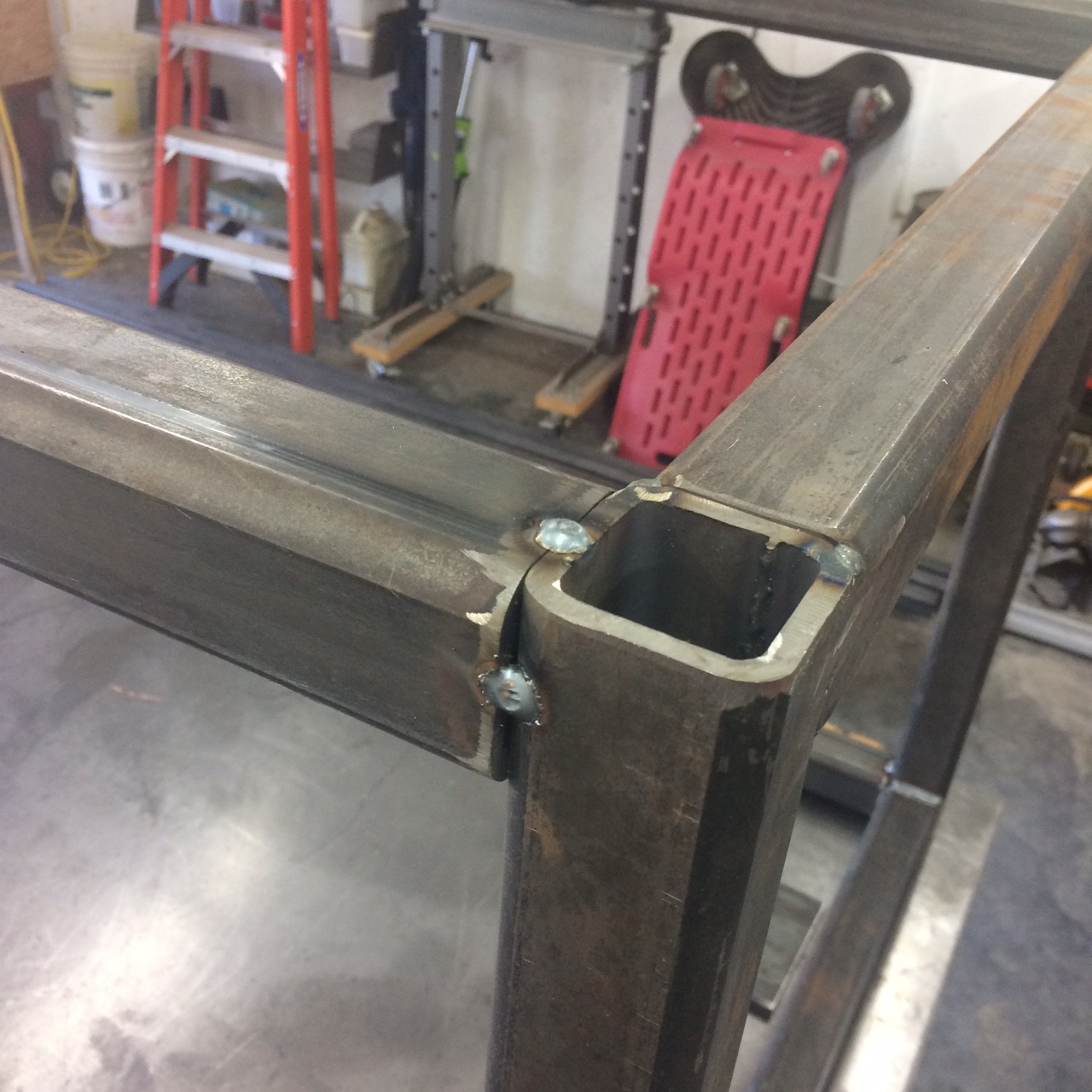

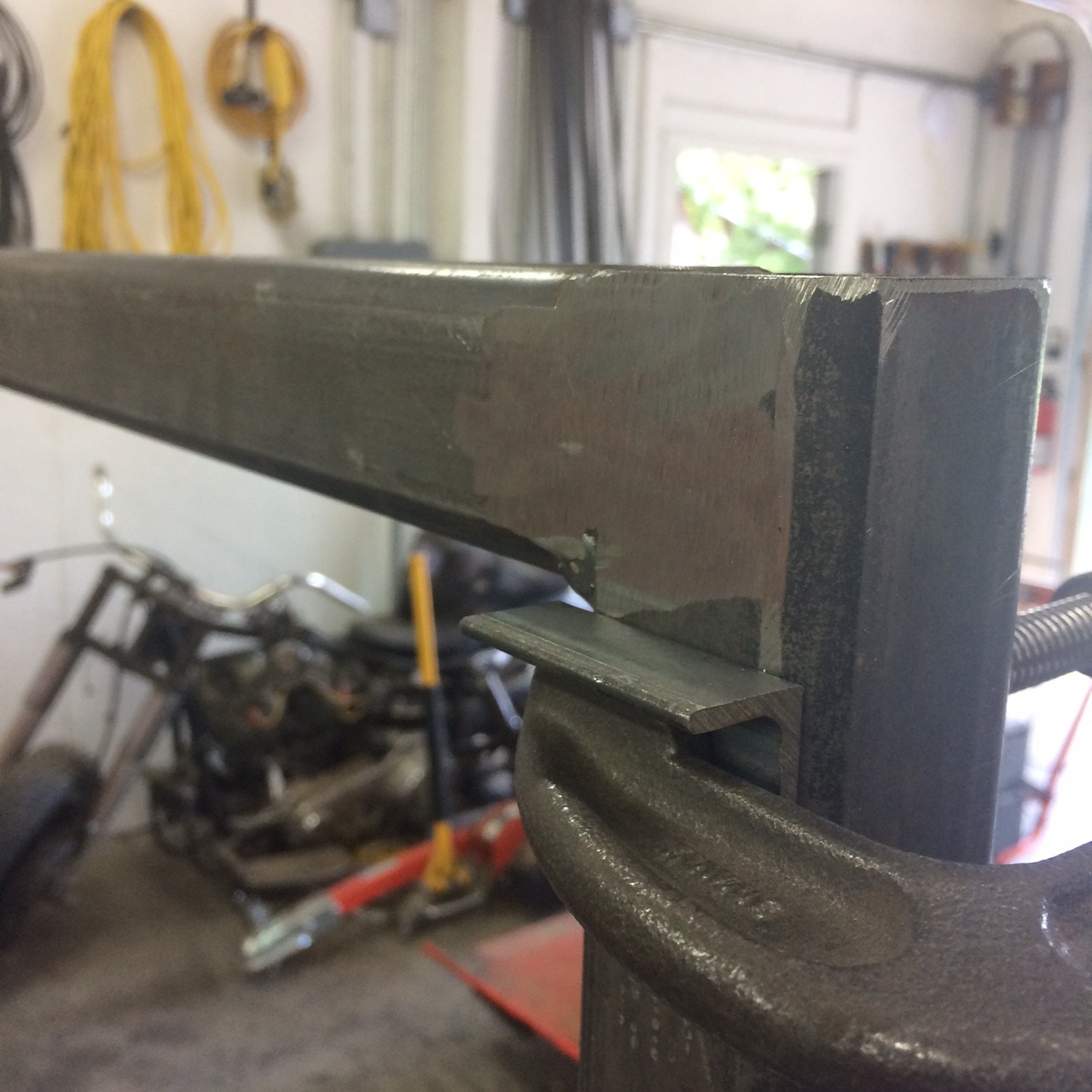

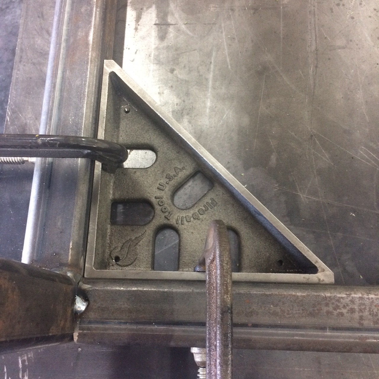

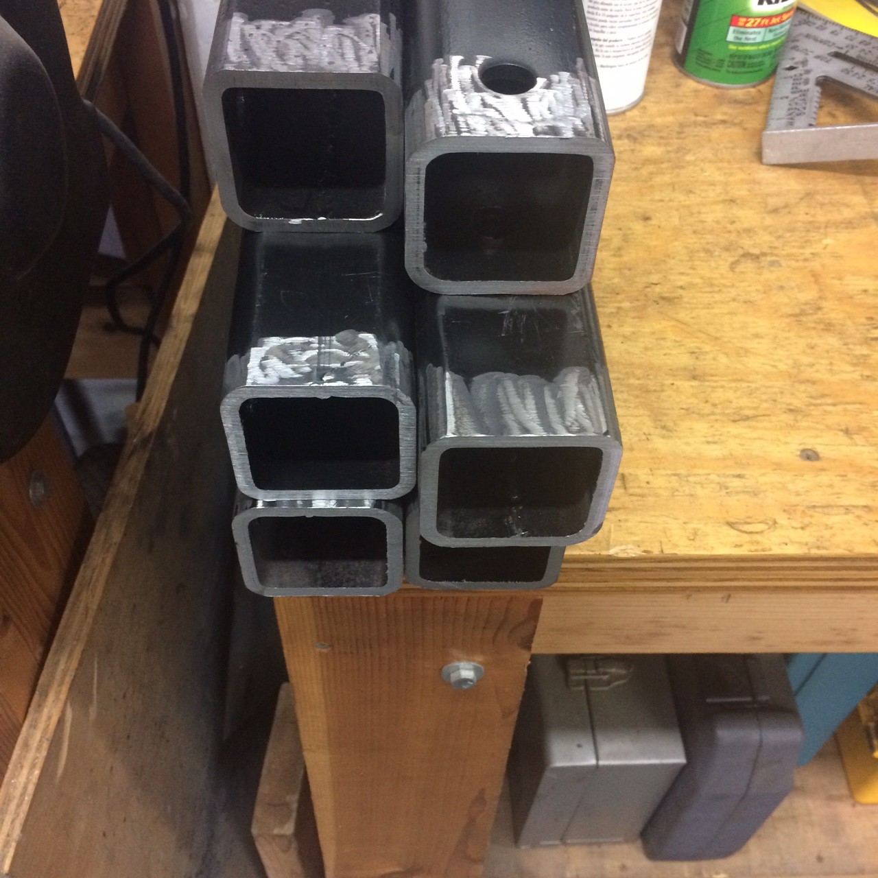

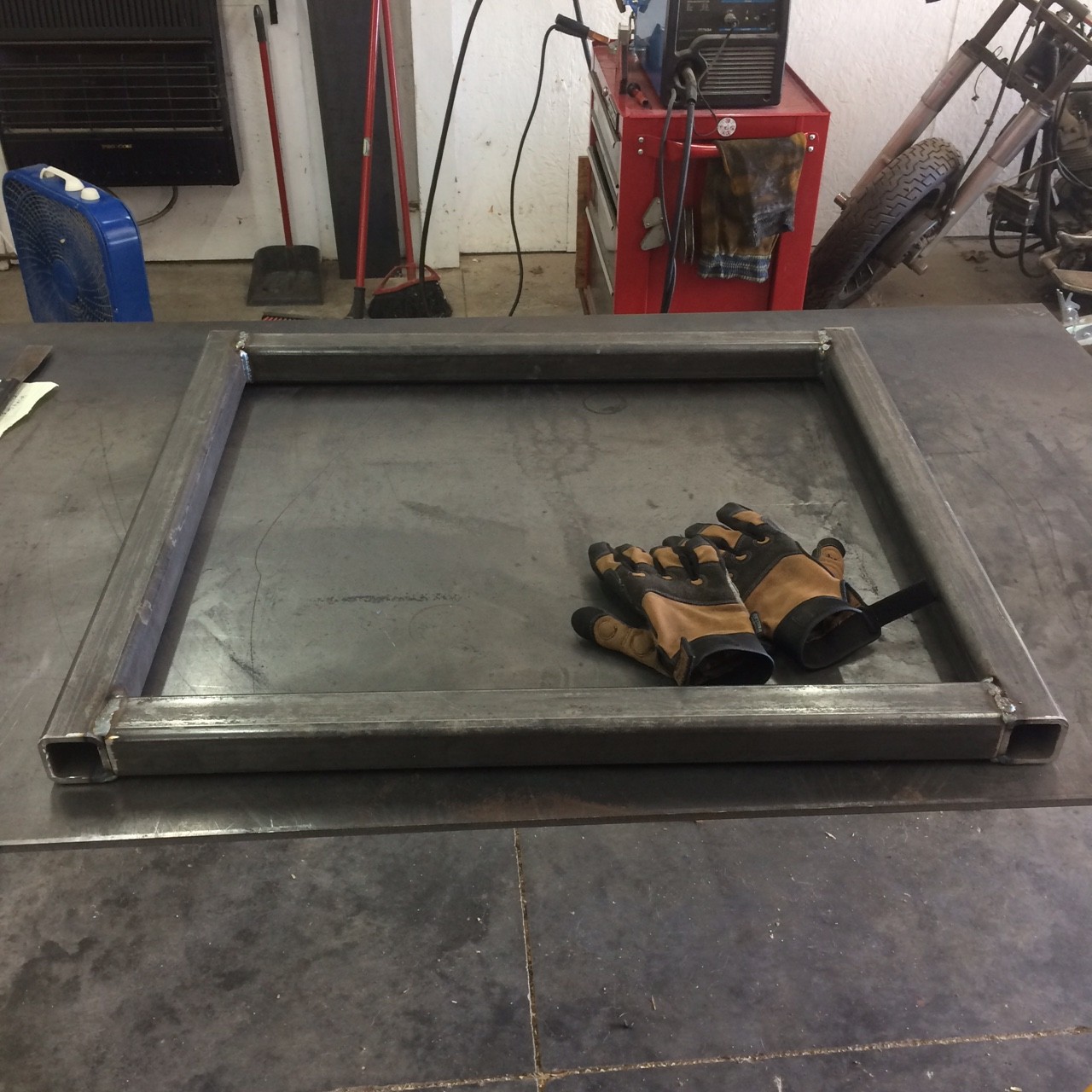

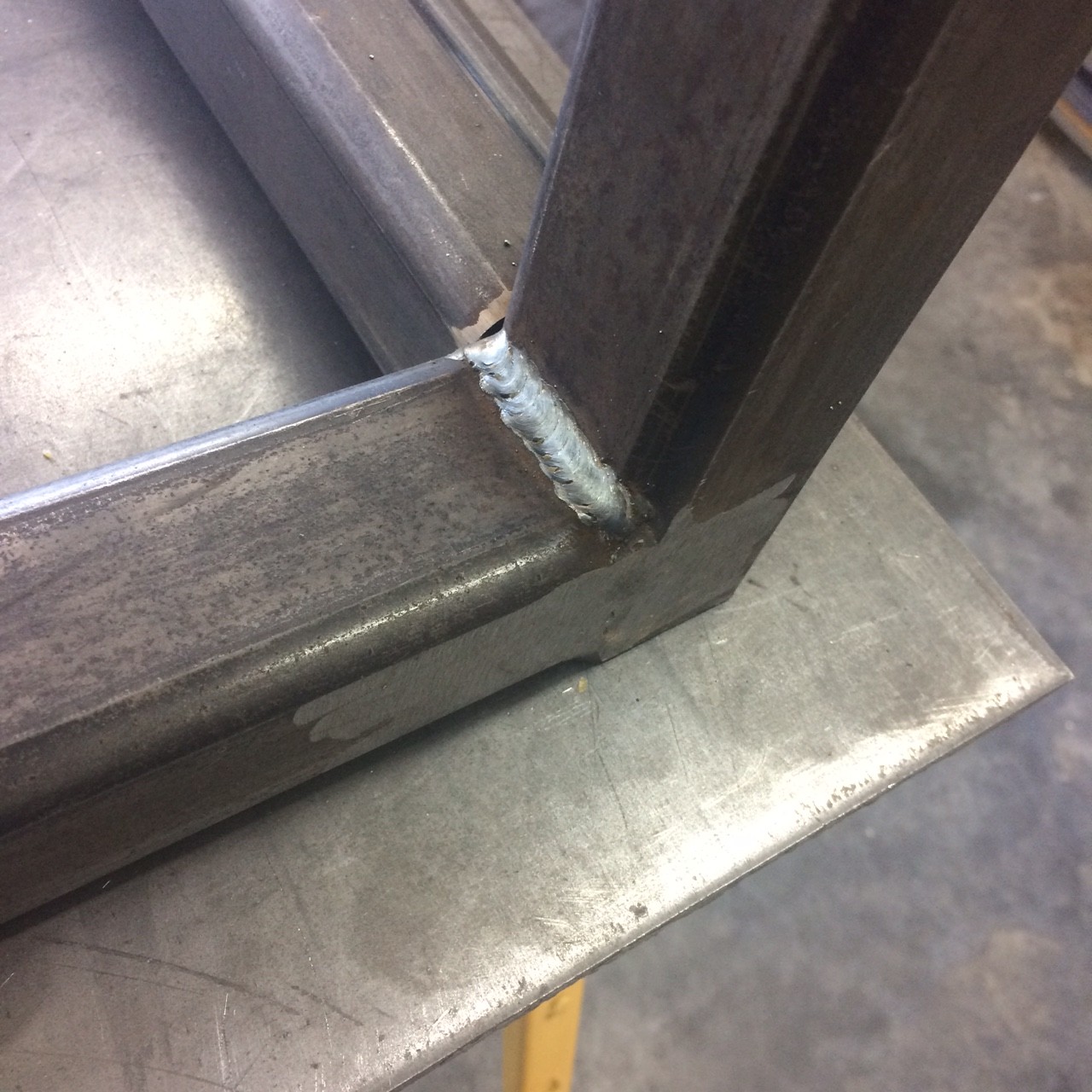

After a bunch of cutting pieces to length we had a couple weeks of life getting in the way. Weekend before last we started welding. I am going to break this up into 3 post so each post is not so pic heavy. Disclaimer: any welds you see that look good belong to my son, mine not so much, but I am learning! The square frame you see is one of the ends. It is 28 inches tall and 32 inches wide. Adding a 3/8 inch caster plate to the bottom, 7.5 of caster and a 3/8 top will put me right at 36 finished height. That will also leave a 2 overhang on all sides. I clamped short pieces of angle to the end pieces to alight and hold the 52 stretchers. The close up of the weld is my work yep, need more practice :)

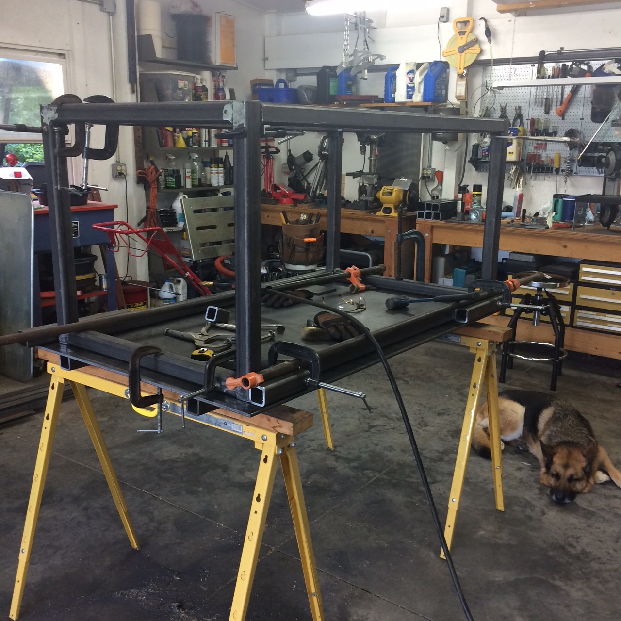

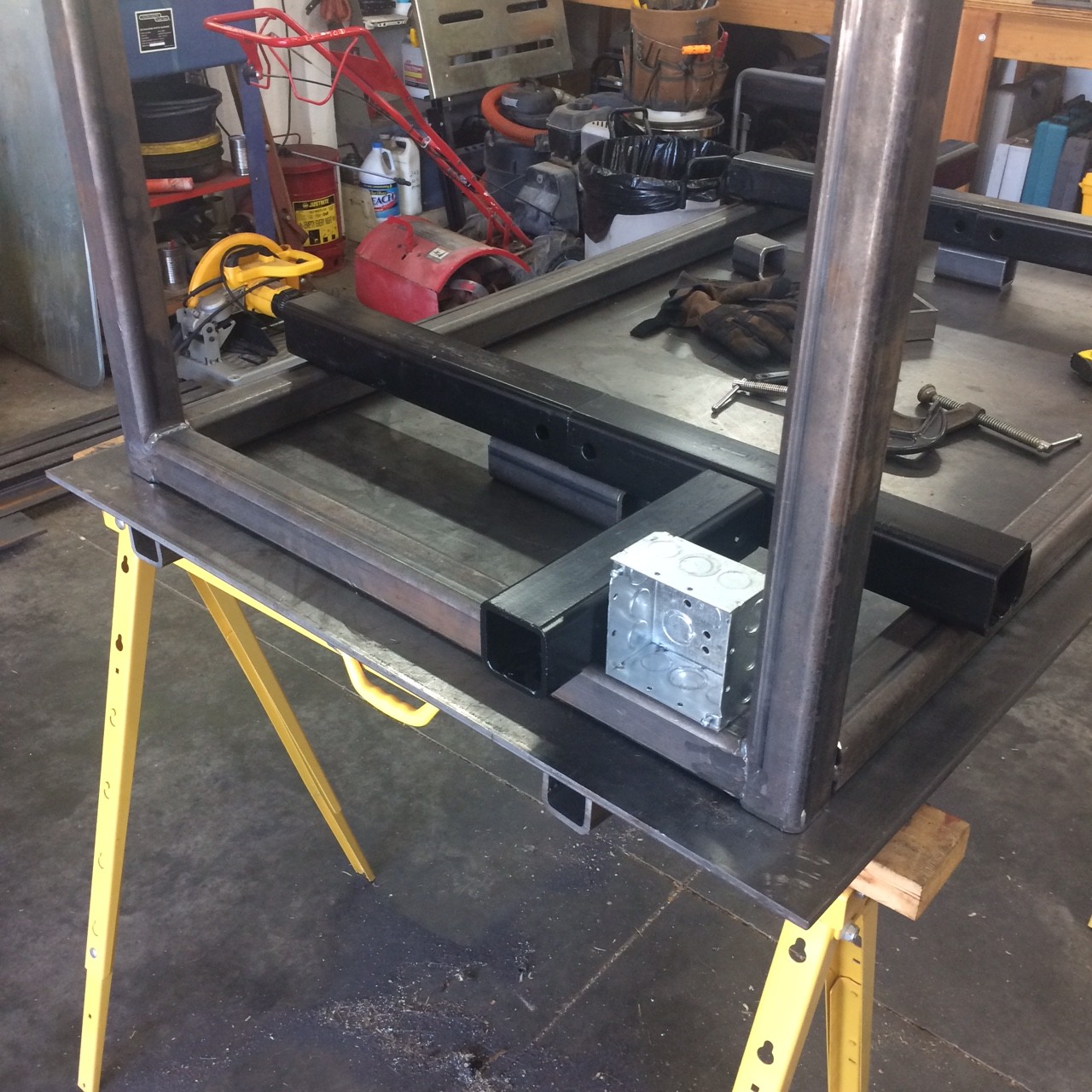

This group of pics shows the frame coming together. That really pretty weld you see, yep itç—´ my sons. I started mocking up where I want the received hitches. I think I have decided on what you see there - the other end of the bench the "end" receiver will be diagonal to the one in the pic. The 4 cross members (braces) you see are for the top, the bottom will have the same. I like this project, it is making me think outside my normal "make it with wood box". Of course shop dog (Bella) is helping.

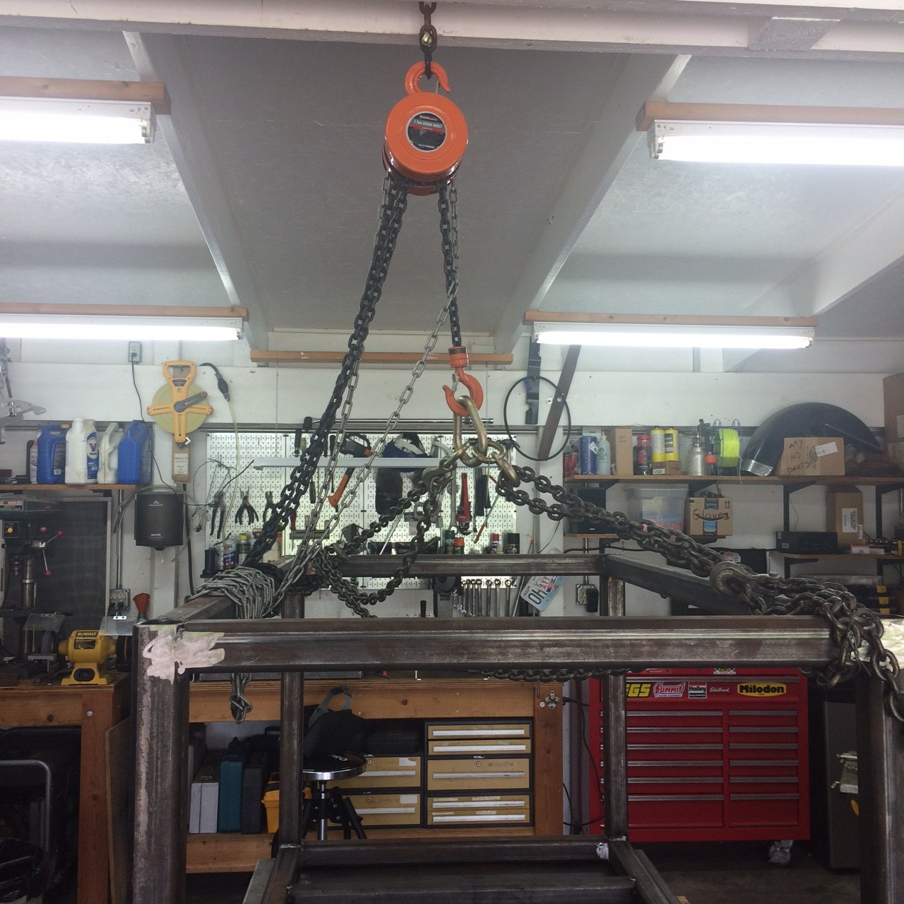

I admit it, I have an addiction... tools. I bought one of the fireball tool mini squares. Made clamping up corners easy. The more weight I added to the table, the more the saw horses would sway when you bumped it the hoist is my safety net.

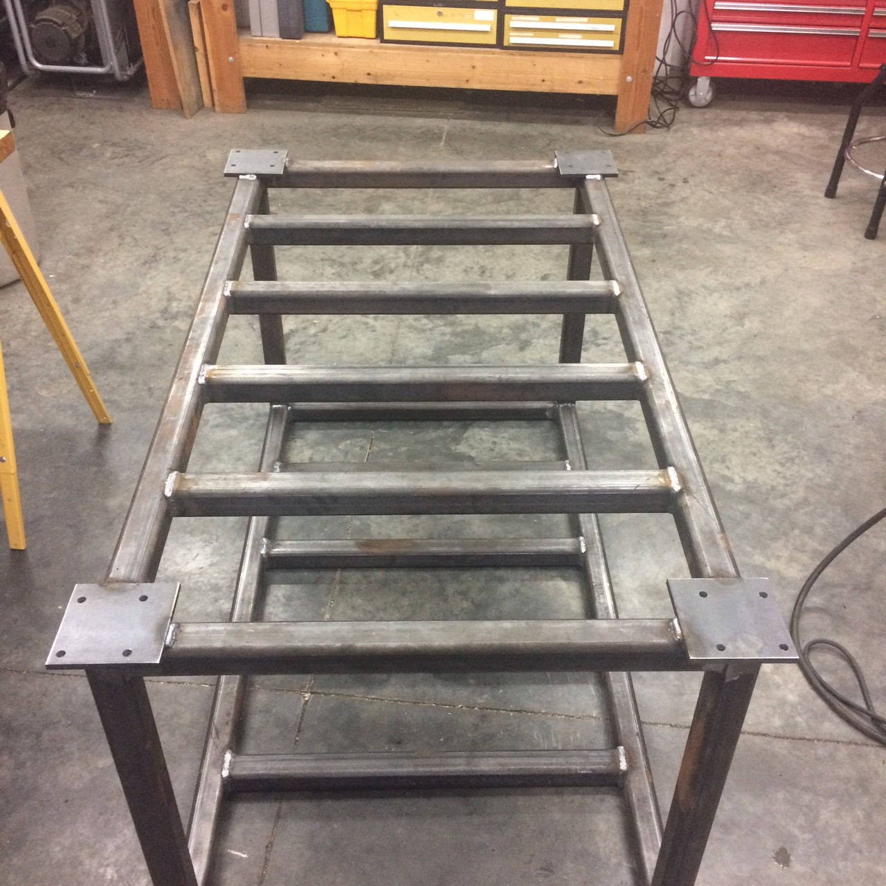

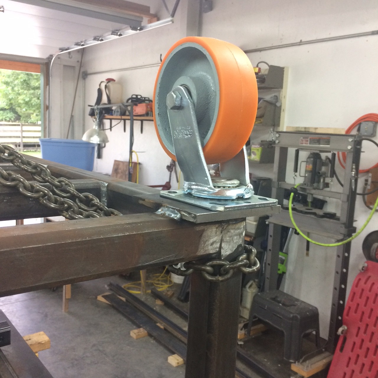

Last night we got the caster plates (5 x 5 x 3/8") welded on the bottom of the table. Then I cleaned up the ends of the receiver tubes for welding in the next couple days.
Next on the to do list: (1) Cut the end of the receiver tube to 45* to make inserting the 2 x 2 tube easier, (2) drill 9/16 holes in the receiver tubes and then (3) weld 1/2-13 nuts over them to clamp things in the receiver tubes.
I hope to have the table right side up this weekend!
