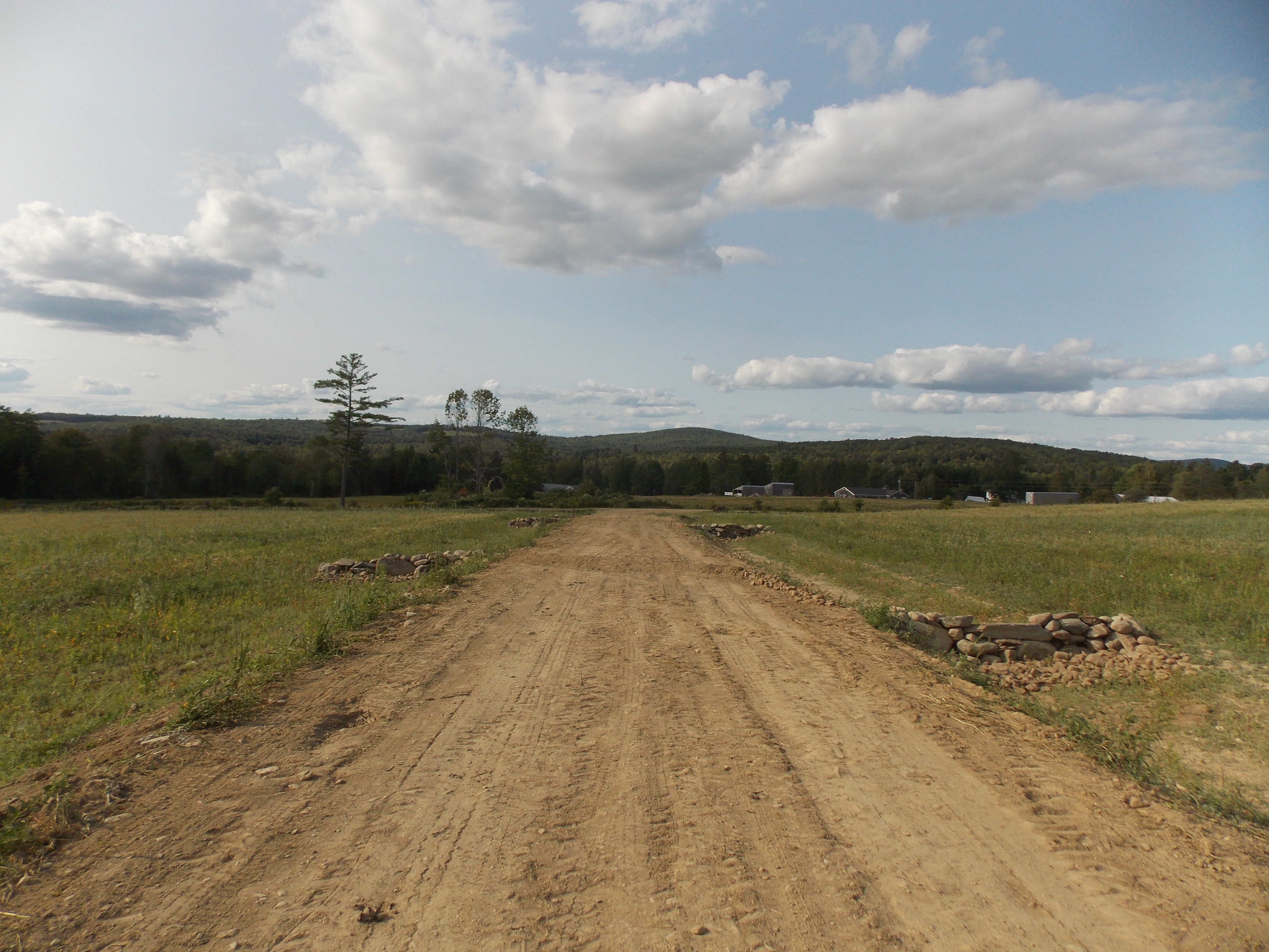

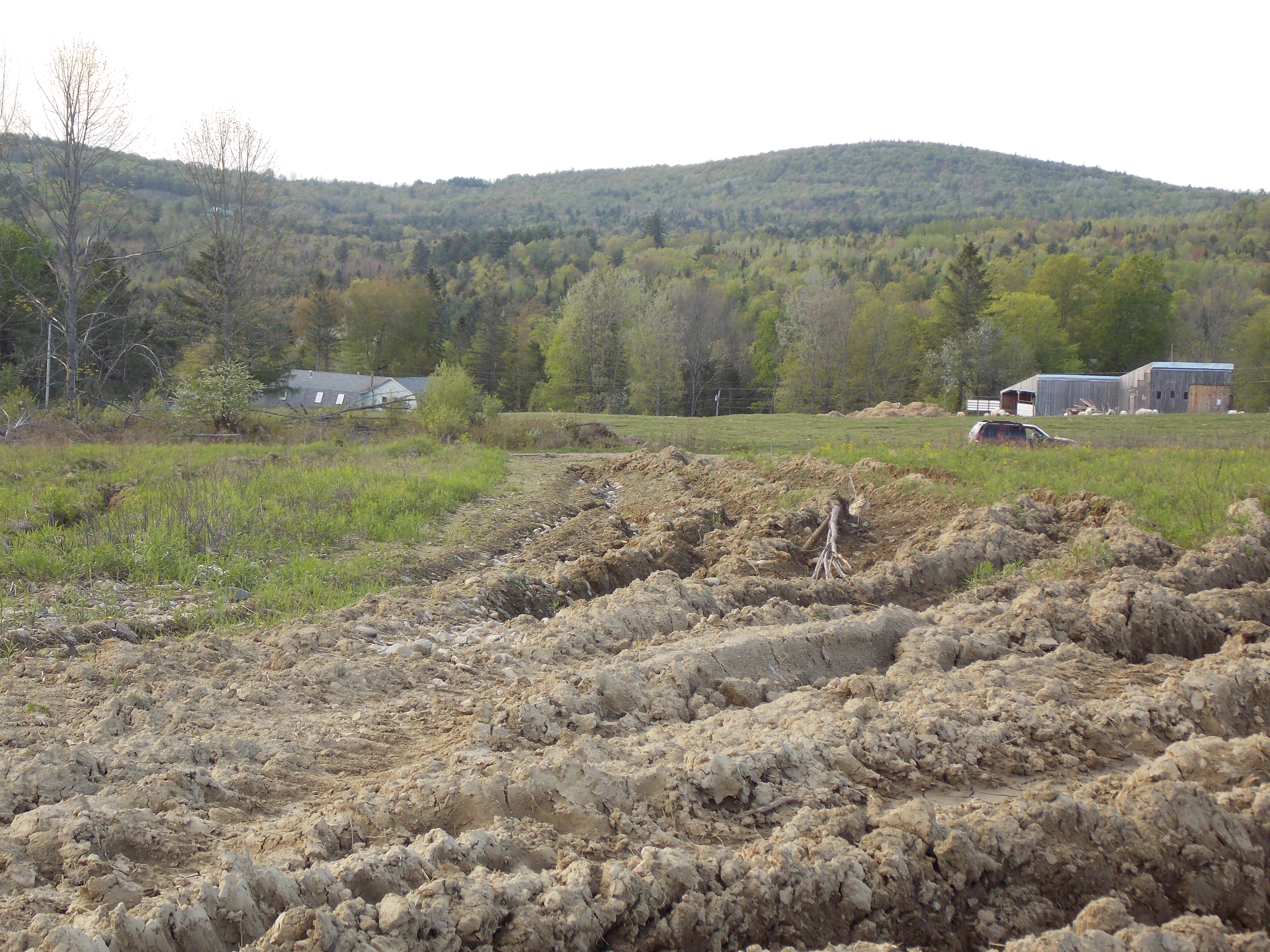

ANY road is an ongoing project...refine, refine, refine, but it is also immensely gratifying. It is also incredibly convenient. After years of extending a network of heavy haul logging roads outward from the main road, watching loaded logging trucks ply my roads always make me smile. It has also made my farm very productive and really reduced soil erosion. But that is just icing on the cake; gratification in a project comes from enjoying actually doing it, and not looking forward to it being complete.
here are two before and after photos taken last spring, then after my road was completed. The only thing I used was a Kubota 25 hp tractor, my Ford Explorer, and my log trailer. (My bulldozer was broken during the project with a busted transmission pump).

I had a quote of $7000 to do the work, but jeesh I had the gravel pit, I just had to haul the gravel 1/2 mile from the pit to the road. After a little while I realized my Ford Explorer could haul the gravel in my log trailer that comes with a dumpbox. It only holds 1 cubic yard of gravel, and at first it seemed impossible...1 cubic yard at a time...I needed 350 cubic yards just to surface it!!
But then again how does a person eat an elephant? One bite at a time.
My wife and I figured out that if we did 10 loads per day, in 35 days we would have the road done. Suddenly it was doable. She hauled the gravel with the dumpbox behind her Ford Explorer, while I was down in the gravel pit loading the trailer with my tractor. She did one side of the road first, then the other side. Every 10-20 loads she would come and get me, and I would drive up the hill and level out what she had dumped. One day we hauled in 60 loads, and another day only 5, but it still got done within a month's time: and at first it seemed impossible.
After that we built water bars (required because this was a Federal erosion control project), then the rock check dams. It all turned out well. No $7000 spent, just some fuel...

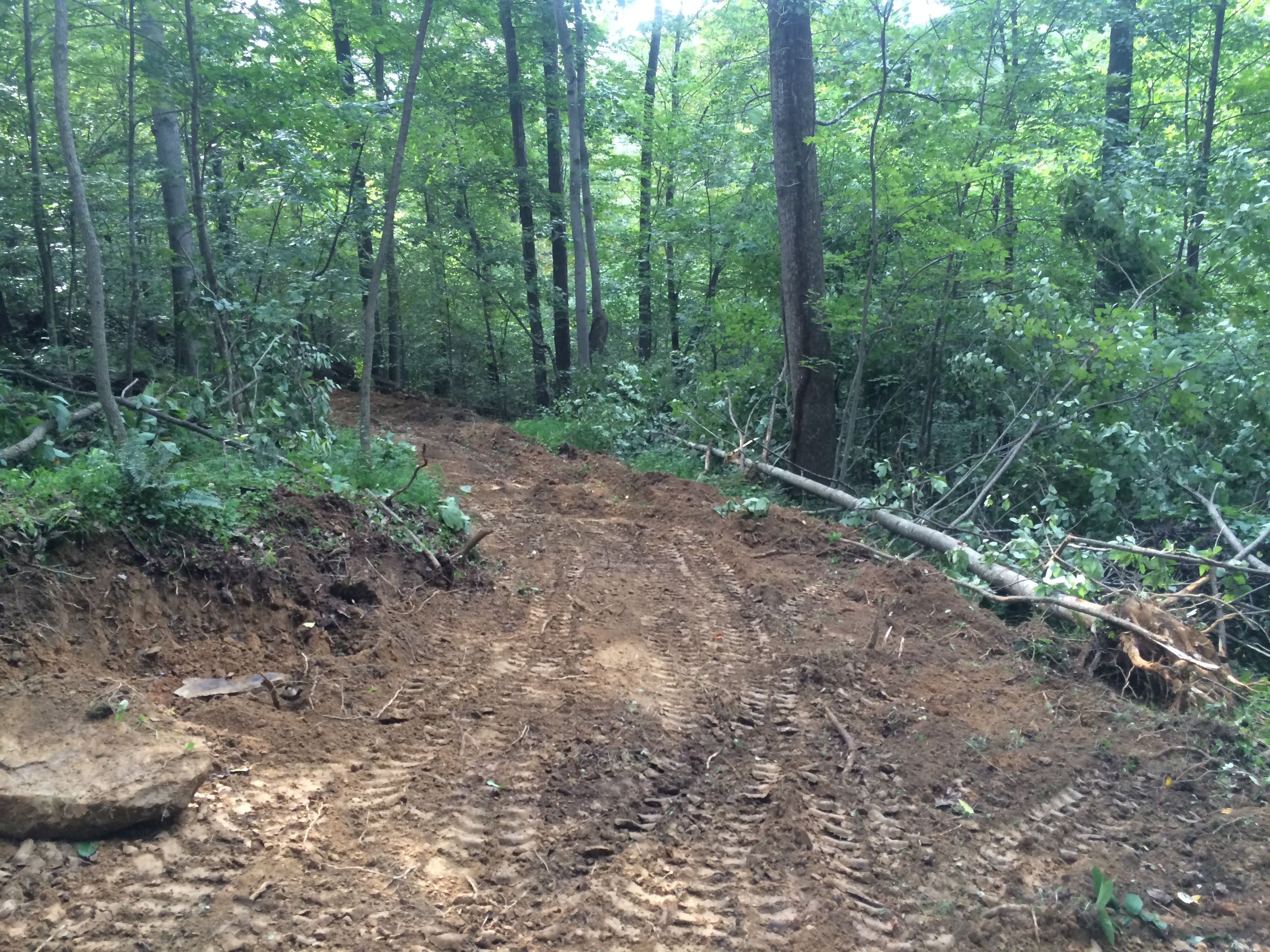

I have a slightly different approach. Go rent a mini Ex and knock it out. Should be an easy 8 hr job and you have the tractor to final grade and finish everything off. Around here a mini ex is $200 for 8-10 hrs (depends on who you get it from, some give you an extra 2 hrs on the "8hr" weekend rental.)
I have a mini ex and wanted to run a road down over the hill from the house. It it very close to your steepest section. I knocked this in after work before dark one night - maybe 3- 3.5 hrs max.
